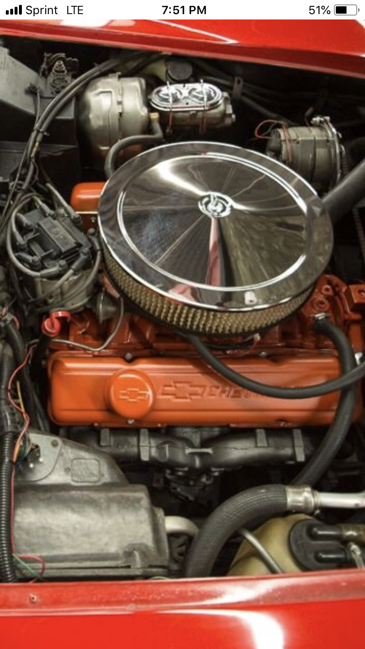

Hello all, I’ve been on the lookout for a rubber bumper C3, and the same as when I bought my C5 Z06, I’m a stickler for stock, or at the most can easily be retuned to stock (any performance mods and I keep looking). Anyway, very new to the C3 world, and going to look at this ‘77 this week, supposed 30,000 original miles. I’ve attached two engine pics and am asking for thoughts - in my research it appears the L48 valve covers were blue, not orange. Do it has me wondering what else may have been changed. Any thoughts or opinions would be greatly appreciated!! Jeff

Changeover from orange to blue was in the '77 year so could be an early '77 but those valve covers don't look original anyway but I could be wrong. Missing the ignition shielding, AIR system, and air intake of course.

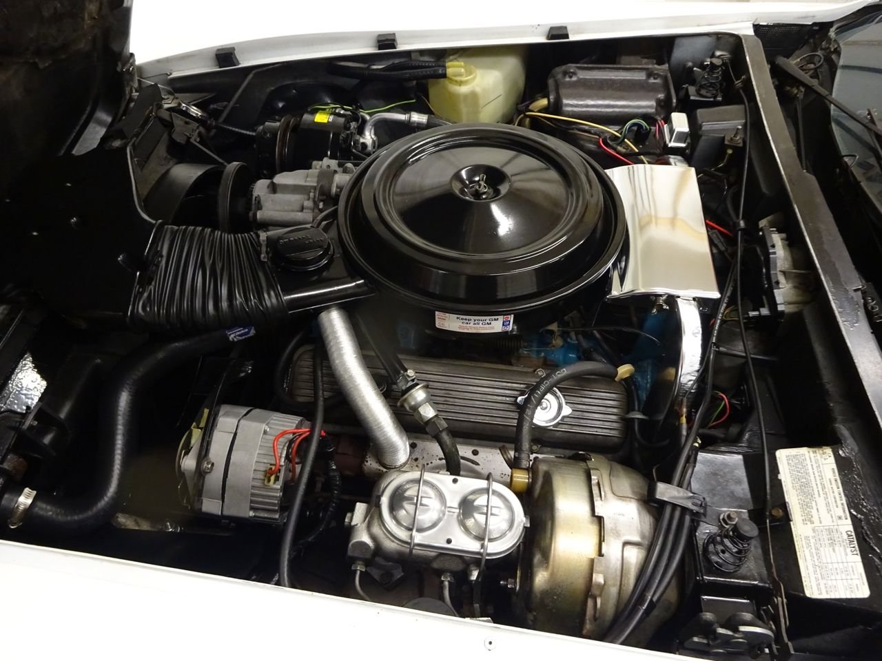

Here's pretty much what it should look like (in blue), minus the L82 valve covers.

My 77 L48 automatic did not come stock with an air pump system (AIR). Judging by the dip stick, the one in the OP's picture is an automatic, so no air pump needed to be original.

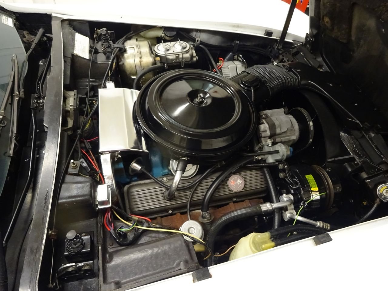

The original engine compartment of a 1977 L48 would have appeared very similar to the pictures in post #3. I owned a stock '77 Corvette for 15 years. I liked it. Thank you, revitup.
The differences between the '77 L82 shown and an L48 would be...
The L48 would have had painted steel valve covers, but not the valve covers in the first post above, which are not factory.
The L48 would probably not have had a smog pump, unless it was delivered to California or a high altitude region.
Very early 1977 cars (Aug-Sep 1976) had engines painted orange, like previous model years. The remainder of '77 production left the factory with blue engines, per Corvette Black Book, 2011.
were the l82 intakes painted or natural aluminum?
In 1977, all intake manifolds (L82 & L48) were cast iron and painted engine color. Chevrolet went to an aluminum intake manifold, not painted engine color, on the L82 engines starting in 1978.
I hope this helps.
