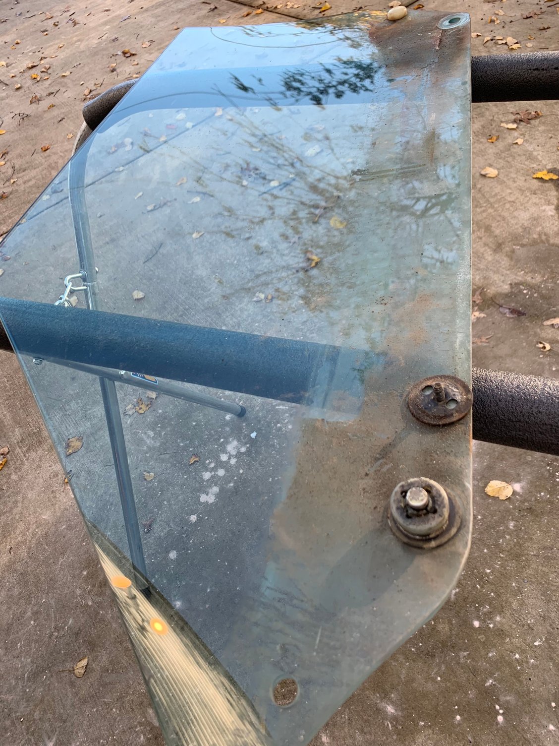

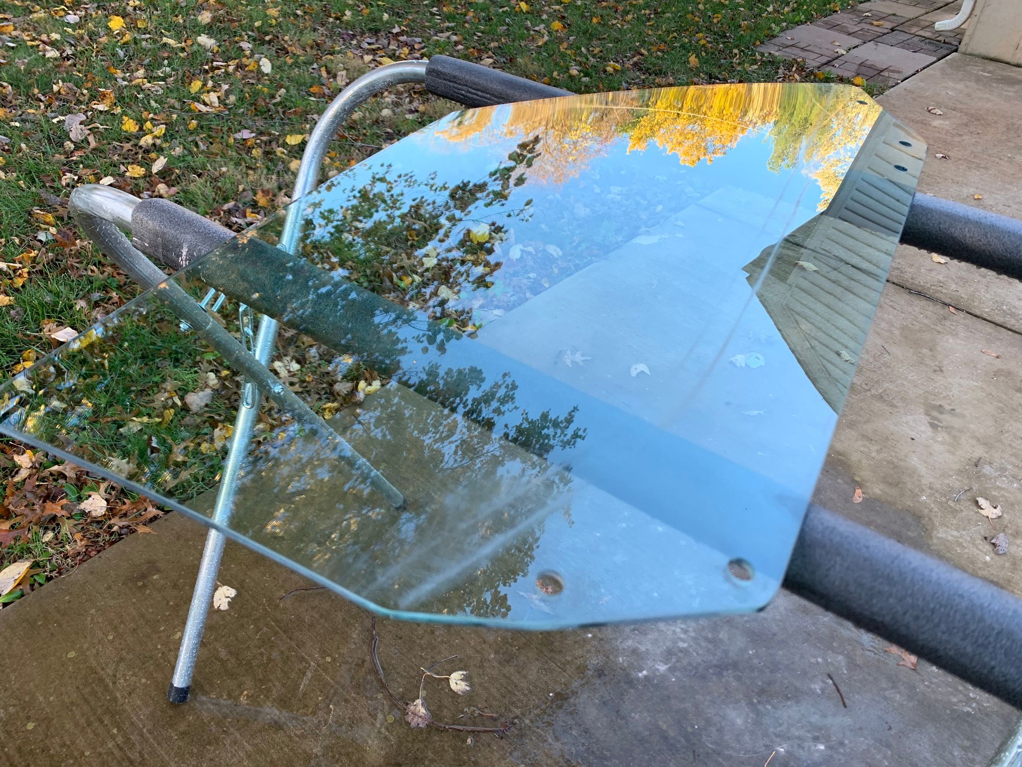

Window scratch removal vs new windows. I cleaned and polished one window. Way better but there are hundreds of scratches in it. What do you guys think?

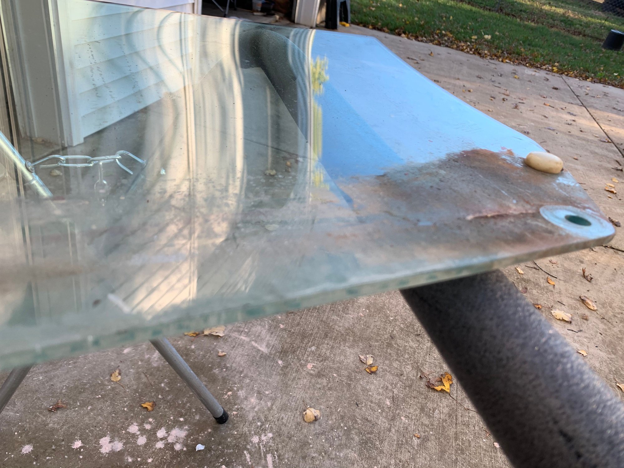

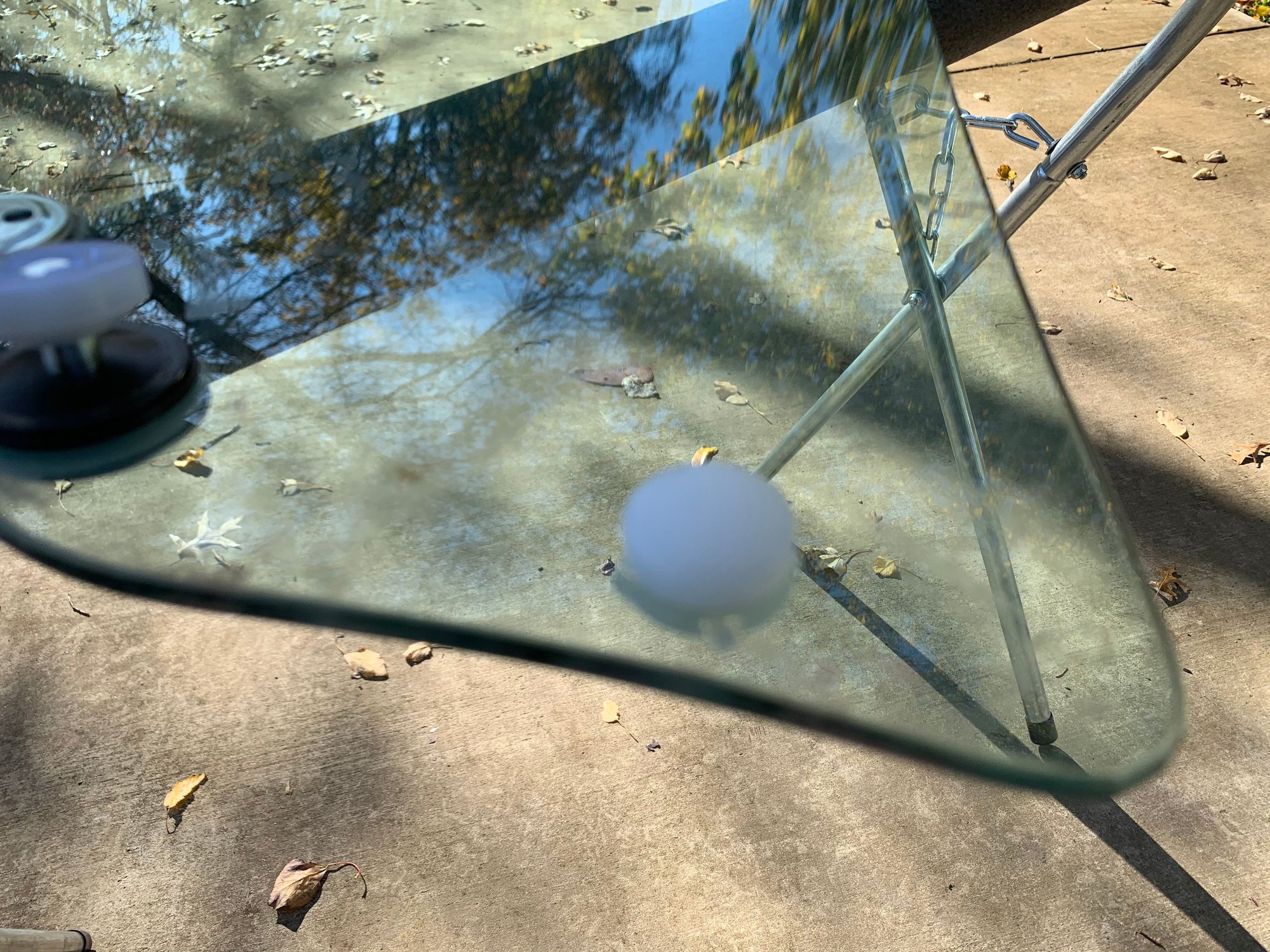

after using cerium
oxide and 45 min of work.

  • $318 per side tinted with no date code from ecklers. That’s $640 plus they overcharge for shipping. Will likely be $750. Ugg

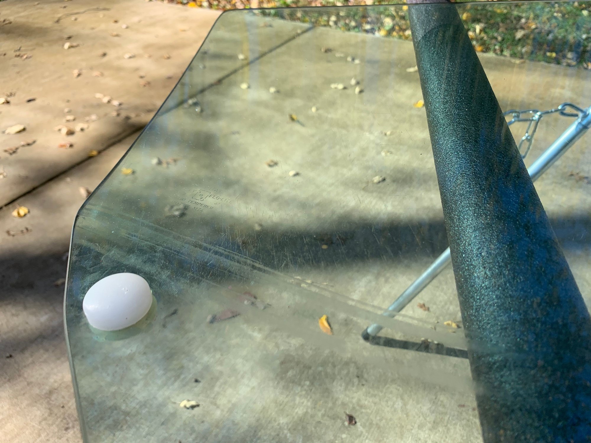

That looks pretty bad in the sunlight. Is that white puck the polishing agent? Supposedly if your fingernail catches it can't be removed, otherwise with a buffing wheel and rouge or something like that you've got a shot at it. Worth a try.
Eastwood perhaps?

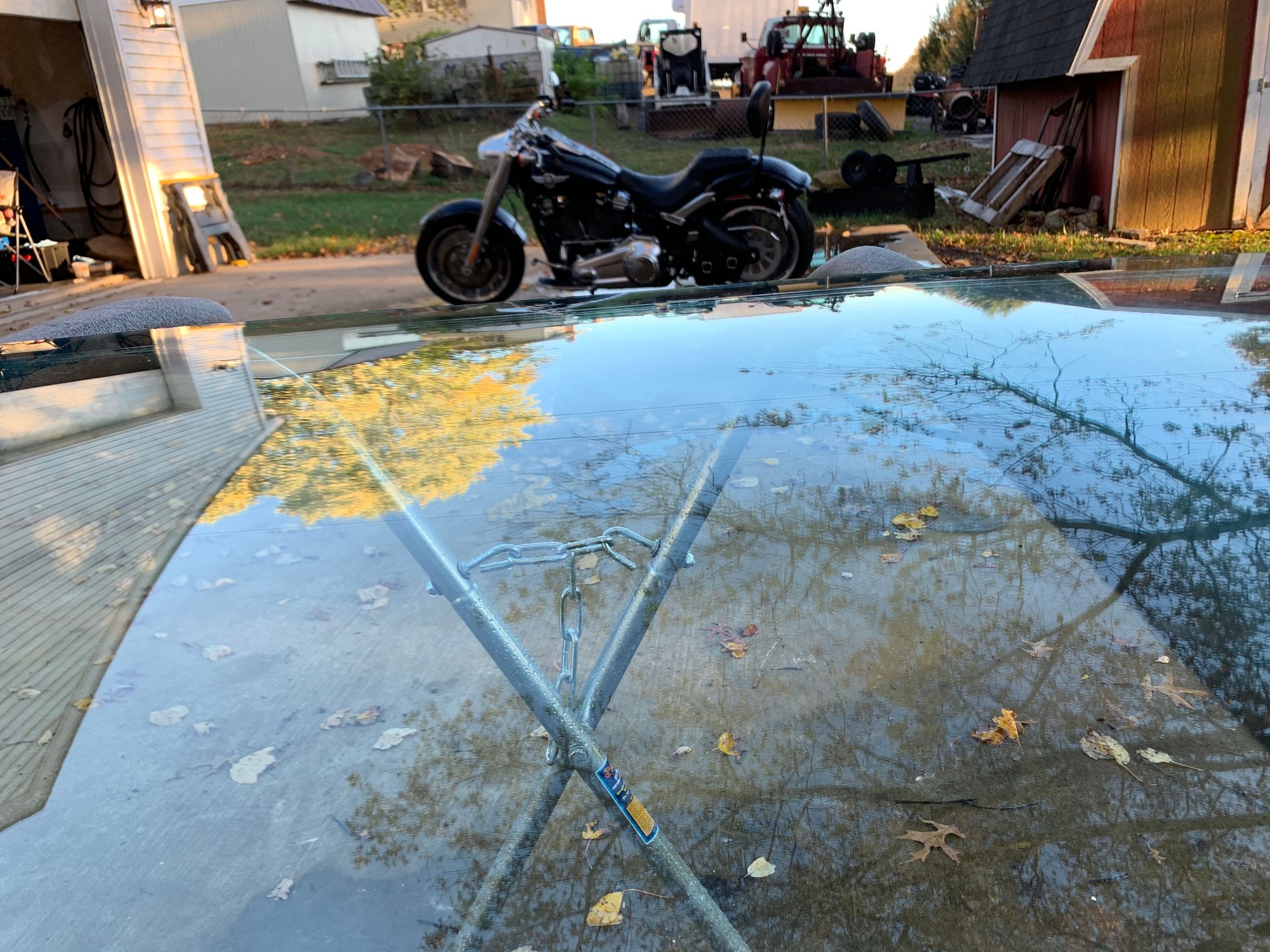

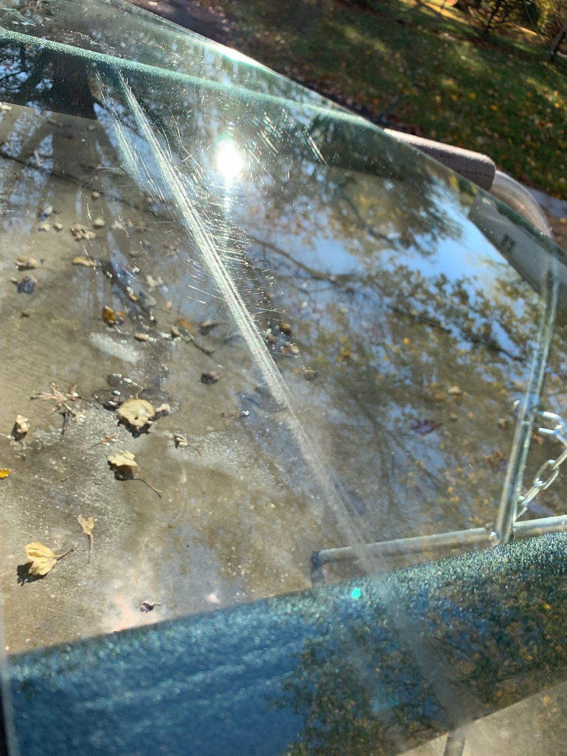

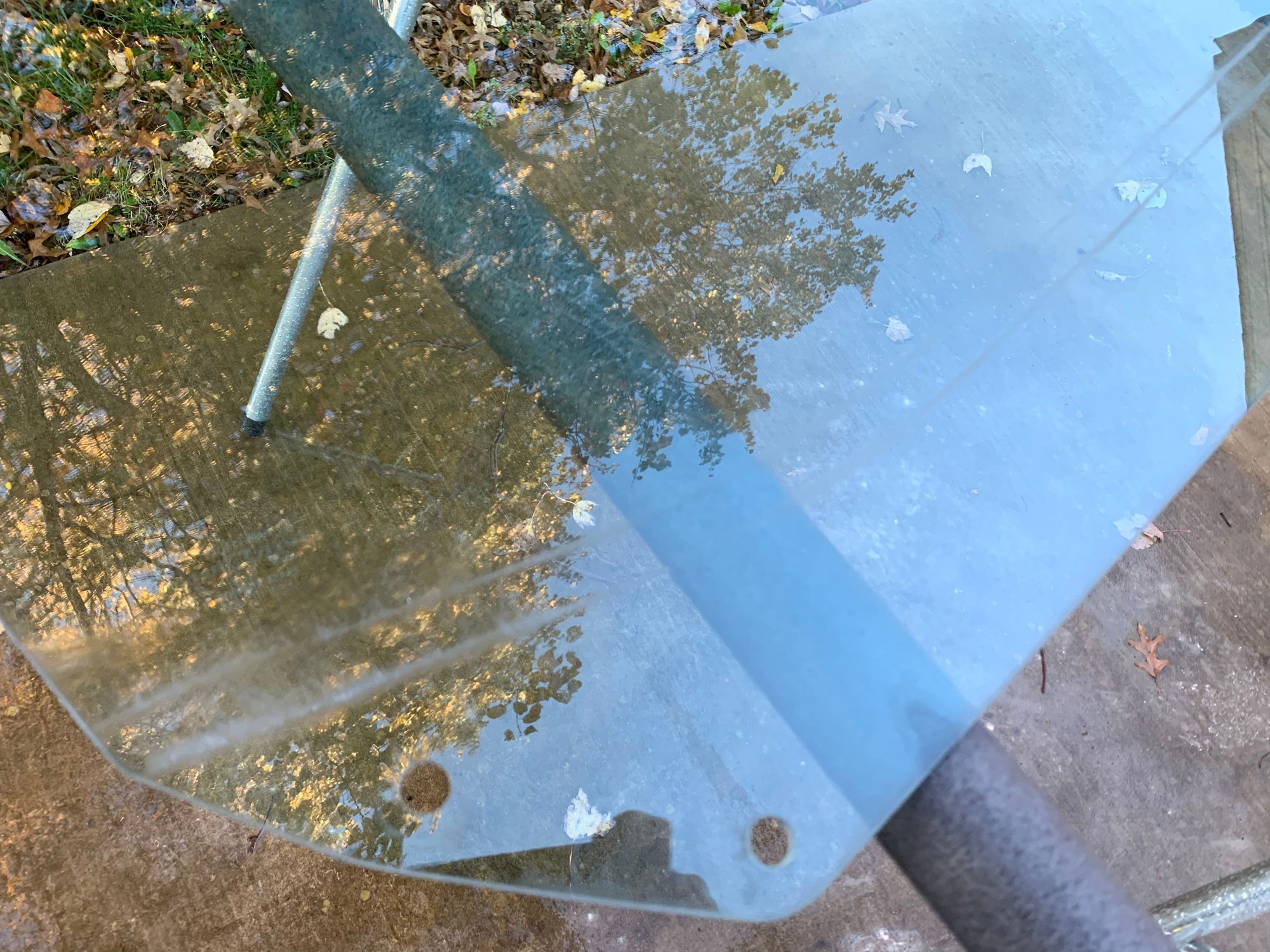

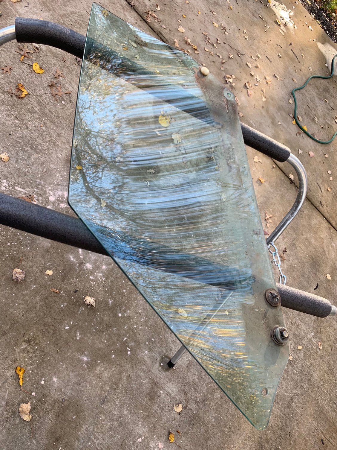

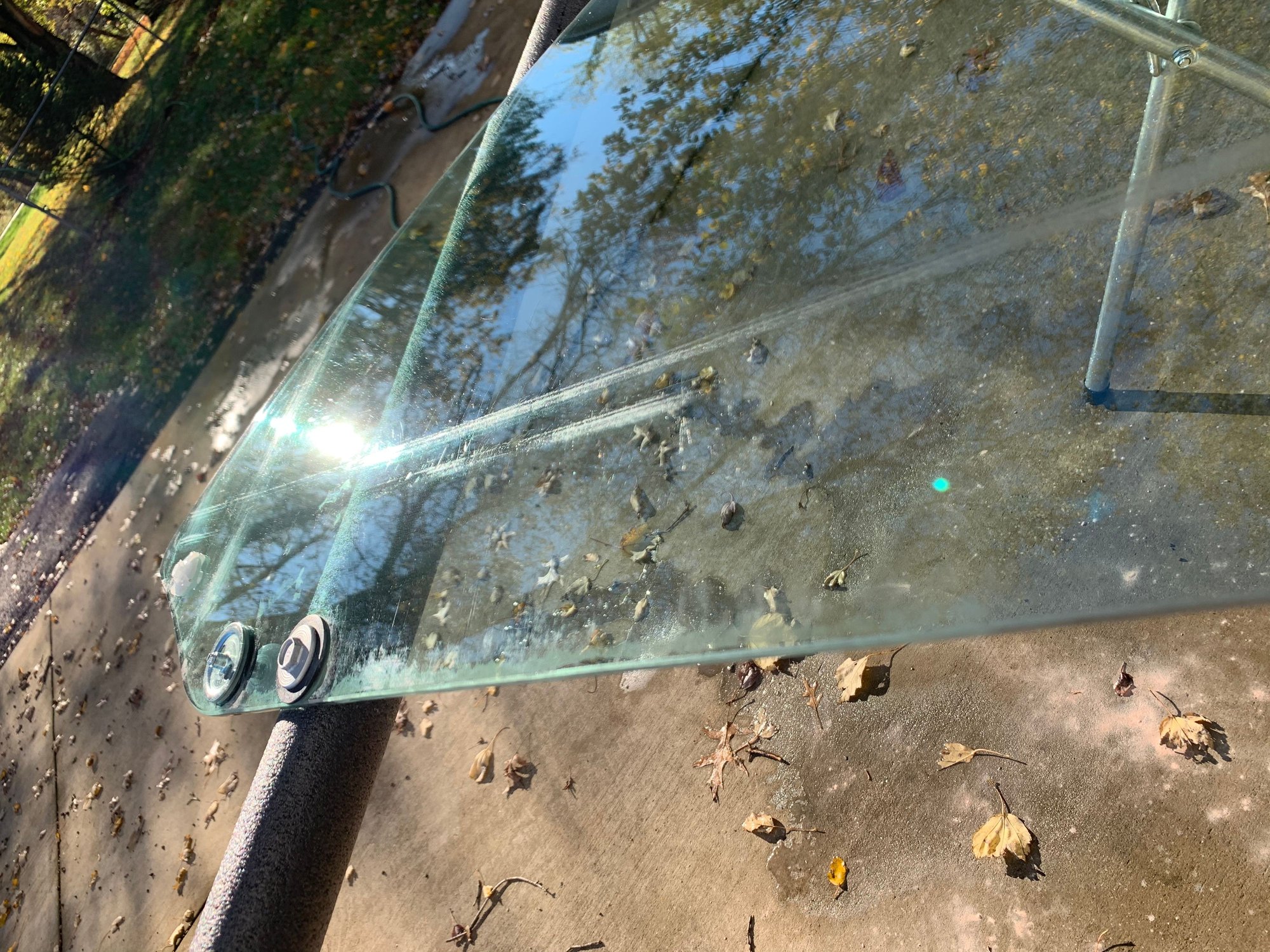

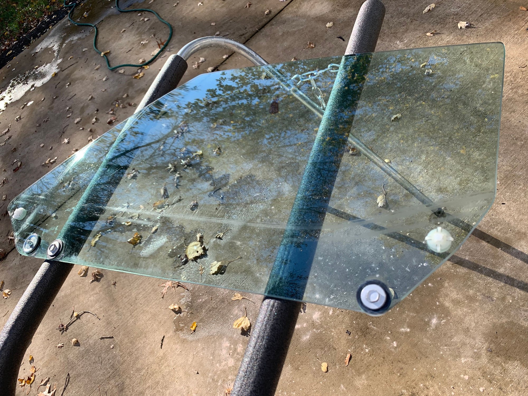

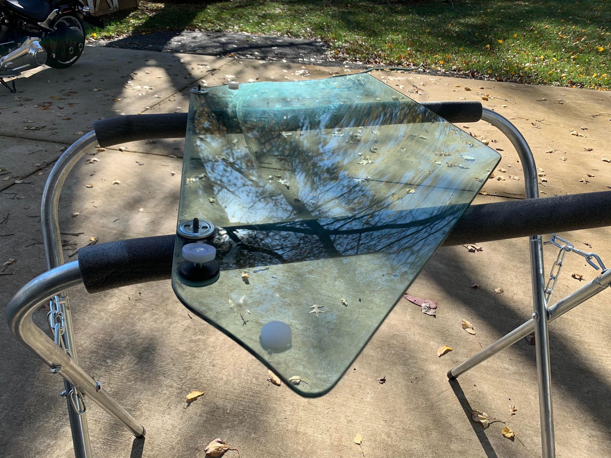

Right side window. Looks worse now that the grime isn’t covering up the scratches, lol
Before
Before
Before
After
After
After

I used cerium oxide paste on both windows. Tons or time and still hundreds of scratches going vertical. Hard to see them in the 2nd set of pics. The horizontal line is where the felts were I think? Can’t feel anything with my fingernail but they won’t come out.
these windows were bad when I bought it and I drove it as was for several years probably putting more scratches in. Much of the window hardware was a mess. Bumpers missing, bolts missing etc. can’t believe they still worked at all. Everything will be brand new EXCEPT the windows if I do t replace them. It’s now or never though. I never want to deal with these doors again. Leaning toward buying the windows...
