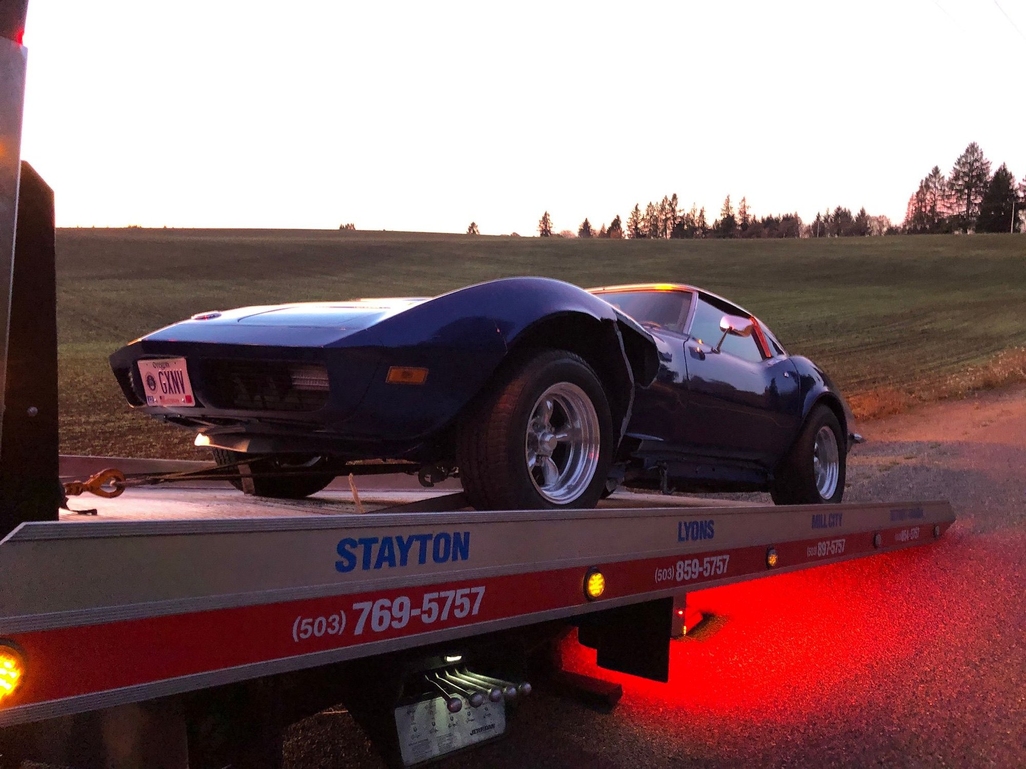

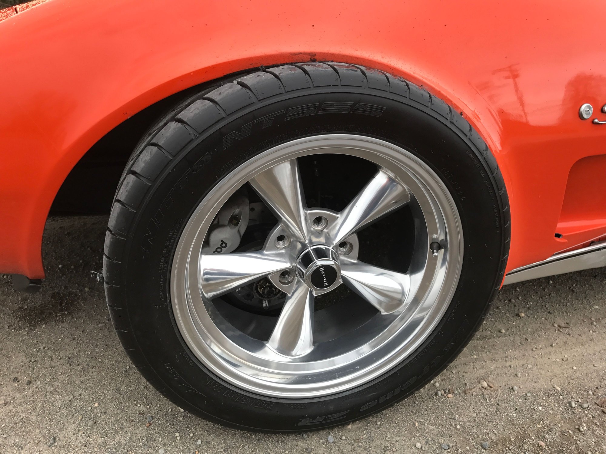

Finally finished the restoration of my 1973. Well, almost since I don’t have the horn working yet. I have a new relay but hadn’t got to it. New 383 stroker and tons of time assembling from rolling project, paint, interior, engine rebuild and just put 383 stoker in with 450 hp using original numbers matching block. And then... a wheel came off while driving 30 mph on a country road. No warning. No shimmying. No vibrations. Just felt like hitting a pothole, then noticed wheel rolling in parallel beside for a moment before my attention diverted to bringing to safe stop. Found the wheel over hill and over dale. Retrieved hazarding a barbed wire fence and being chased by two llamas. Found two studs broken off cleanly and one with damaged threads. Two seemed normal and was able to get two “borrowed” lug nuts on to replace tire for flat bed tow. Bummed and discouraged!

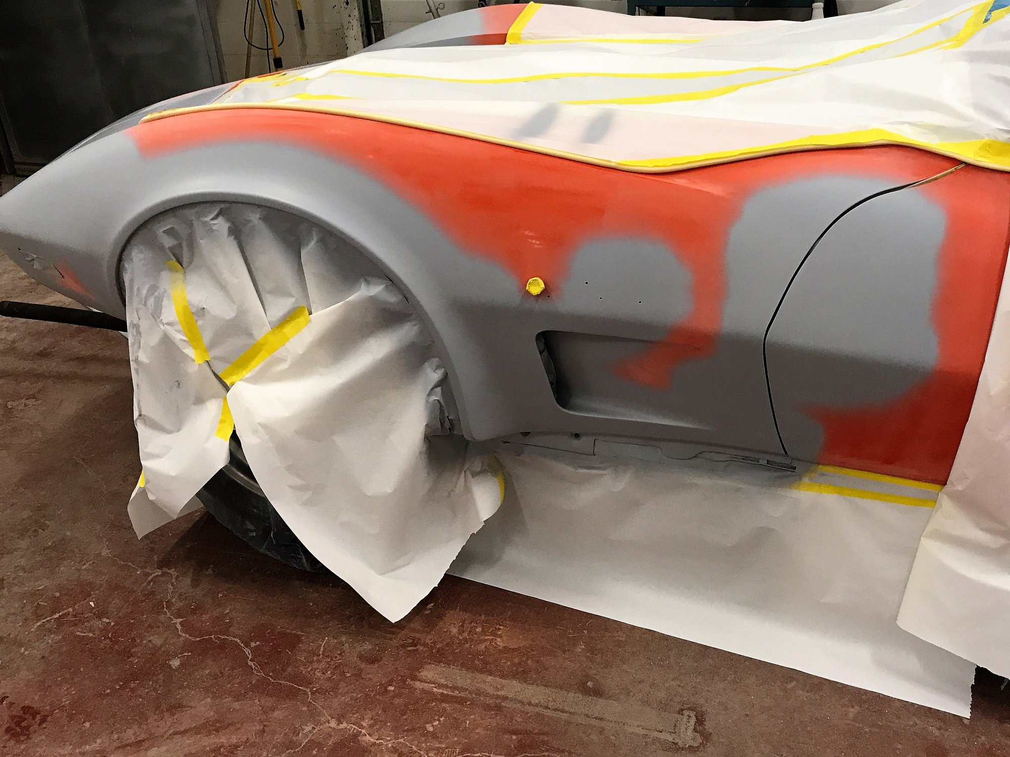

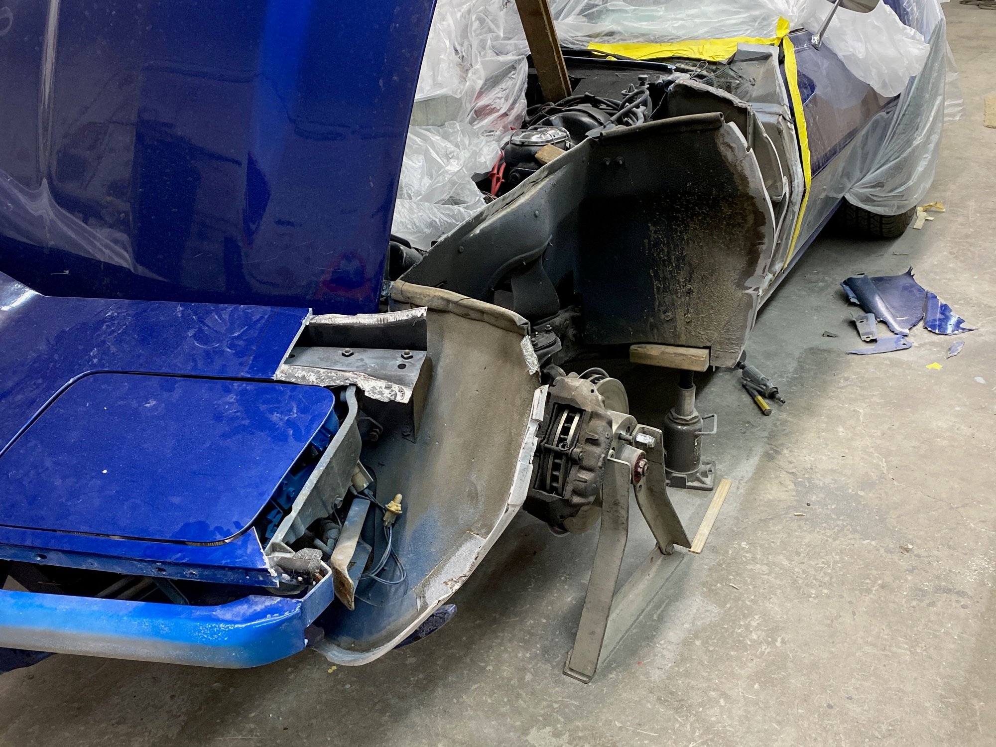

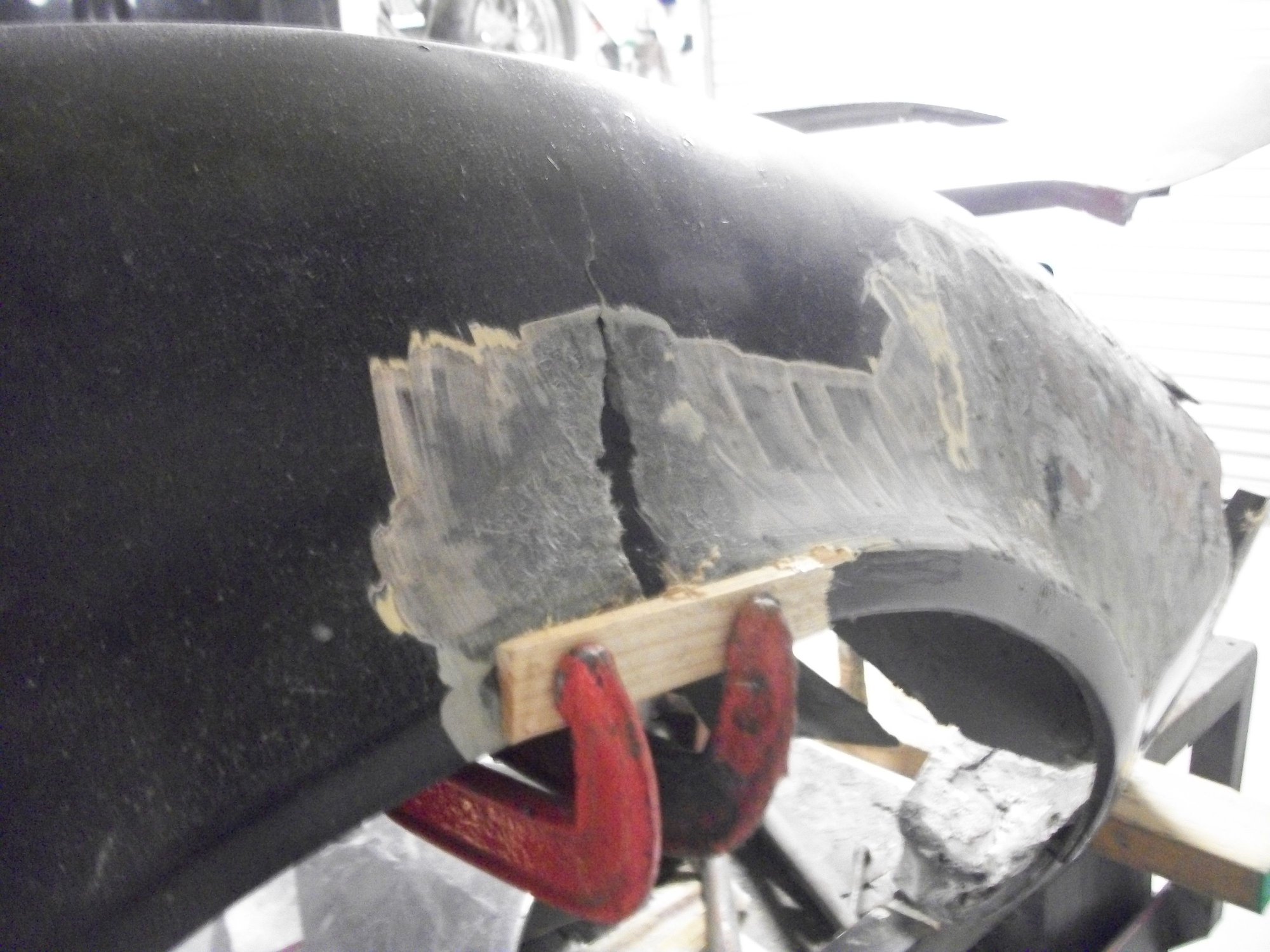

After having considerable difficulty finding a body shop to do the work and several rounds with the insurance adjuster who it seemed wanted to total my car, I finally have progress to report.
Has to be made worse before it can be better.
There is hope!

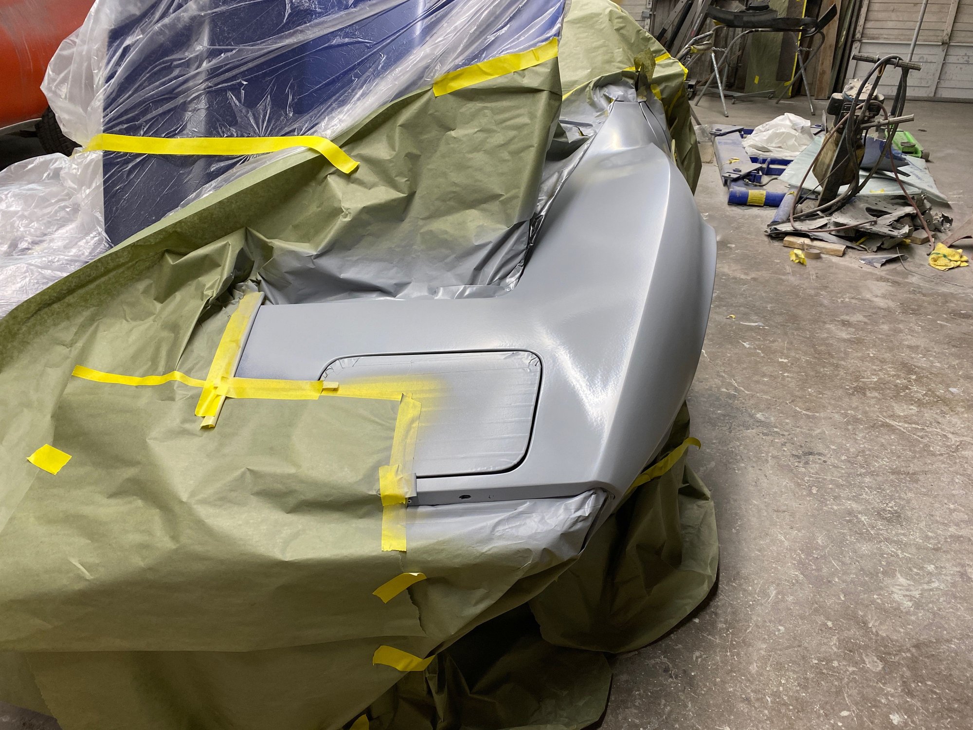

Salem Autobody doing great work
Made my amateur paint work look bad with this professionally done part.
Getting there soon.

I love the look of aluminum mags. They really set-off a period classic such as yours. But I am reminded that you have to constantly babysit the lug-nuts. It seems they like to work loose. You think that is the issue here?

Were you the last one to put on the wheels and tires or did someone else?
It almost sounds like the lug nuts were over torqued and snapped the lugs.
I cringe when I see someone in a shop install wheels with an impact gun.
Check the other three wheels, nuts and lugs before you put that beauty back on the road.

I was the last one to put the front wheels back on to move into trailer to be transported to have engine installed. Had taken them off in order to remove engine and do restoration in the wheel wells and engine compartment. I put on with lug wrench. Have not checked them since that time in July and have only drive about 100miles since. I don't think I could have over torqued but...?

Metric lug nuts perhaps?

Are those wheels hub centric or lug centric meaning which one does the centering of the wheel? Ouch.
Had some aftermarket rallyes that the lugs were supposed to take care of it...they kept working their way loose and beating the wheel up.

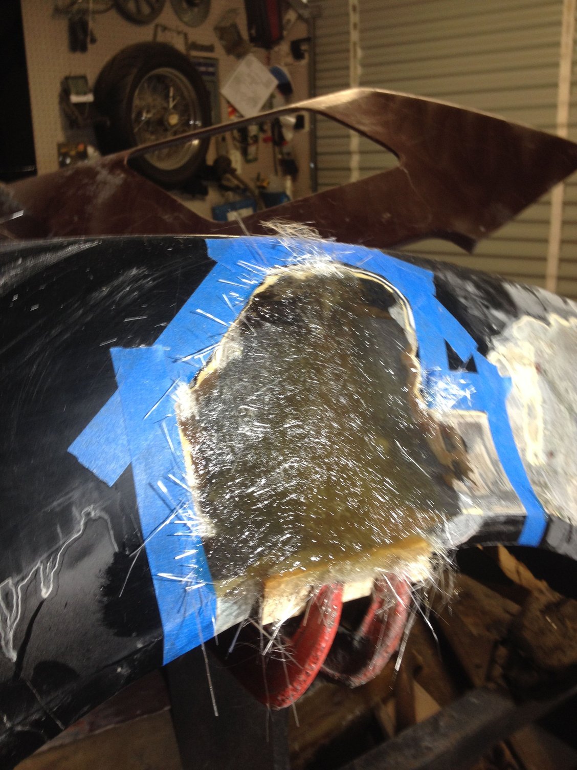

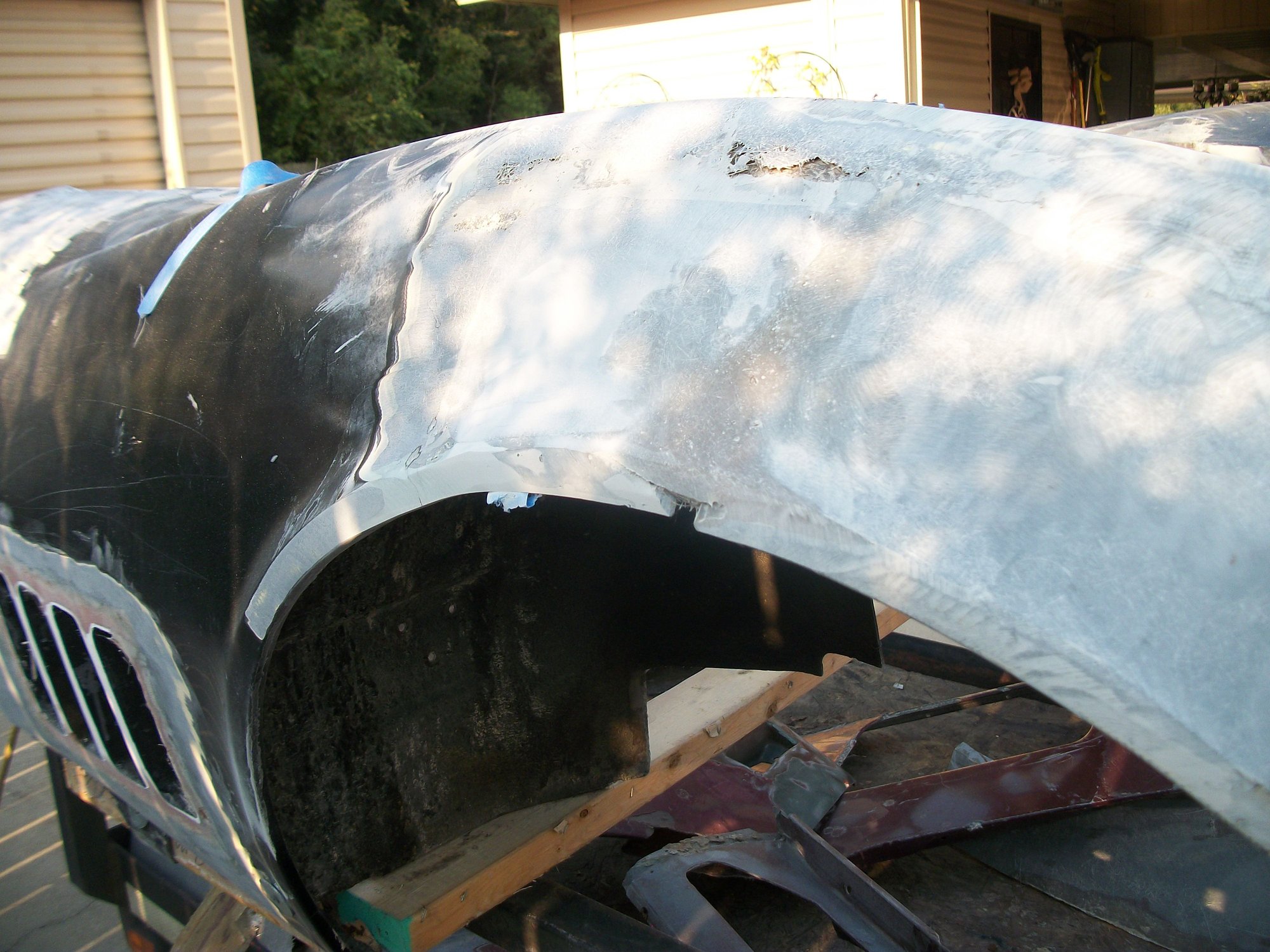

I'm a rookie at fiberglass repair with no previous experience. The members walk me through the repairs and keep me on track.
It looks as though you need a complete repair panel for the driver-side...…..around $300 .
You could probably shop-around and pay less for a non-GM repair panel.
Were you able to collect/save any broke pieces after the accident? If so, you could graft those pieces back onto the remaining fender.
I repair small cracks until I feel comfortable....then I repair larger cracks until I feel able ti cut and fit larger holes (as you see me doing in my thread.
Use a quality electric 120V A.C. heat gun to warm the sections that need to be removed and replaced....use a paint scraper tool to help separate the loosened warmed adhesive until the broken pieces separate from the undamaged areas of the fender.
Wait for members who are expert at fiberglass repair to advise you on the best way to make the repairs.

Hope you were able to retrieve the fiberglass pieces. I think it would be much easier to patch them back in than to replace the entire fender.

My inside technical experts confirmed by suspicion that this can happen if the lugs were not torqued sufficiently. Apparently, loose lugs can back off partially, causing the studs to feel excess vibrational stress and ultimately fail.

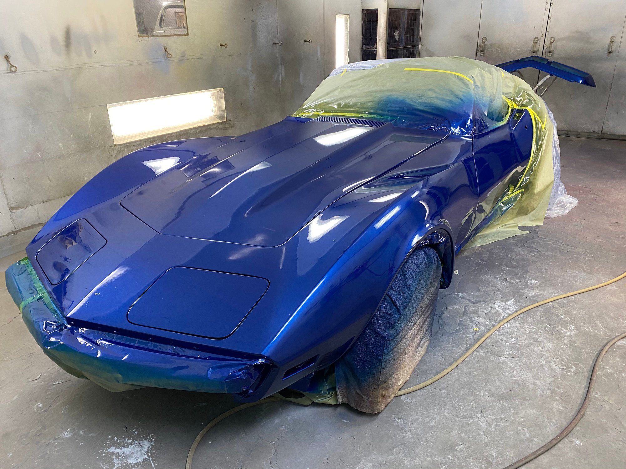

There is hope!
Getting there soon.

You are close! Hang in there, you're almost back on the road!

Looks like you pick the right shop ,that color looks awesome .Wont be long now till your back on the road .I am off to check my wheel nuts

Looks good. Is the interior car being painted? If no, I would be concerned about paint match.
