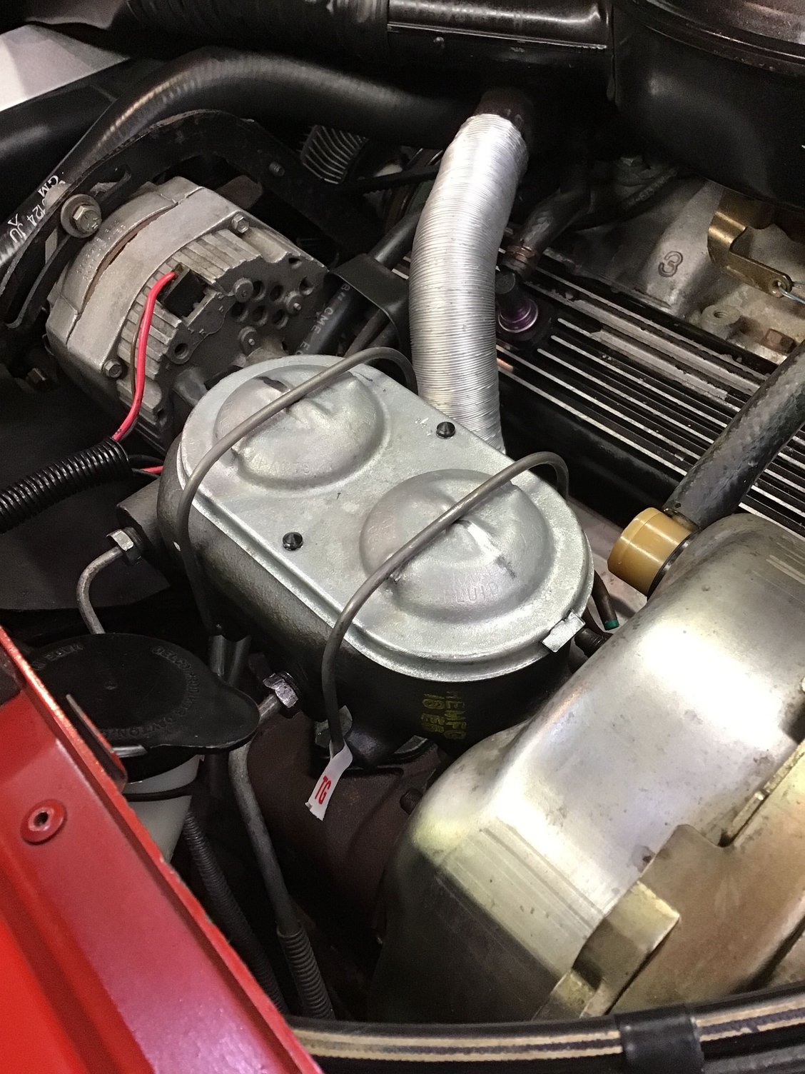

Here is a picture with the tag installed on the bail.
John

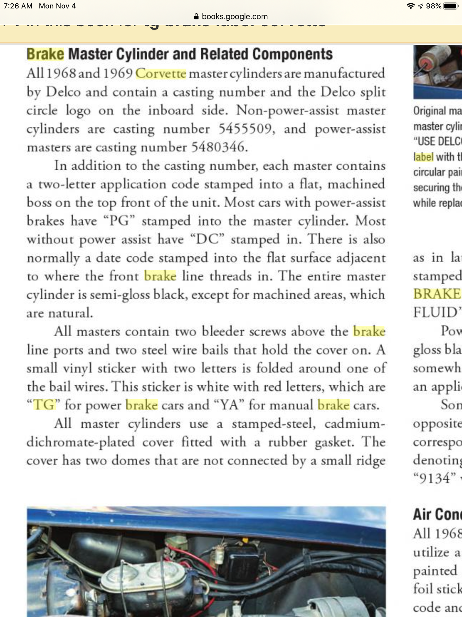

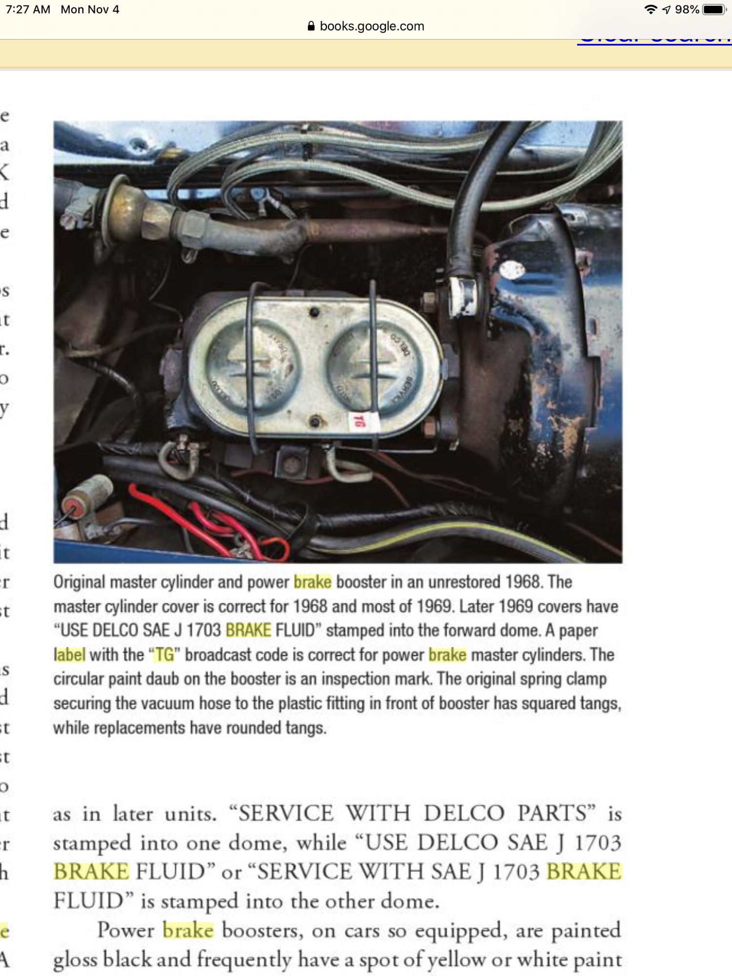

I think one is for power one is not..i also asked vendor, they didn’t know, found online could be anywhere...
here is mine
Its loose
here is mine
Its loose
Always learning something here.

Wouldn’t ya be correct for NON power brakes?

Looks like I have the wrong decal. I should have a "YA" sticker for non-power brakes. I'll correct this. Thanks again.
BTW, what is the source of this info? Is it a restoration manual, and where can I get a copy?

note mines a 79 and borrowed research 68 69 google books..but assume they wouldnt change tags

Looks like the first two photos (interpon) were Googled from the Richard Prince 68-82 Restoration Guide, not sure on the last photo. Here are two very good sources for you to purchase. The Prince book is usually sold in many book stores. But the NCRS TIM&JG is sold on the NCRS website Store. Some Corvette Vendors also sell the NCRS Judging Manuals.
Hope this helps!

that is correct.. both pics.. were from the google search.. note the yellow tag words I used.. shows up about 6th.. and in google books.. usually its like a preview to buy book but sure seems to be a lot of pages there..
