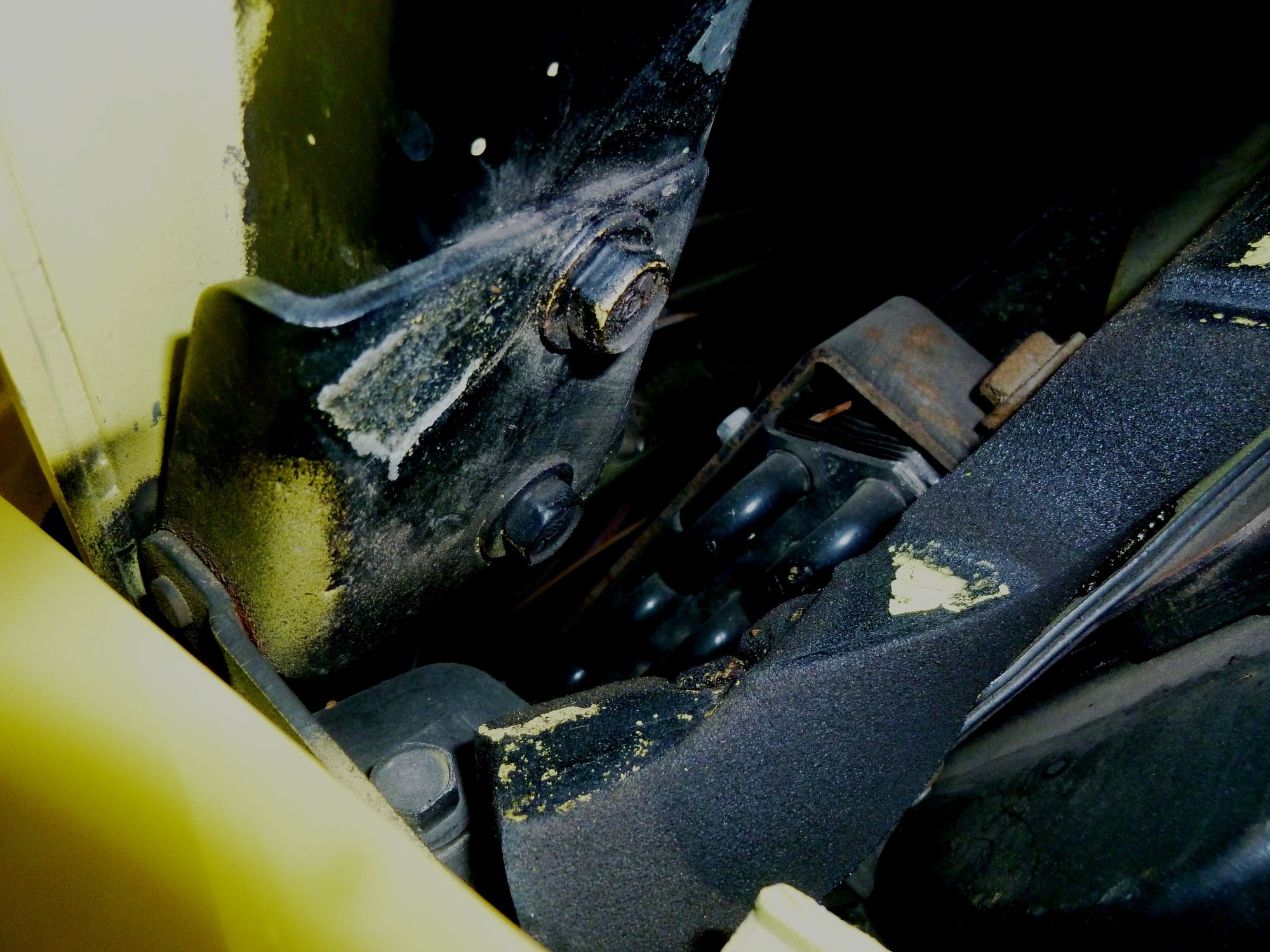

Great points! Thank you. So the Hood hinges are ok to have over spray?

Originally Posted by Pvirg
Than So the Hood hinges are ok to have over spray?
Yes! And will also show blackout as well. Here's photo from the 73-74 NCRS newly revised technical manual...low-mileage 74 LS4 car
