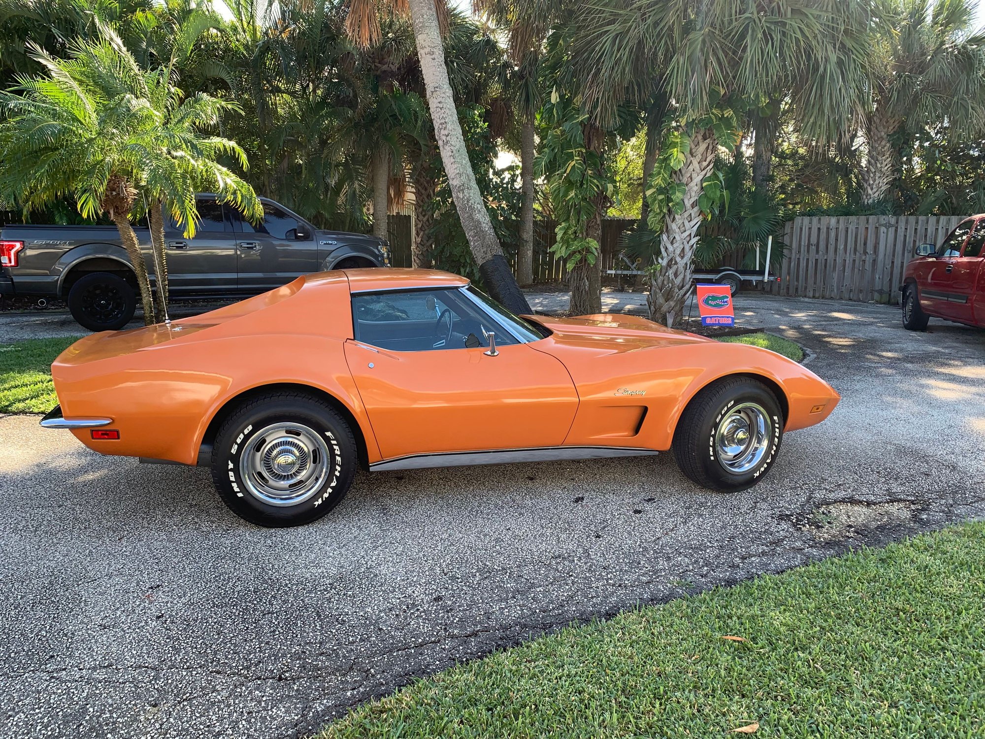

Hi everyone!
I waited 45 ish years but I finally bought my dream car yesterday (73 Vette). It's really a cool car, but has a couple minor problems. One is the passenger side mirror is limp, meaning it's there just won't stay in one place. What's the fix for that, just buy a new mirror and replace? I read somewhere that that screw on bottom part of mirror is just a set screw to hold it onto a plate. Is that correct?
Thanks in advance!!!

Congrats on the new car brother and welcome to the club!
'73 is one of my favorites. How 'bout sharing a few pics?
Greg

Great looking car!
Excellent color for a '73.
Once the swivel is loose the mirror is finished. You can just buy a new mirror from any of the Corvette parts vendors. Not too expensive and a 5 minute change up.
