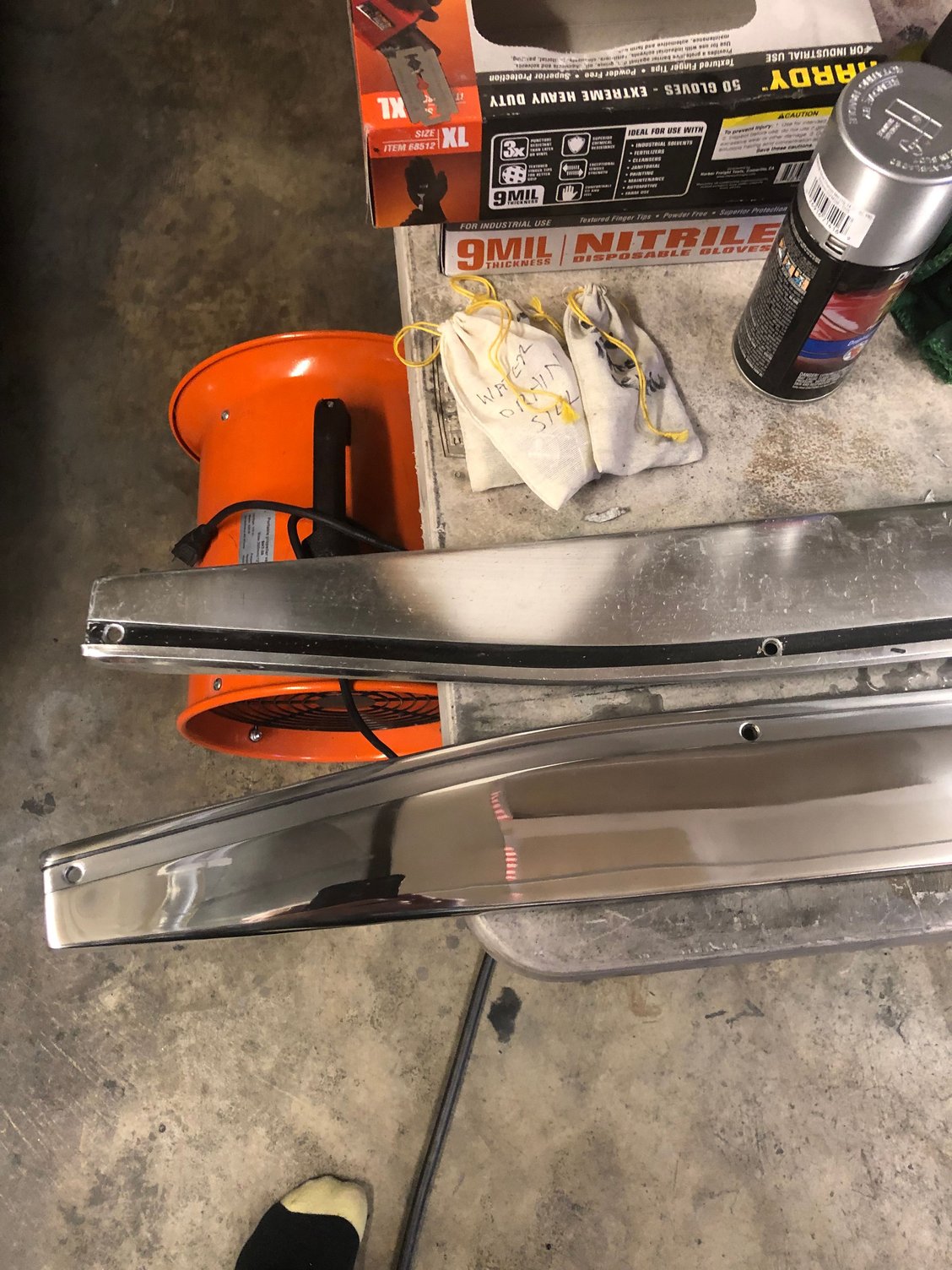

Hi Dan, I have fitted two sets of these, one on a 77 and the other on a 79. On the 77 the holes in the manifold flange which mount to the engine did not line up with the locations on the head so needed to be opened up. On both cars there was a significant difference when installing the header to head bolts. On the 79 it was very easy on the 77 the position of the down pipes made it really hard. If I remember the bolts had to go in before the flange was positioned against the head. The flange hole allowed the bolt to go in at an angle because the down pipe would not allow it to go straight in. On both cars the pipe near the pitman arm had to be dented in to clear it. Other than that they fitted well. On both cars the passenger side pipe was closer to the rocker panel. Loosening of and rotating the engine on the mounts would not work as it seemed like the passenger side was further in than the drivers side. On the 77 we just trimmed the aluminum rockers trim on the 79 I did not want to do that so I modified that header to clear. Hope this is of some use to you.
Pete
This is my passenger side header with the addition of small spacers. I can now fit both rocker trims with clearance and no cutting of the trim
The trims on the 79 are polished. The one at the bottom is from the 79, so I did not want to damage them .

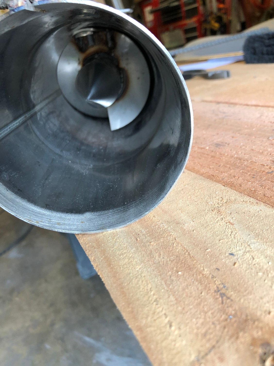

After finally getting on the obx headers and pipes I love the look and they were a bitch to put on . It seemed like I lost some hp. So I read that the obx pipe baffels were an issue I will eventually want to get maybe turbo baffels or something long story short i ended up modifying the baffels and reinstalling them I like the dougs headers because you can get the pipes,baffels,headers seperate and would have went that route I think all the brands will have fit issues I know there was a significant change in power when I took baffels out it ran awsome but way too loud Im still messing with it today side pipes are a must for me though it gives it a good look but the sound that was always in my head was big block with pipes the small block is not quiet as throuty what made me notice that the obx were restrictive was the fact that my pipes would only get slightly warm but headers were super hot and so underhood temps were actualy hotter than when i had manifolds

curious Jim, did your rocker panel covers fit without having to trim them? Asking because I found that the drivers side fitted but the passenger side would not without some trimming.
