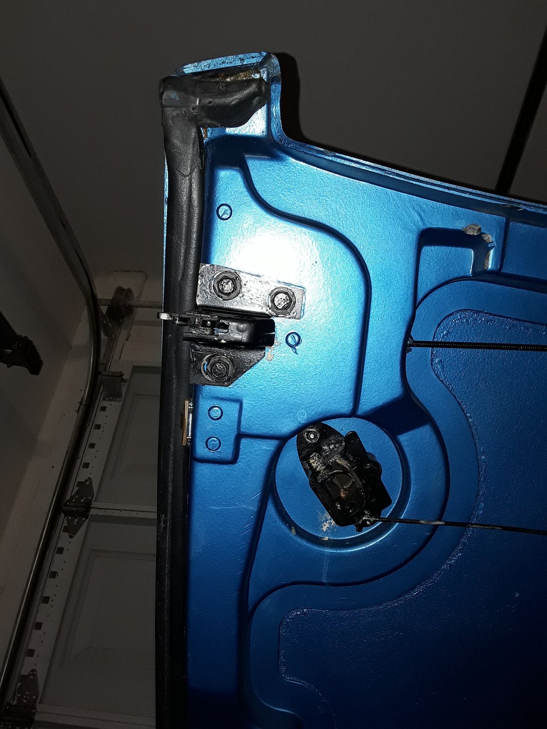

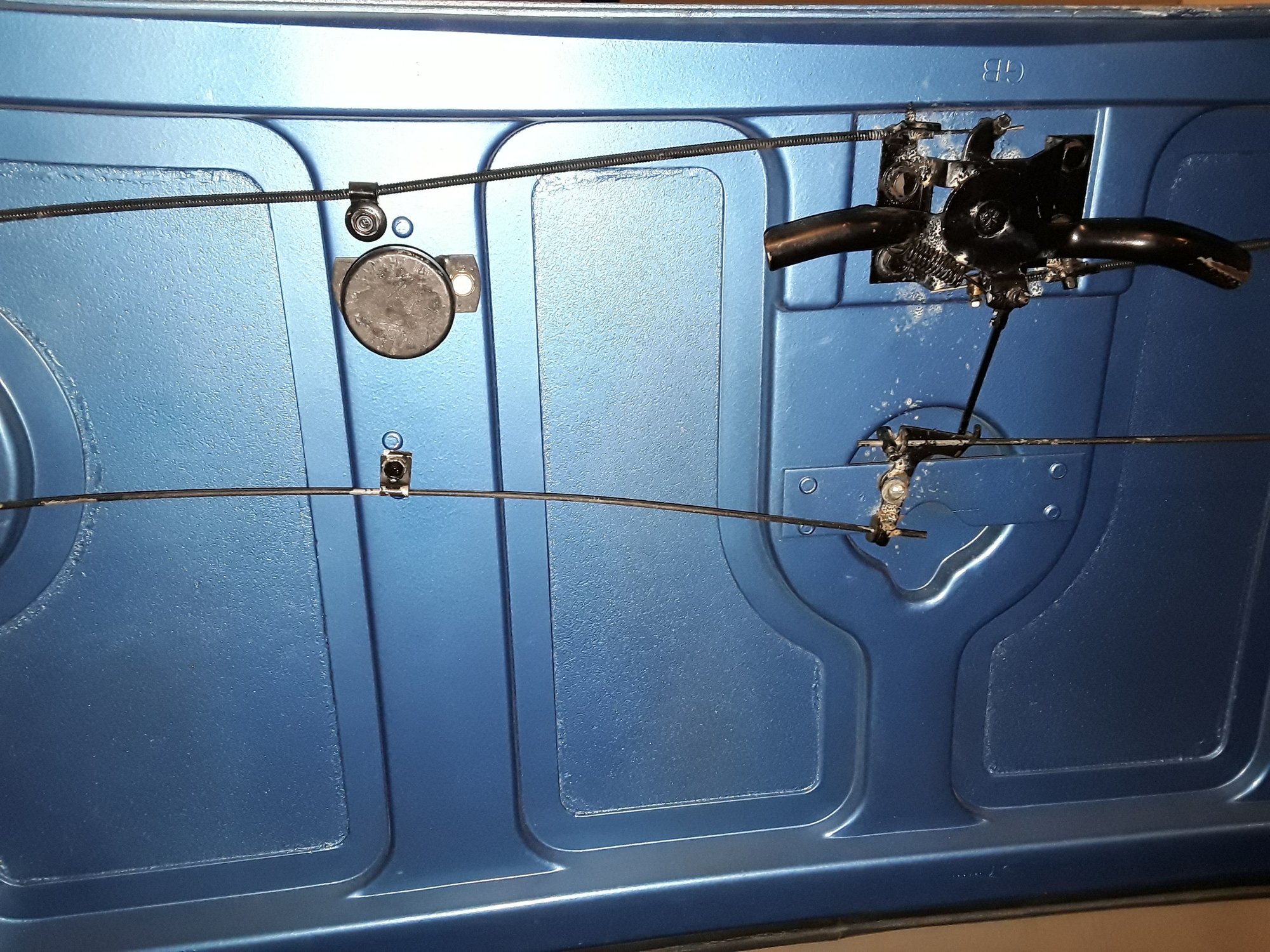

The deck lid handle pulls a cable that's connected to the latches on either side. If you can grab a flashlight and squeeze into the compartment you can pull the handle and see if it's moving the cable. If the cable is broken, you may be able to remove the three bolts that secure the latch and get the deck lid open that way, then fix whatever the problem is.
These pics are of my 69. Handle on the left pulls the top cable which opens the passenger side latch. 2nd pic shows the 3 bolts that secure the latch.

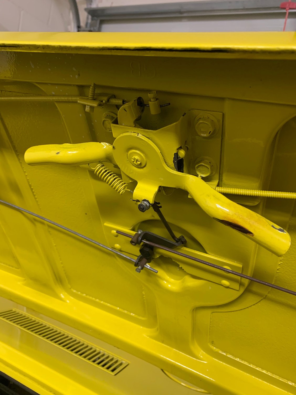

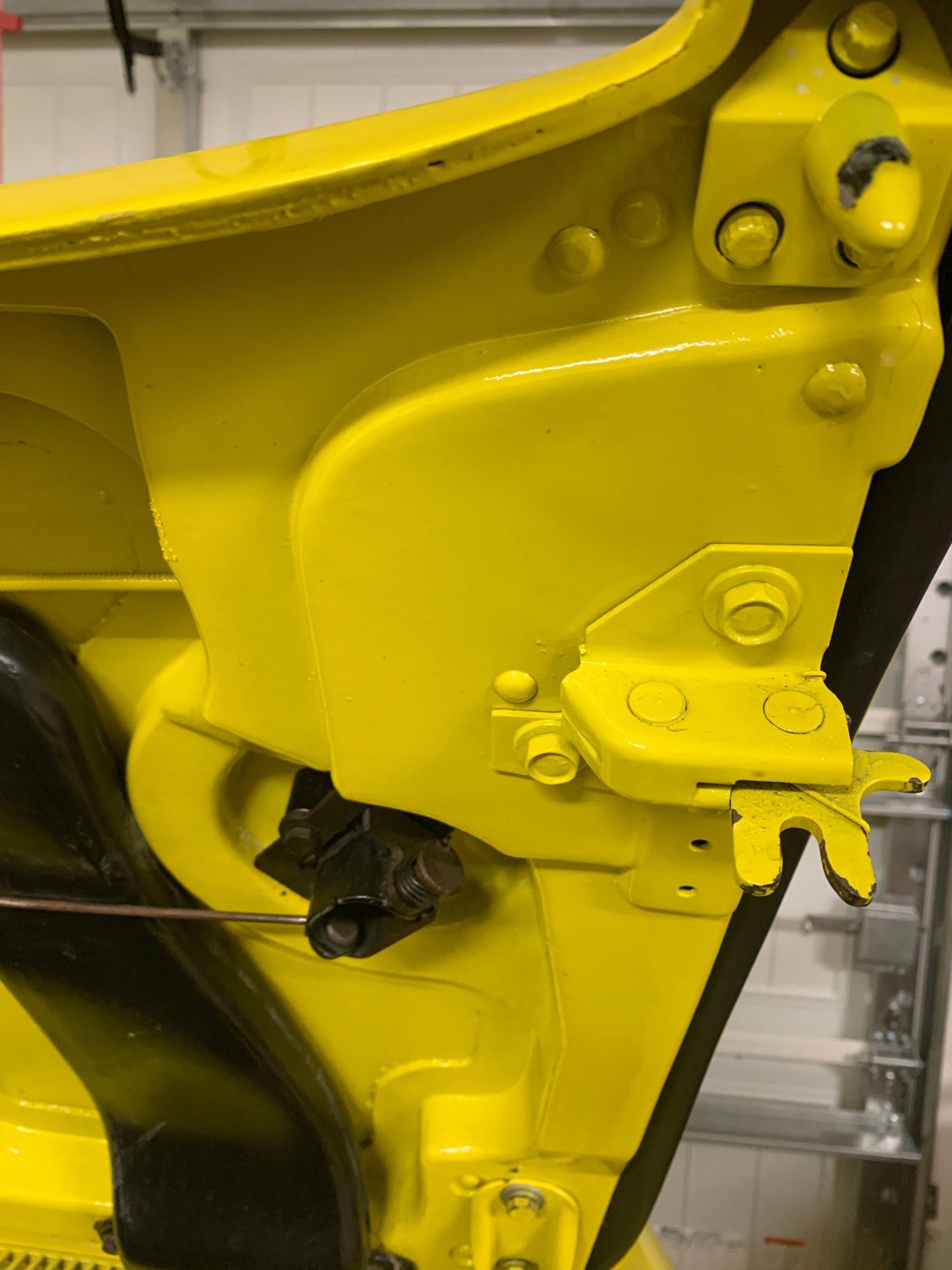

OK, went put to the car and took some pics. First one shows the two different latches. Soft top latch is controlled by a rod. Deck lid catch by a cable. Second pics shows the handles and connecting mechanism. Both the rods and and the cables have cable stops installed. If one of those loosens up, it will slide on the rod/cable and things don't unlatch.
Hope this helps.
