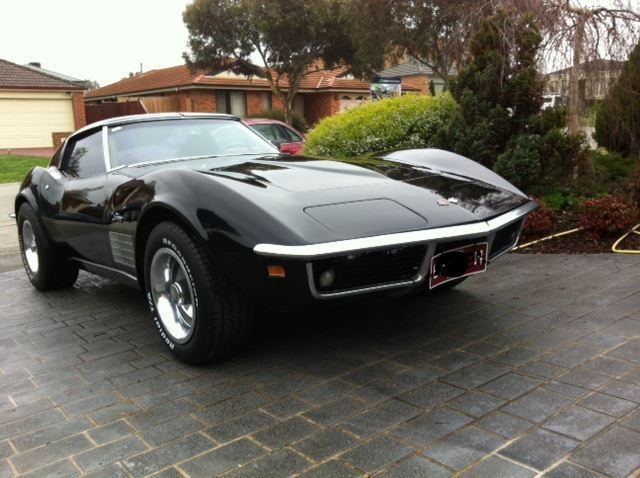

Hi, I've come across a 69 coupe VIN .....S707277 with a November 68 Build Month. It has a complete 1970 body. The current owner has been in touch with both earlier owners and they confirm the car was like that from new and have photos from back in the day. The story they tell is that this was a GM test mule to try out the 1970 styling. Currently black but was Riverside Gold. Unfortunately no useful documentation.
Has anyone heard of anything like this happening before?

I'm getting more info and photos. Looks like original owner worked for NASA. The car has 69 front grilles and round indicators. Has the smaller side markers like a 69, but the side vents and front and rear flares are 70 style as is the rectangular rear exhaust. I'm told fiberglass is all original. Will post some photos soon. Hope to inspect it in person.

if this is authentic, the 70-only parts will be one-off and not identical to what is found on production 70 cars. start with the louvres. part number cast in them that matches 70-71 cars? casting date?

Adding the 70 up flairs to 68-69's, was a pretty common modification in the 70's. More than a few owners did, just to save the paint on the fenders. A friend of mine has a 68 his father bought new, and added the 70 flares to in 71. I will say that it's a little surprising that it has the 70-72 exhaust panel though. If you used a complete 70 rear quarter, then you would need the 70 exhaust panel, but if you were just adding flares to 69 fenders, then the rear of the fender would still have the small, rounder 69 opening.
I don't know that the VIN would make much difference. It's quite possible that a car that ended up being used as a styling exercise by GM Design, may very well have been a car that was floating around GM for some time. Cars that were used for the press pool or by engineering, were sometimes sold to the public, but I would assume that sometimes they were held onto, and used by other departments within GM. Also, considering the lead time needed for developing new parts, and putting them into production, a year doesn't seem out of line at all. 70 production didn't begin until January 70, but the pilot line cars were probably completed 3 or 4 months earlier, and shown to dealers and the press in September 69.
You said the panels are all original, does that mean they're press molded? From my experience, factory prototype parts were usually hand laid glass. I'm familiar with 3 pilot line cars, a 61, 65 and 68, and all have some hand laid glass pieces. Of course, aftermarket parts would likely be hand laid also.

Thank you for all of your replies and the tip about casting numbers etc on louvres. See this poor but intriguing photo. Why would someone rebodying the car go to the trouble of grafting in the smaller side markers?
I'll keep you posted, particularly after I've seen the car!
