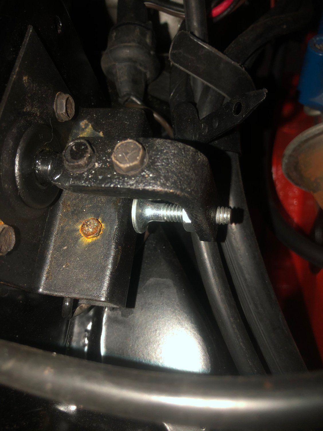

are you talking about this switch?
if so, i forgot all about this! my door and vent are not mounted right now. but all my vacuum lines and wiring is. so does the switch need to be pressed or released too allow the circuit too be completed? i am going too willcox again and look for the diagram....thanks troy

Yes it has to be depressed. If it’s not installed you can get 2 male blade connectors and just make a jumper

got that one figured out. It was not depressed all the way! Now on too the under dash switch, that had no ground? I grounded it and now I have low speed only with a clicking. Were is there suppose too be a ground on this dash bracket?

Well, I grounded my wiper switch because my gauge bezel was cracked and repaired. So the switch was not getting grounded. I found the ground wire for the under dash bracket and attached that properly. Adjusted the cowl door switch too compress the switch properly. And everything seems too work now. I have high an low speeds now. Thanks for all the help guys. And thank you WILLCOX for great videos and instructions on your site! Troy
