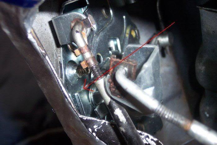

To get the door open,rest a screwdriver on top of the piece of metal the arrow is pointing to and then give it a wack to open the door. At first it is hard to see,good luck.

I tried that, it is functioning properly. Still doesn’t open. Thanks
