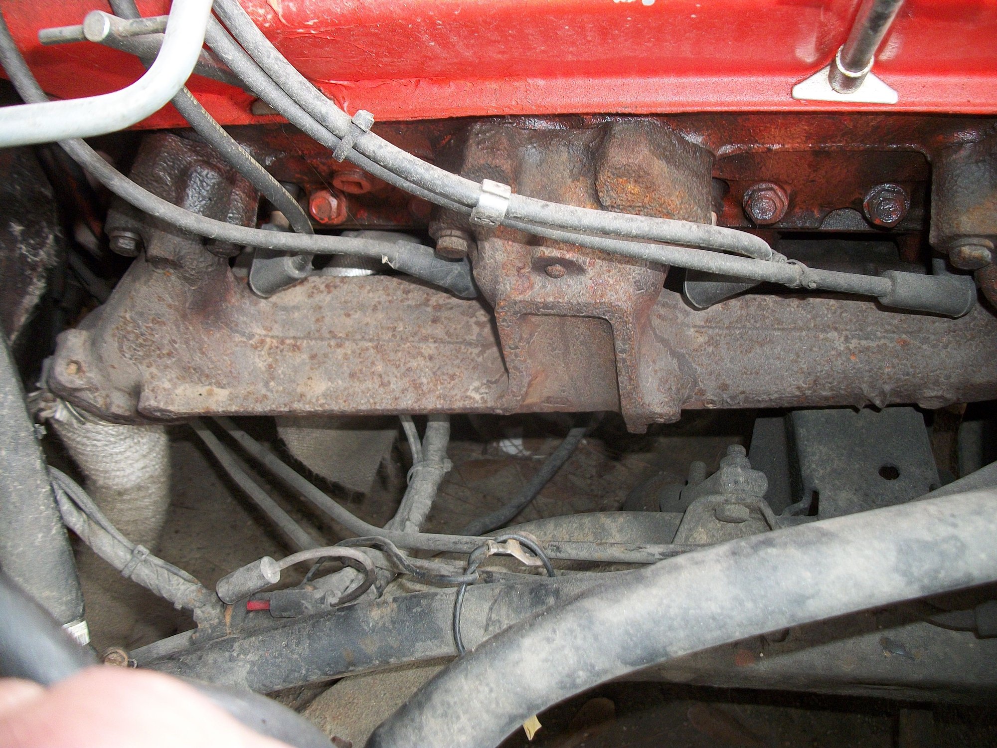

That style of exhaust manifolds were used on a 66 Chevelle, I know because I purchased them from a friend and used them on the small block that I stuffed in my brothers 66 GTO. T

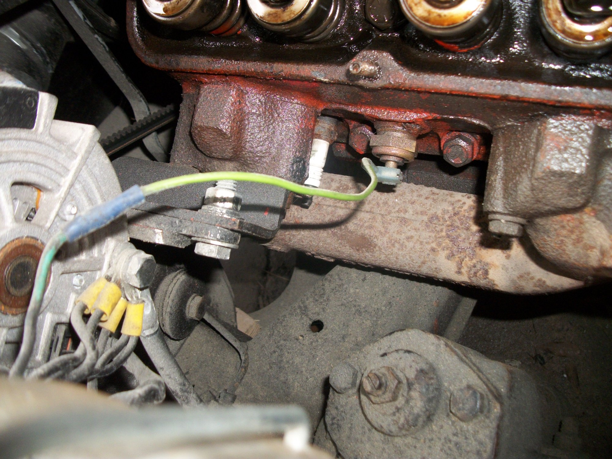

Yes please do because those exhaust manifolds are all wrong for a SBC. The bolt pattern and the port layout are not SBC but look more like BBC.

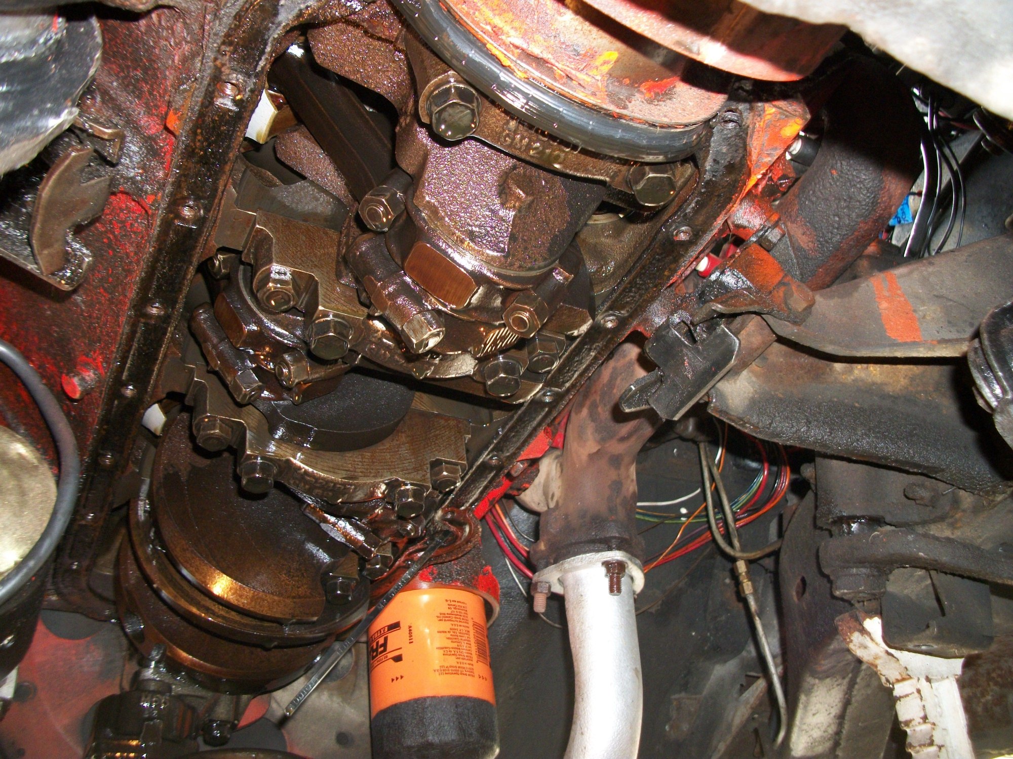

This lower end pic was taken when I bought the car.
I couldn't get a block casting number. I have the Ser.# in the garage...be back in 10 min.

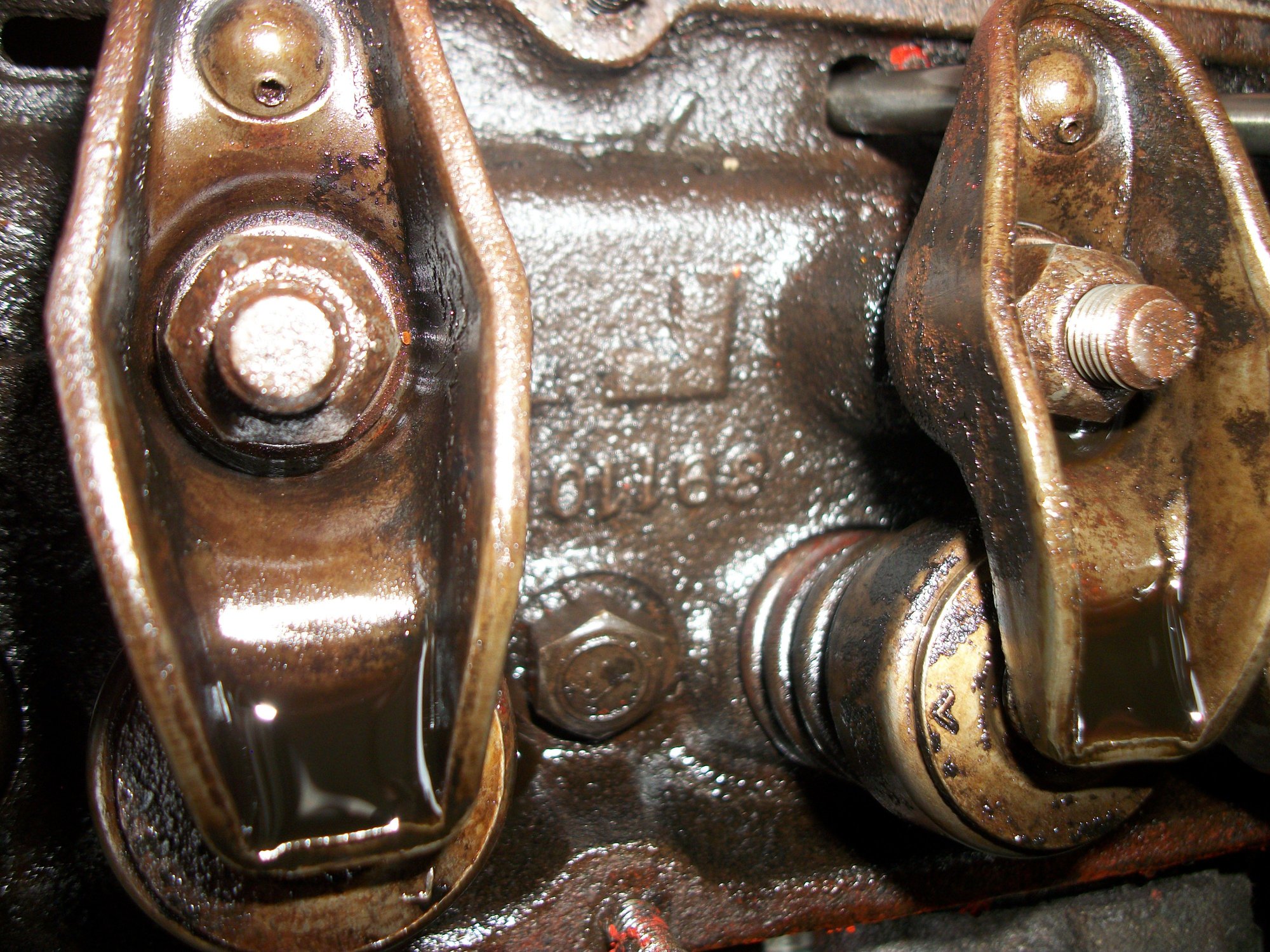

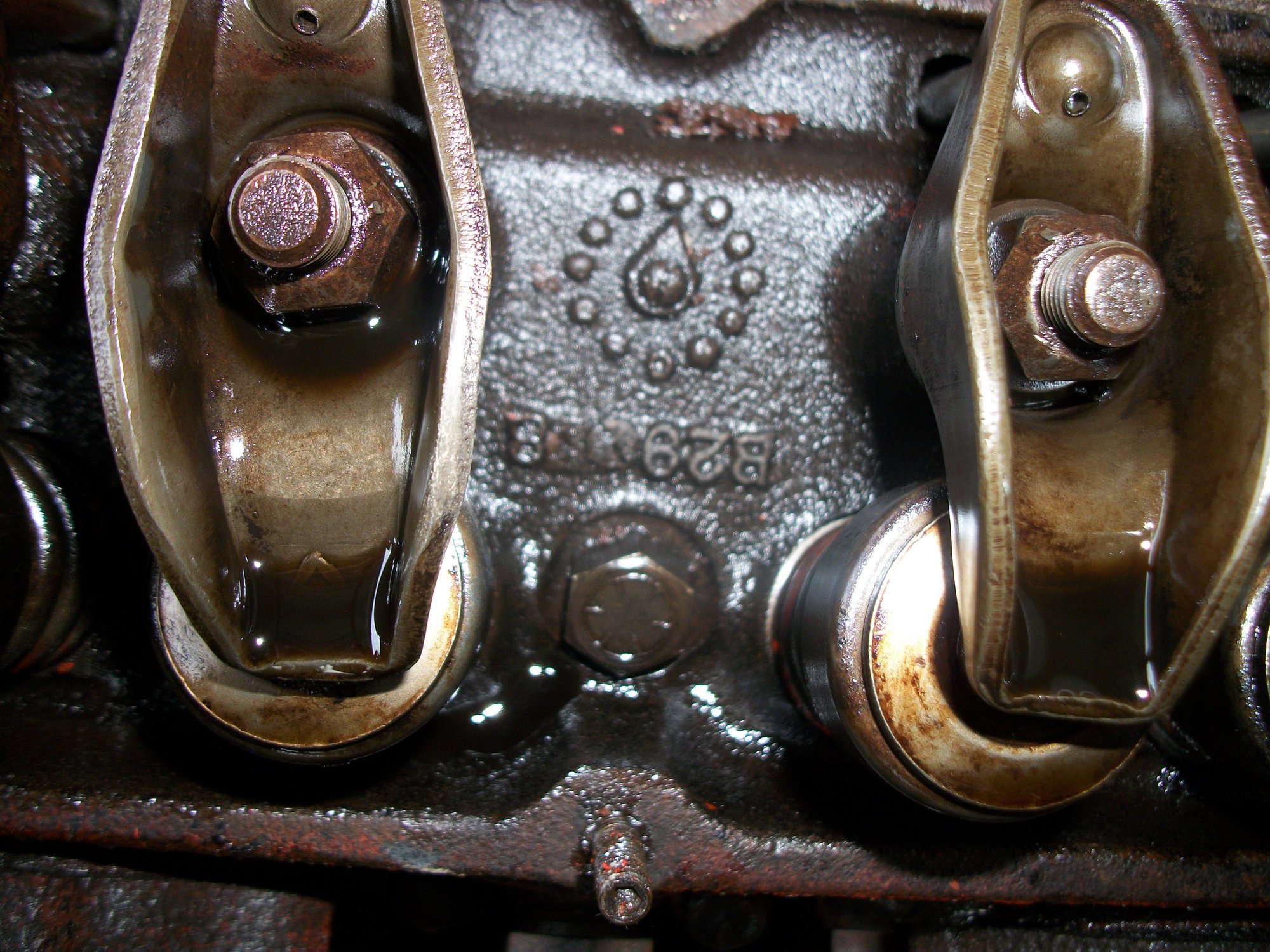

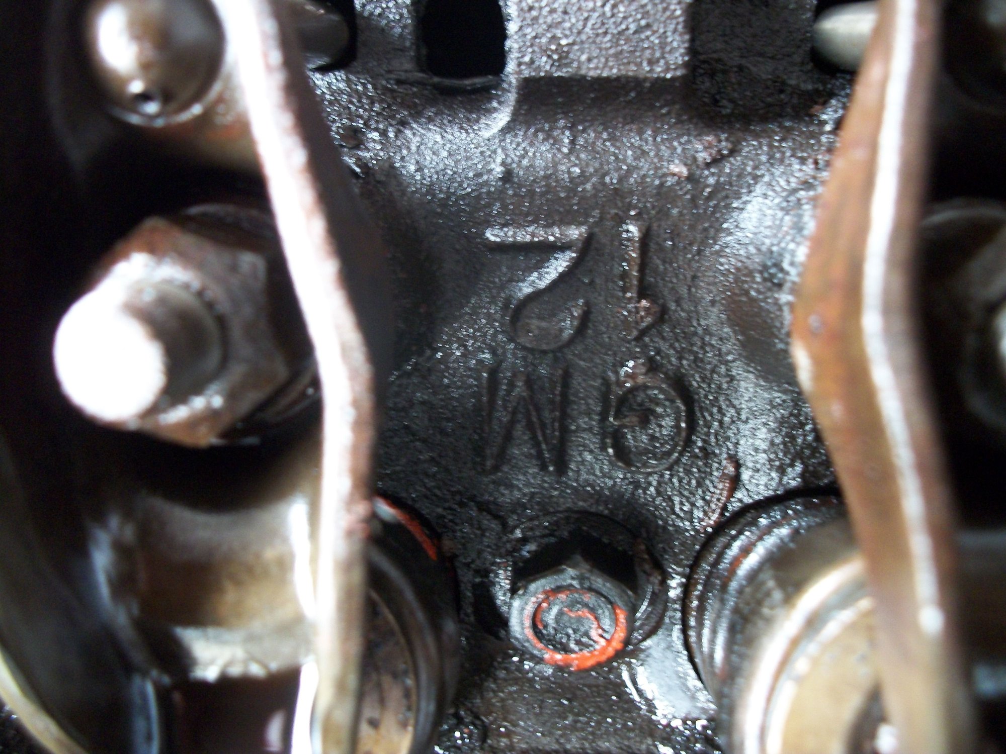

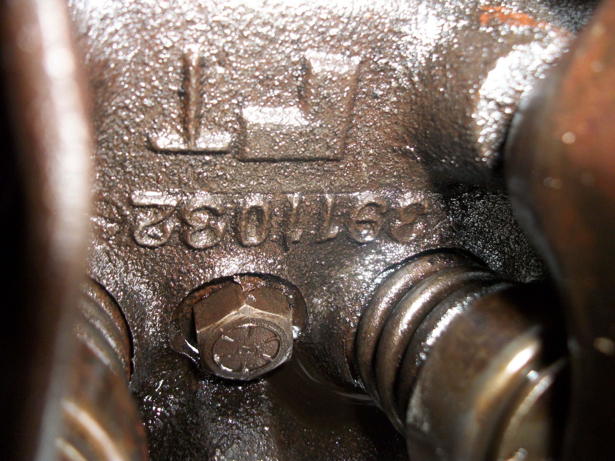

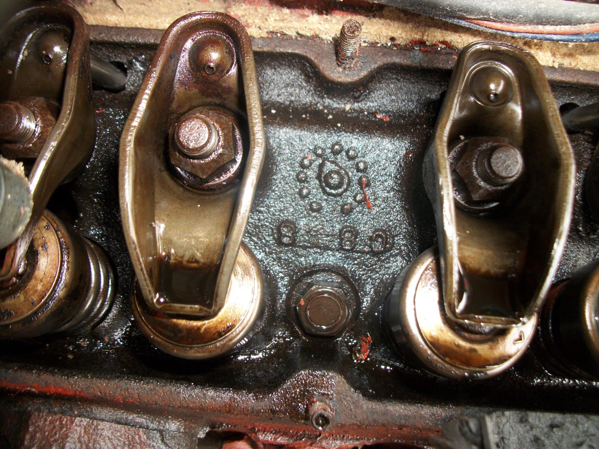

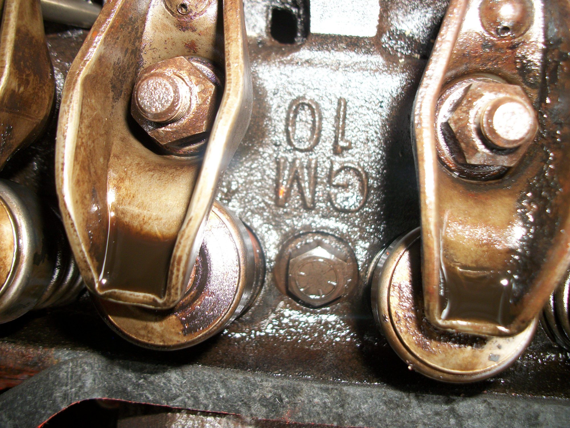

3911032 - 307/327 68-70 1.72/1.50 70cc" not the greatest but like you said, "Get it running, go have fun, then looks at later". not a big deal. Save up for some good ones at a later date

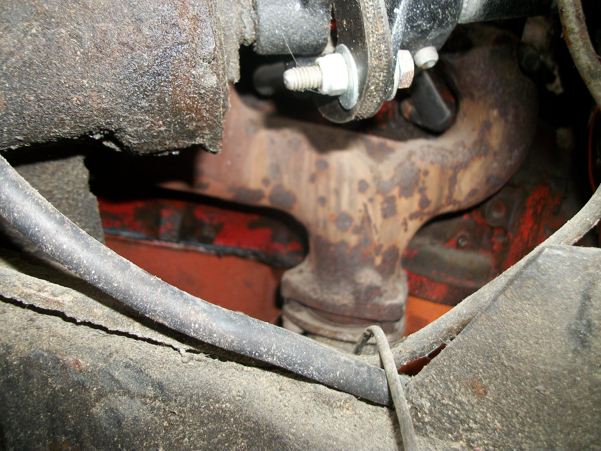

I will say those exhaust manifolds you posted earlier in the thread have no resemblance to anything that fit this motor. Those are BBC manifolds and the ones on the motor are just standard SBC manifolds.
That's O.K. I'll be going on long road trips and won't need 325 h.p.

It's certainly a small block; may be smaller than 350
seems heads are bottom shelf and probably cast too early to be a date match to motor assembled MY 1970
that's certainly a cast iron crank, not steel

The first thing I'd do is chuck the fram oil filter, their quality went south about 20 or 30 years ago.

Yes, the STYLE (log) of that manifold was indeed used on the A-body GM cars, but the ones that "DG" posted, in post #3, are most definitely BBC manifolds.

Those are peanut valve 307/327 heads.....low performance truck heads. The exhaust manifolds currently on your engine are later passenger car and truck manifolds.....this is THE first time I have ever seen these in a Vette......all I can say is WOW.
