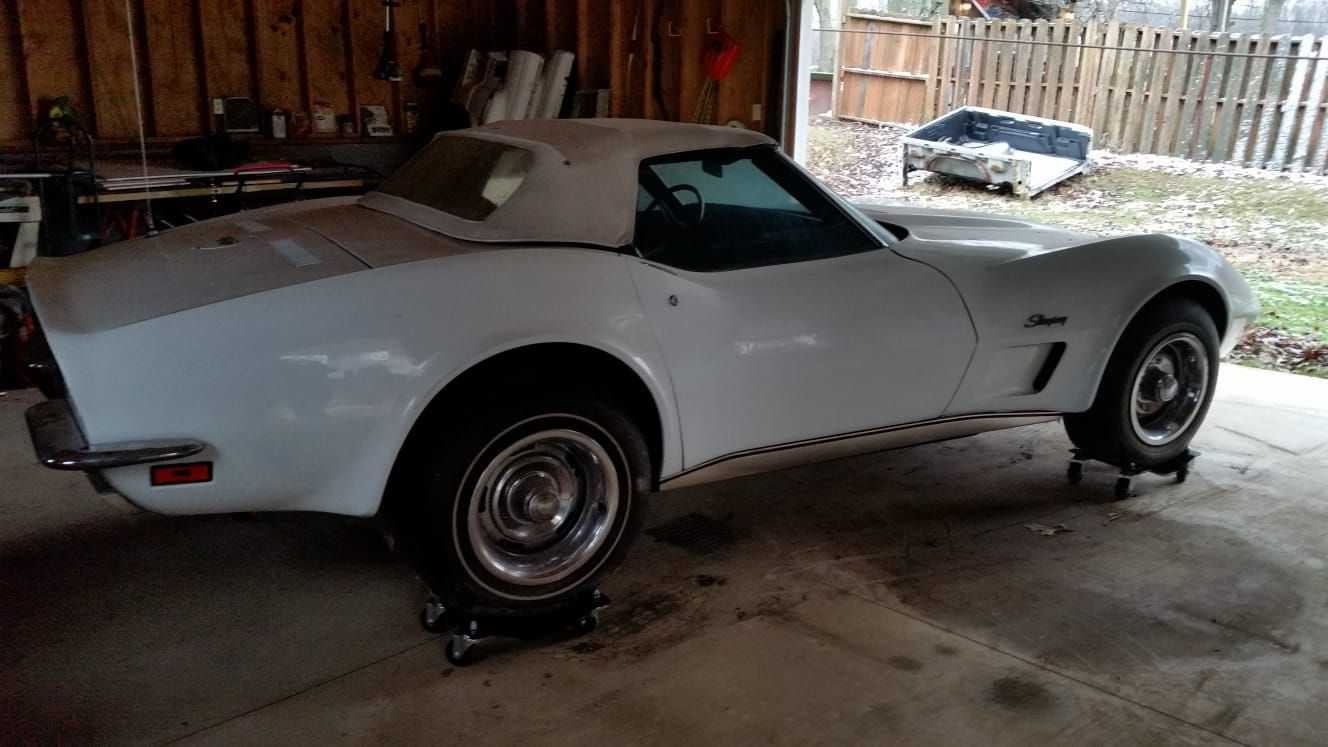

Car looks to be in good shape! 73' convertible at that! Sorry about your loss, but I'm sure your dad would love for you to have his car rolling again... Looks like it has great potential.
Definitely change all fluids, check the gas tank for rust/varnish etc.... blow the fuel lines clear, new fuel filter.... Obviously its gonna need the brake system gone through as well....More then likely, you need to replace all hoses/belts etc. Lastly replace the tires, regardless of how much tread they have. They are old and they WILL come apart.
Good luck with the project, you have a good car there.

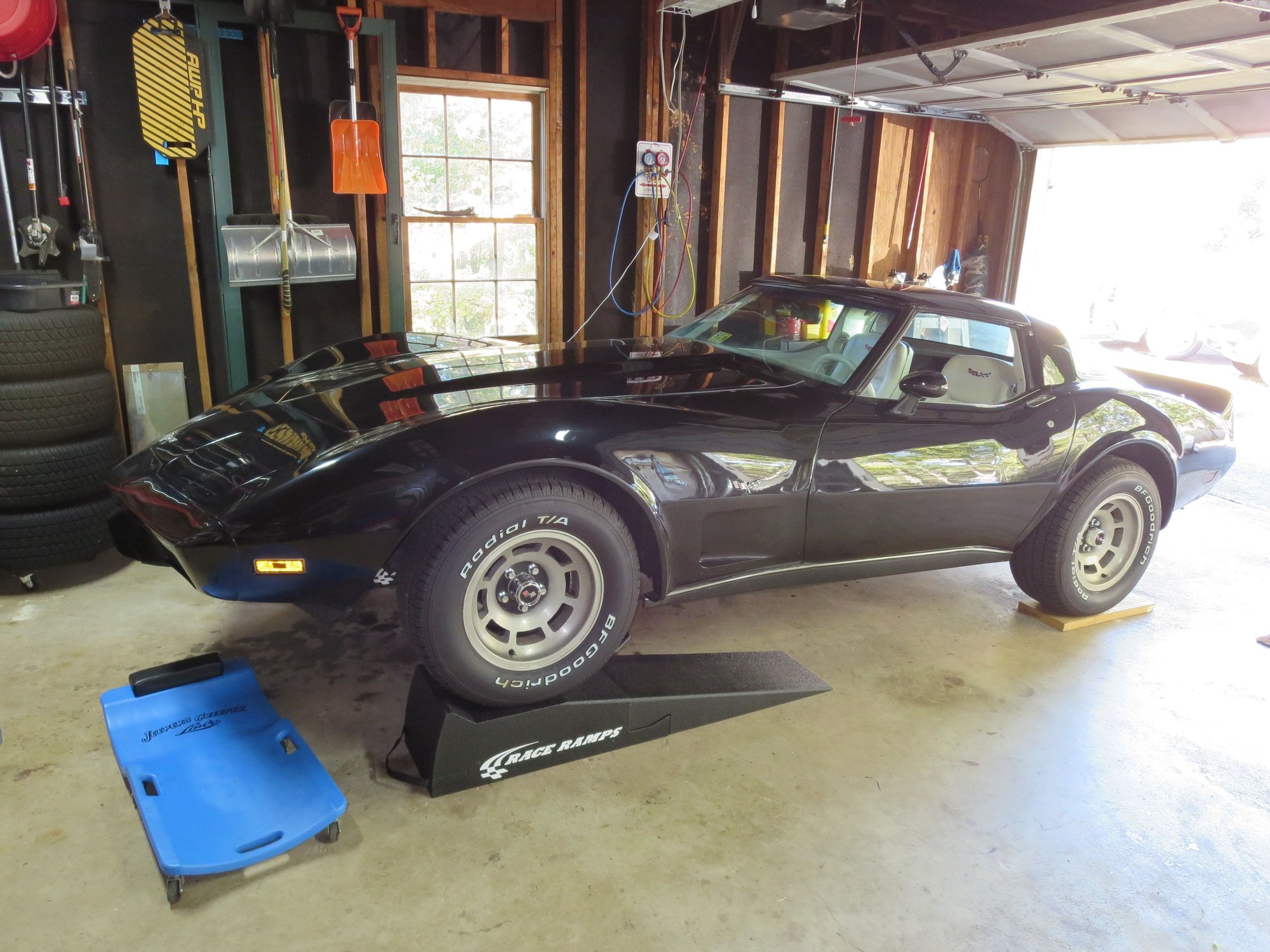

The best solution for getting under the car in a low garage is likely a Kwik-Lift. I had one for a few years, then sold it for what I paid when I was done restoring the suspension.
To get a car on jackstands I use two hydraulic floor jacks if I need to lift the rear (or lift by the differential). I roll up onto RaceRamps, then lift the rear onto jackstands, then lift the front if needed (from the front crossmember, which everyone will tell you not to do). This minimizes pivoting on jackstands. I use the jackstand position in front of the wheels (shown above) when needed.
If you just need to get under the front, RaceRamps may be all you need.

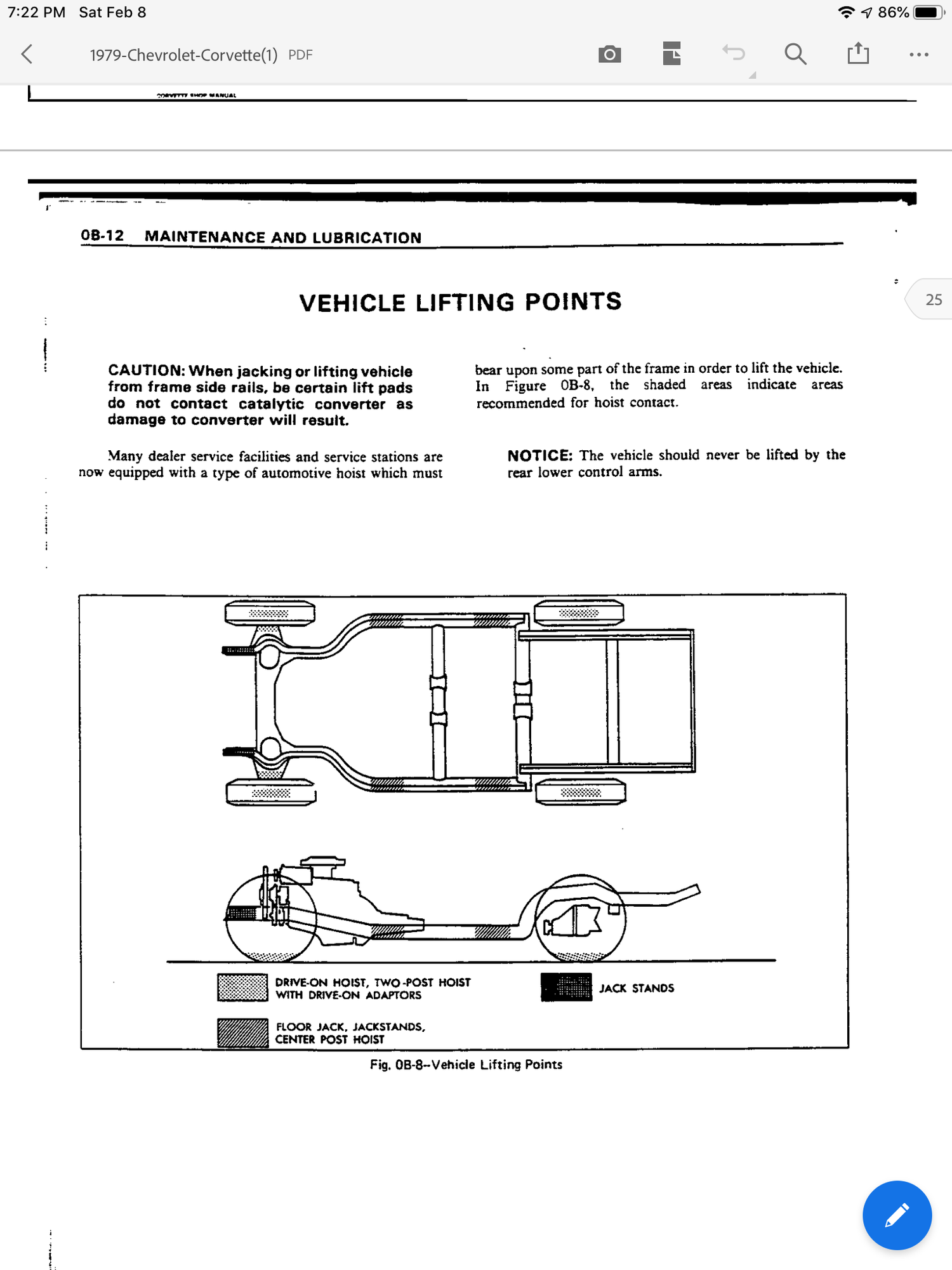

use the jack points in diagram
the very front is for jack stands support not lift point,
and yes quickjack rocks

I can't tell you if your frame is good or not. But if the door operates normally with the car on 4 wheels, you should be able to get under it to have a look if you keep it on the wheels.
If you just need to get under the front, or under the whole car, I can't suggest RaceRamps, or a Qwik-Lift, strongly enough. The RaceRamps website has a calculator for your approach angle, to tell you which size ramps to get. Be sure to chock the tires!
