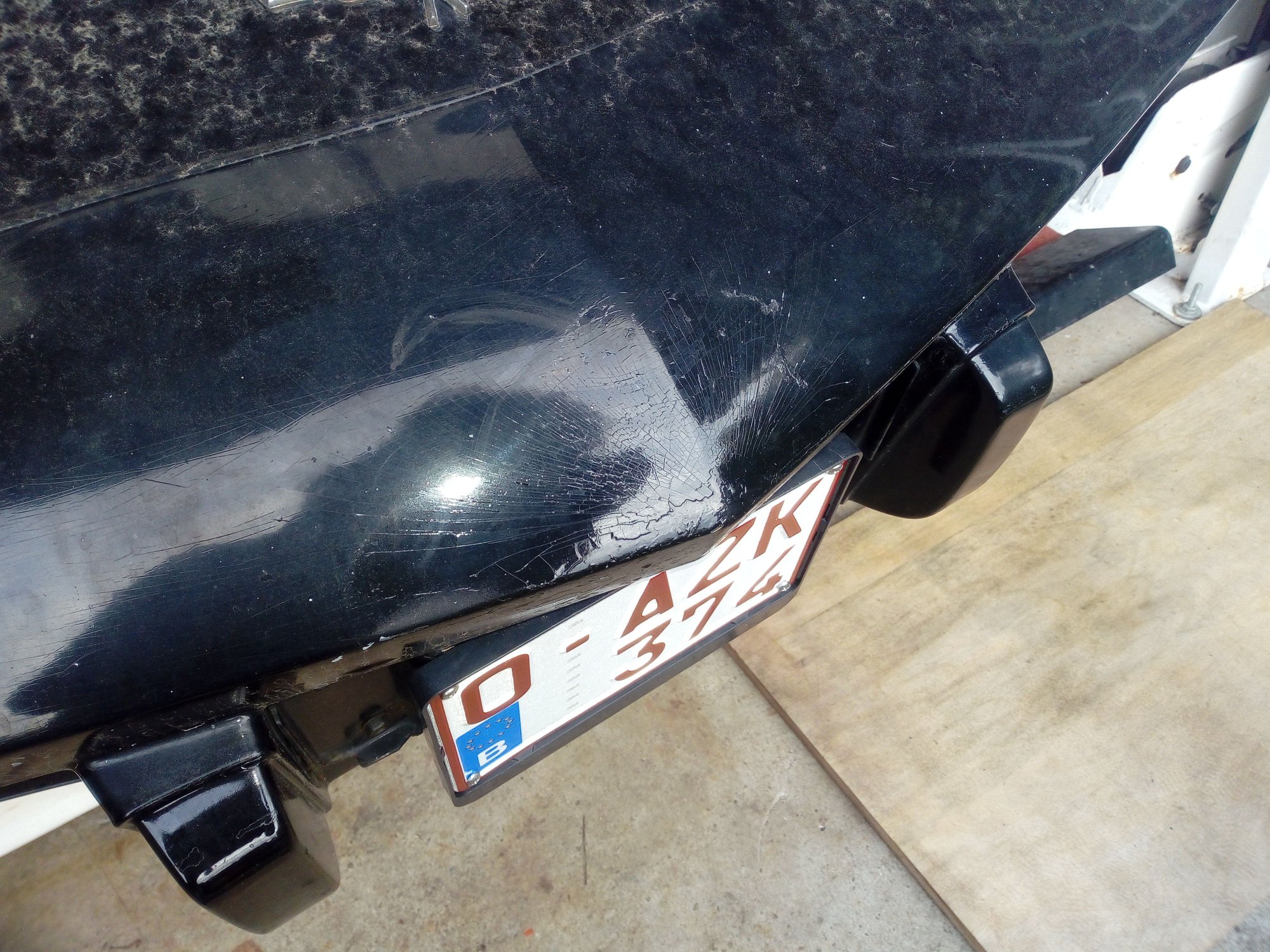

The current bumper, which has been repaired/repainted by the previous owner, has had it’s time:
- Lots of deformations which are just ugly…especially whit the black paint, it’s very noticeable. The sunny California did no good for the flexy urethane bumper.
- The small repair on the ‘nose’ of the bumper was very badly done… The paint is chipping; the ‘flexy body filler’ that has been applied, clearly was done in a hurry with no attention for detail or smoothness.
Here are some pics of the current front bumper:

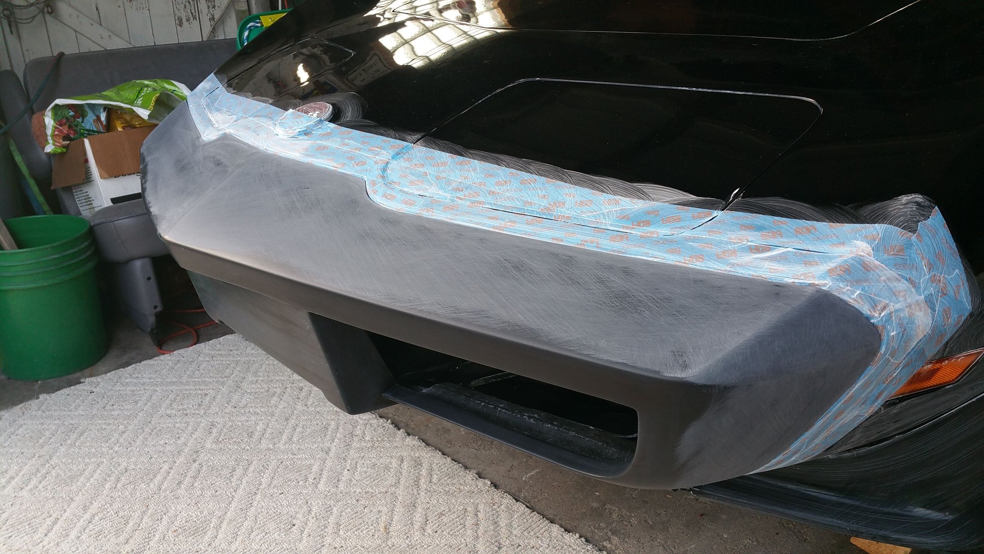

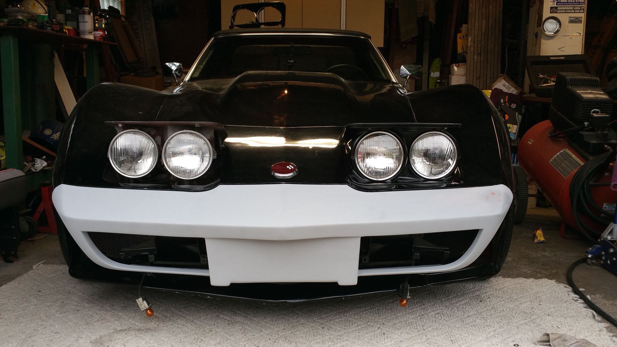

Here is my 75 with the modified bumper cover in primer,, I retained the center section for easy mounting of license plate,,,, Now, in July 2020, we no longer are required to display a front plate,, if I had known, i would have made provision for a 73-74 center grill,,
This pic,,, starting the fit-up

I bought the new bumper... I'll strat right away when it's here!
Thank you guys for the pics, you certainly did a great job!
What tape did you use to mask the front? 3M?

Right now, I re used all but the heavy metal bumper-ette that were behind the cover, for impact protection,, the "battering-ram", [[ if I understand what part you are referring to ]] you likely will have to trim a little ( it's basically plastic) to get full clearance to get new cover over it,,, I did all that underneath fitting BEFOR I did the exterior fit and finish ,,
,, I think I used painter's blue masking tape, but I covered it with at least 3 or 4 coats of wax, mold release wax, , if you search here on forums,, member DUB has a awesome thread on doing the fit-up the proper way,,, I followed his advice, and it came out well,,,,
