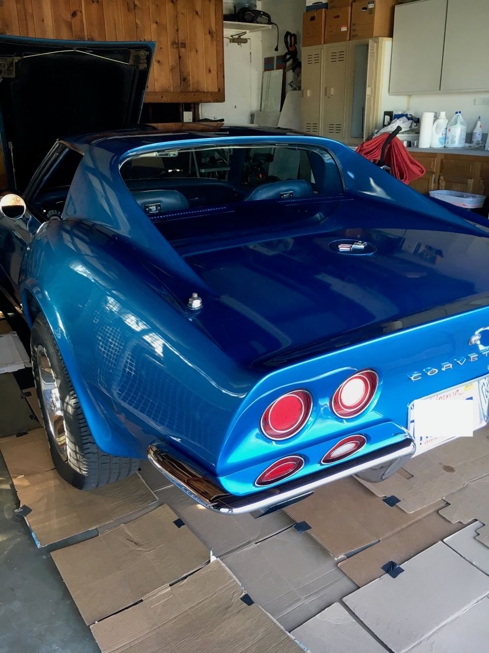

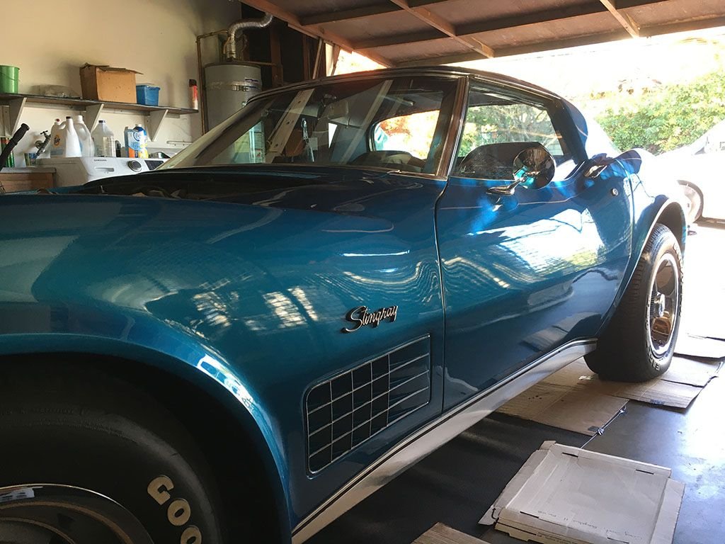

i think she's a beauty. I receive lots of thumbs-up and compliments when I take her out.

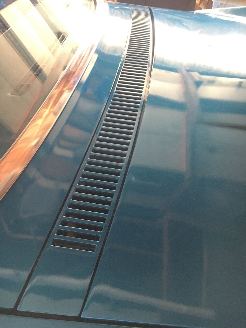

vacuums on the wiper door and headlamps work great!
i love the color - exterior and interior. I'm very happy the body and exterior paint are in excellent condition. I have the antenna - it's just off since I keep her covered in the garage

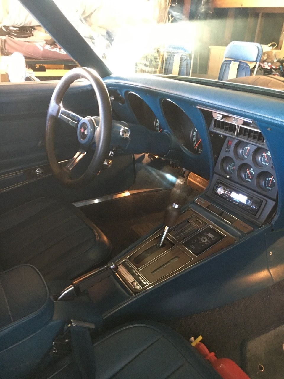

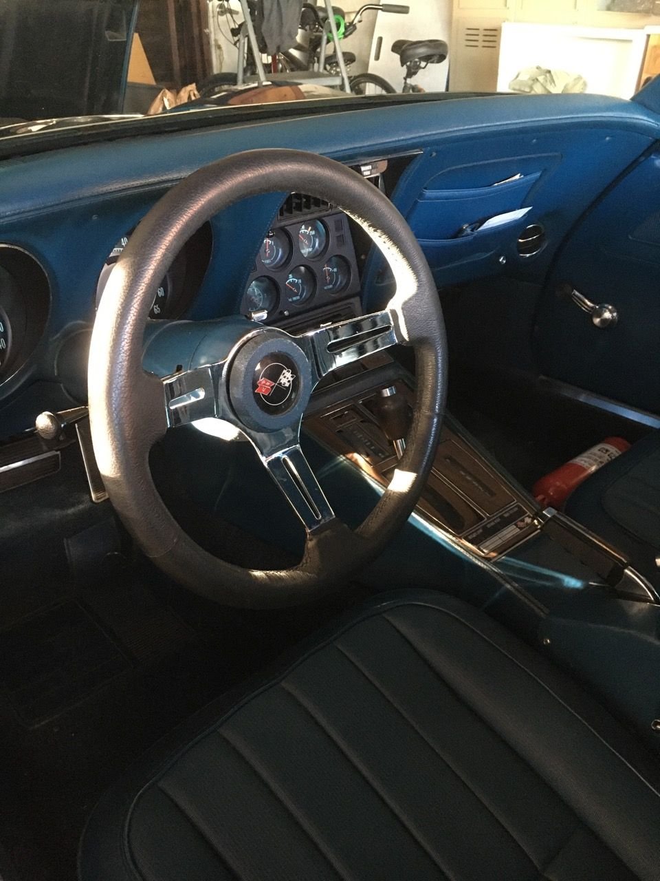

i do have the original steering wheel. The previous owner said he didn't like the larger wheel. This one does feel good when driving, but I'm considering putting the original back on. Carpet and seats are in great shape
i initially set out looking for a manual, but after driving the automatic I think that's a good thing considering the heavy traffic in LA. The cushion on the e-brake console seems like a modern replacement/add-on?

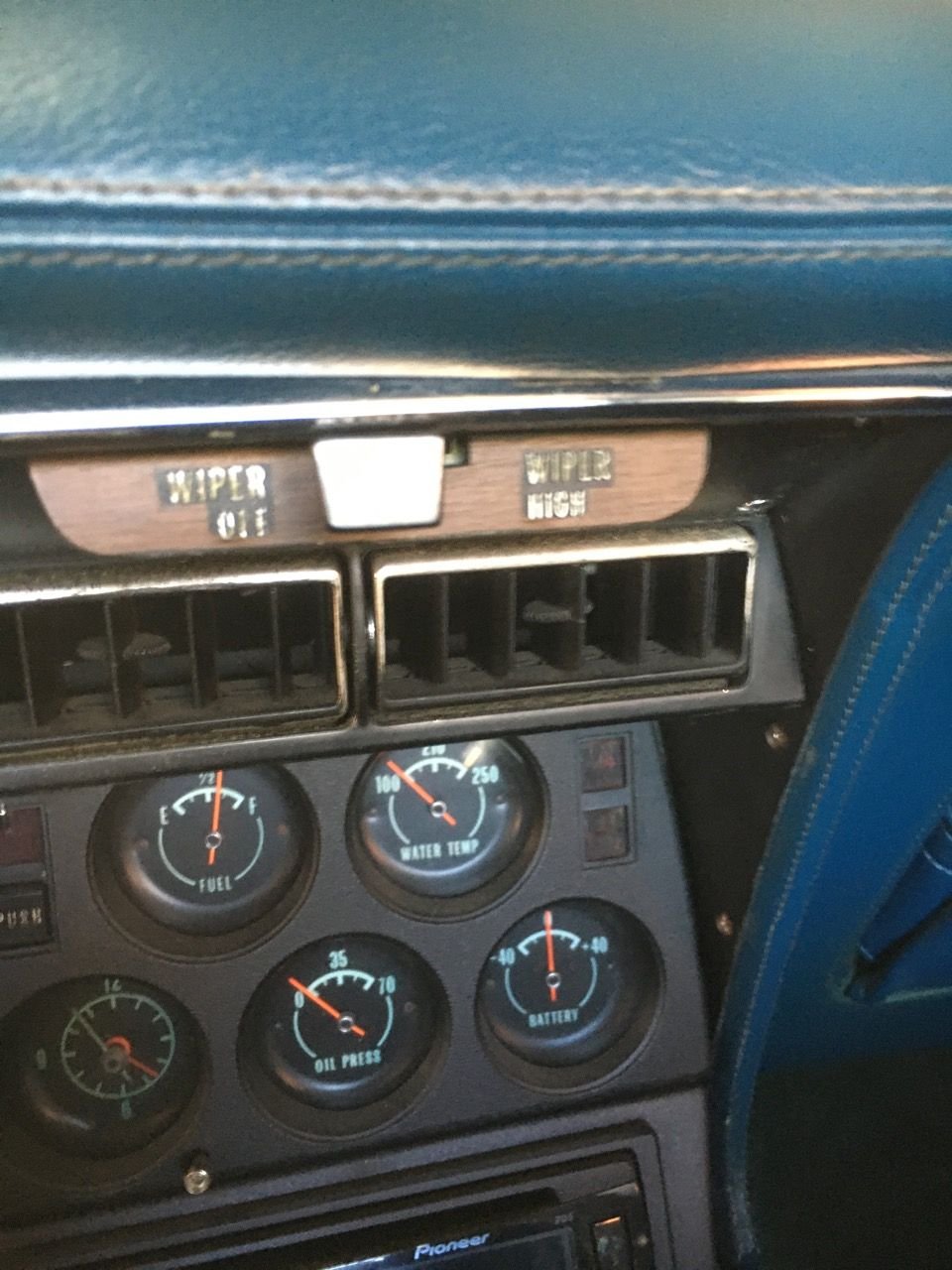

i'd like to repaint and clean-up some of the faded lettering. My temp gauge doesn't seem to move - even after driving for more than a 1/2 hour. Could that be a thermostat issue? Something else?

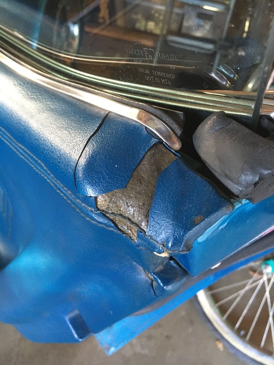

Below shows some interior wear, and I wonder if any of this can be REPAIRED, or whether I'd have to REPLACE parts. I'd prefer to repair rather than replace since it involves some large parts (e.g. entire inside door panel, pillars, dash). I'm looking for advice and wisdom on whether patching cracks and missing sections is doable?

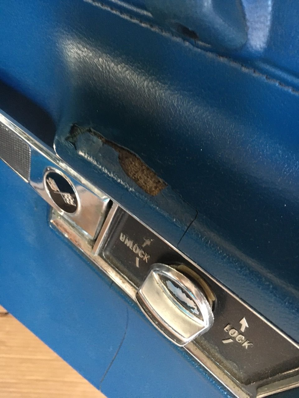

passenger door cracks and missing patches. ***** and lettering - more repainting and cleanup to be done

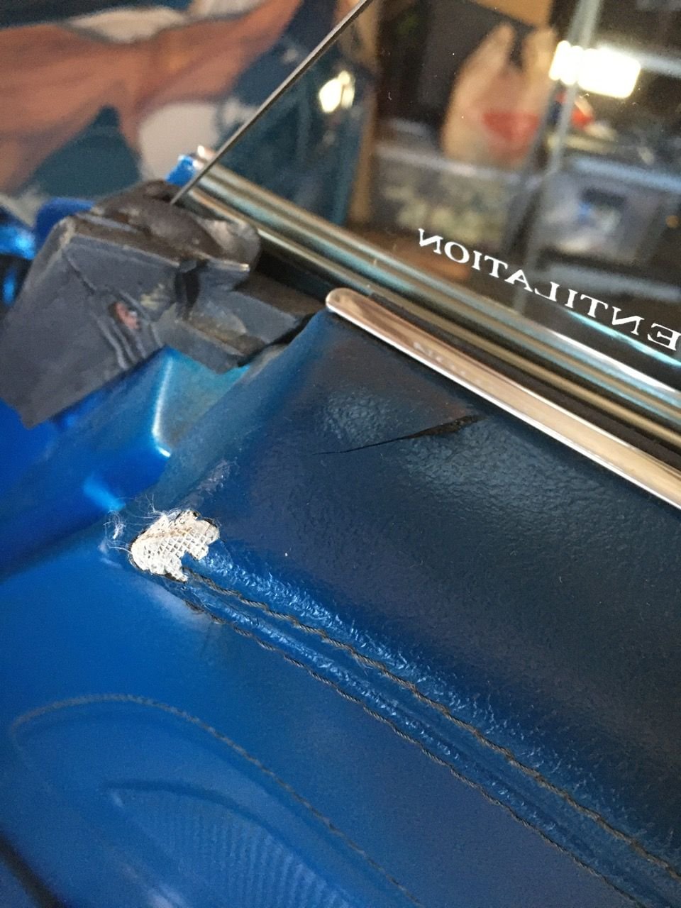

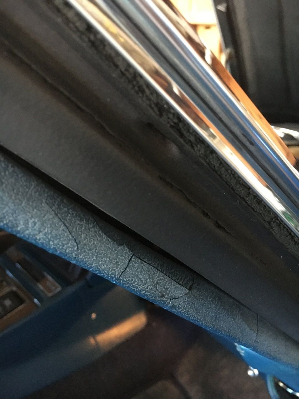

these smaller cracks on the passenger side pillar - maybe easier to repair than the larger missing sections? Looks like the weatherstripping could use replacement. Some rusted and missing chrome, but not too bad

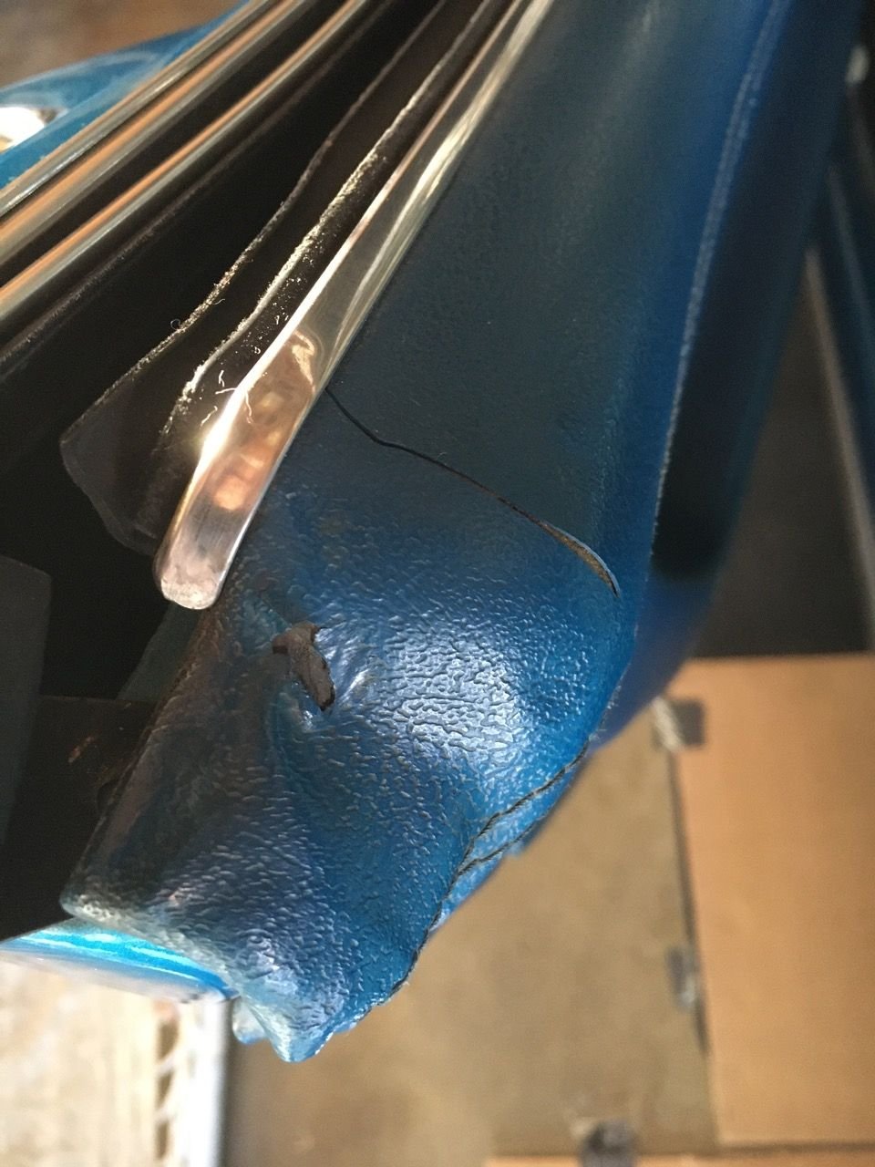

driver's side interior door panel cracks

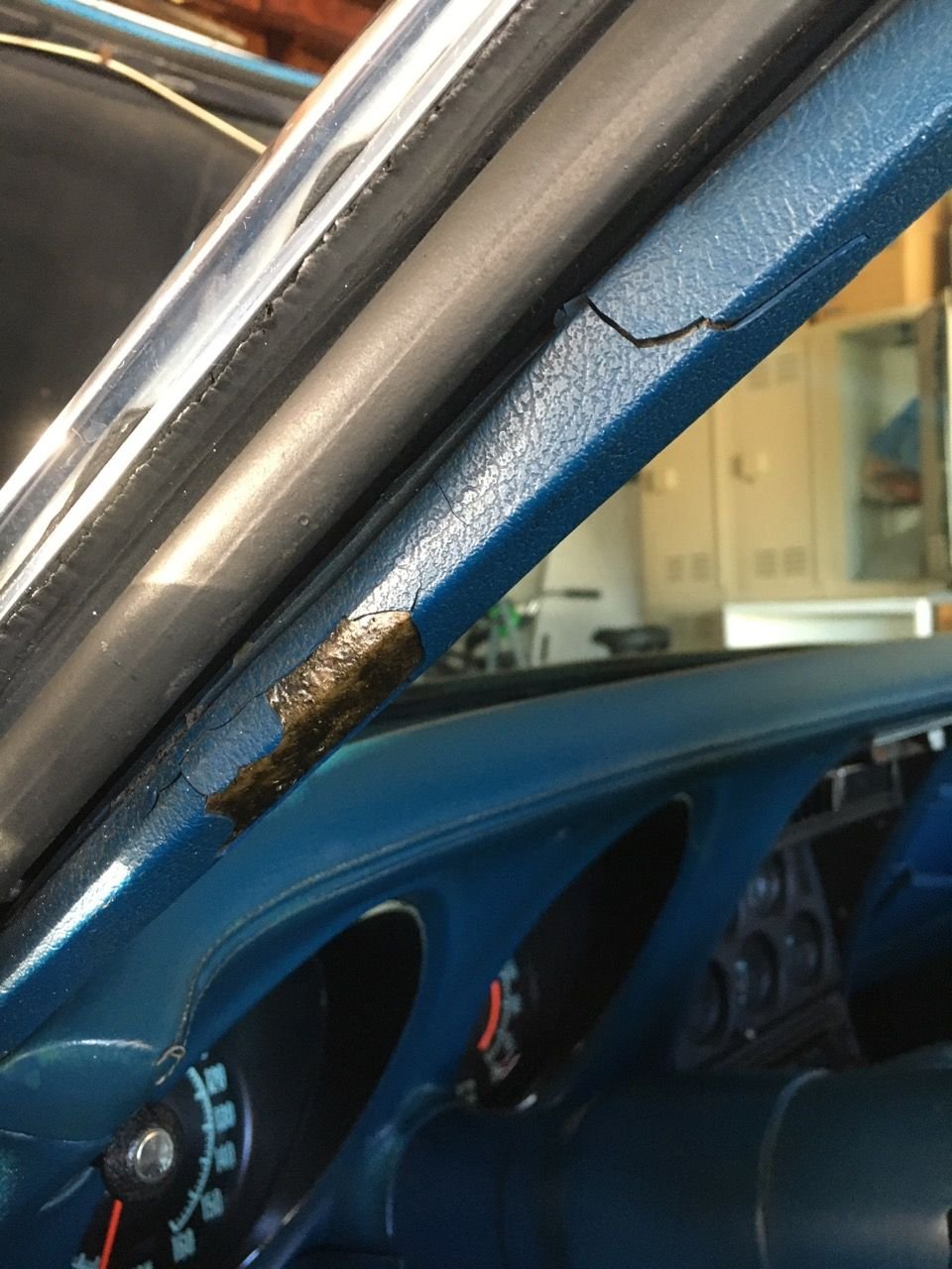

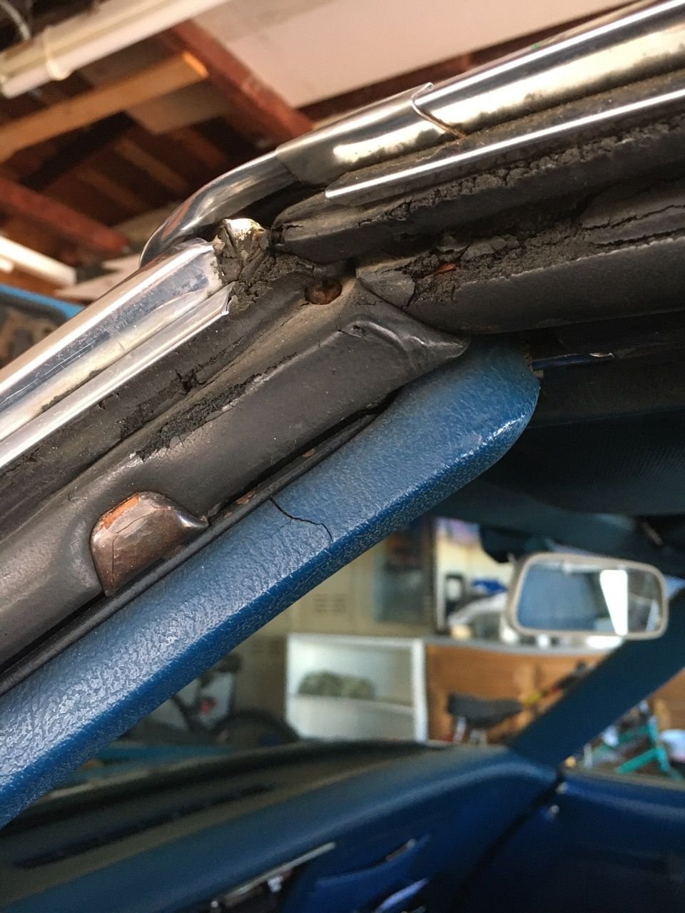

driver side pillar has significant wear; missing patches
...and weatherstripping looks quite worn

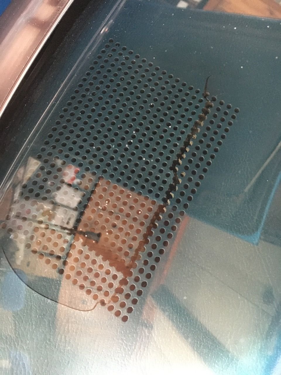

pretty large cracks on the dash speaker grill

One option for your original steering wheel if you don't like the feel of it is to have it wrapped in leather. That's what I did to mine. The plastics in the wheel were breaking down a bit and so it always felt a bit sticky to me. Wrapping in leather solved that problem and is more comfortable on the hands.
The temp gauge might be an issue with the gauge itself, the sending unit, or the wiriing. There are some threads on here regarding testing the various gauges. If you don't find what you need with a search, just create a new post about your gauge issue and someone will be along to help.
In regards to repairing your interior pieces, you are looking at a total frame off restoration. Okay, that's a joke but not too far fetched given some of the experiences others have had with these cars. You'll find that once you start a project, it typically leads to another before you can finish the first. Seriously though, I'm thinking you'd be better off with new interior pieces given the amount of damage to your originals. I did some minor repairs to my '73 using one of those vinyl repair kits but my interior is black and the repairs were in an area that wouldn't be very noticeable anyway.
It does look like you are in need of weatherstripping. Note that some vendors supply better quality weatherstripping than do others. CRC weatherstripping is good. Contact Willcox Corvettes (one of the approved forum vendors) and they can fix you up.

Your temp guage maybe a wire off the block sensor. Drivers side, a single wire connect to the sensor in the area of the spark plugs

So far, looks like most/all of your To-Do List entails items that can be done at your leisure (nothing safety or mechanically risky in nature).
I have that same replacement steering wheel, and I do like it better.
The stock wheel is thinner and harder on the rim to grip, so it made for uncomfortable cruising.
The larger diameter also made a little more of a thigh squeeze to get in and out.
Down side of the smaller wheel is a minor increase in turning efforts, also a little more gauge obscuration.

Temperature gauge: Check wiring to the sending unit first. You'll find the sender on the LH cylinder head. A single wire with asphalt insulation runs from the sender to the gauge.
