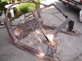

Here’s a birdcage picture.

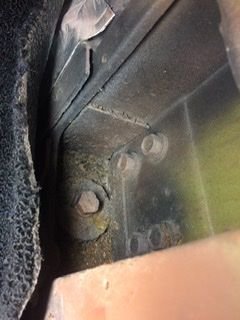

The body mounts behind the drivers and passenger side kick panels are also a good place to look for rust. Good luck and enjoy your search!
C3 birdcage.
Here’s a body mount shot from our ‘72 Coupe.

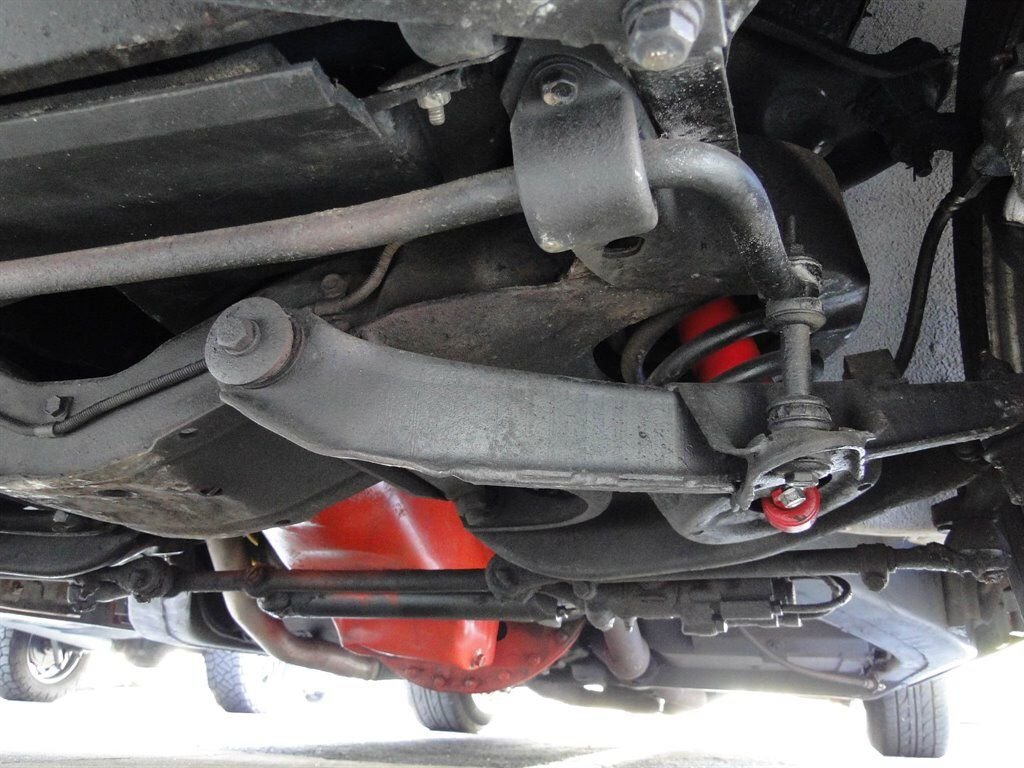

Take a close look at this when you get a chance. May be nothing but worth checking.
