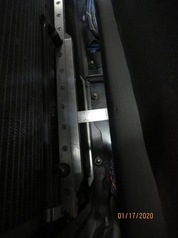

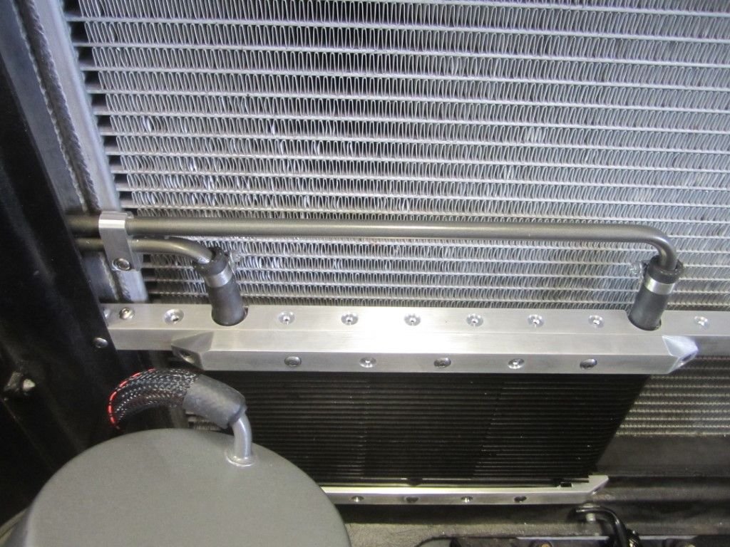

I used a 70264 (because that's what I had)
11" x 5-3/4" x 1-1/2"
Seems to work well, at least no issues. No gauge so can't give number differences it mades
M

Nice set-up. Your hood doesn't hit that when open?

Thanks
Lots of room (well at least in vette terms)
It's down as low as possible. Couple of inches when the hood is in the latch position and still well over an inch when pulled all the way open
M

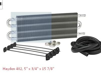

If that B&M 70264 (11" x 5-3/4" x 1-1/2") keeps you cool then I reckon this Hayden 402 (3/4" x 5" x 15-7/8') oughta be sufficient also?
I don't want to deal with that hood issue and the Hayden 404 that I do have (3/4 inch x 7-1/2 inch x 15-7/8 inch) just won't squish in......
