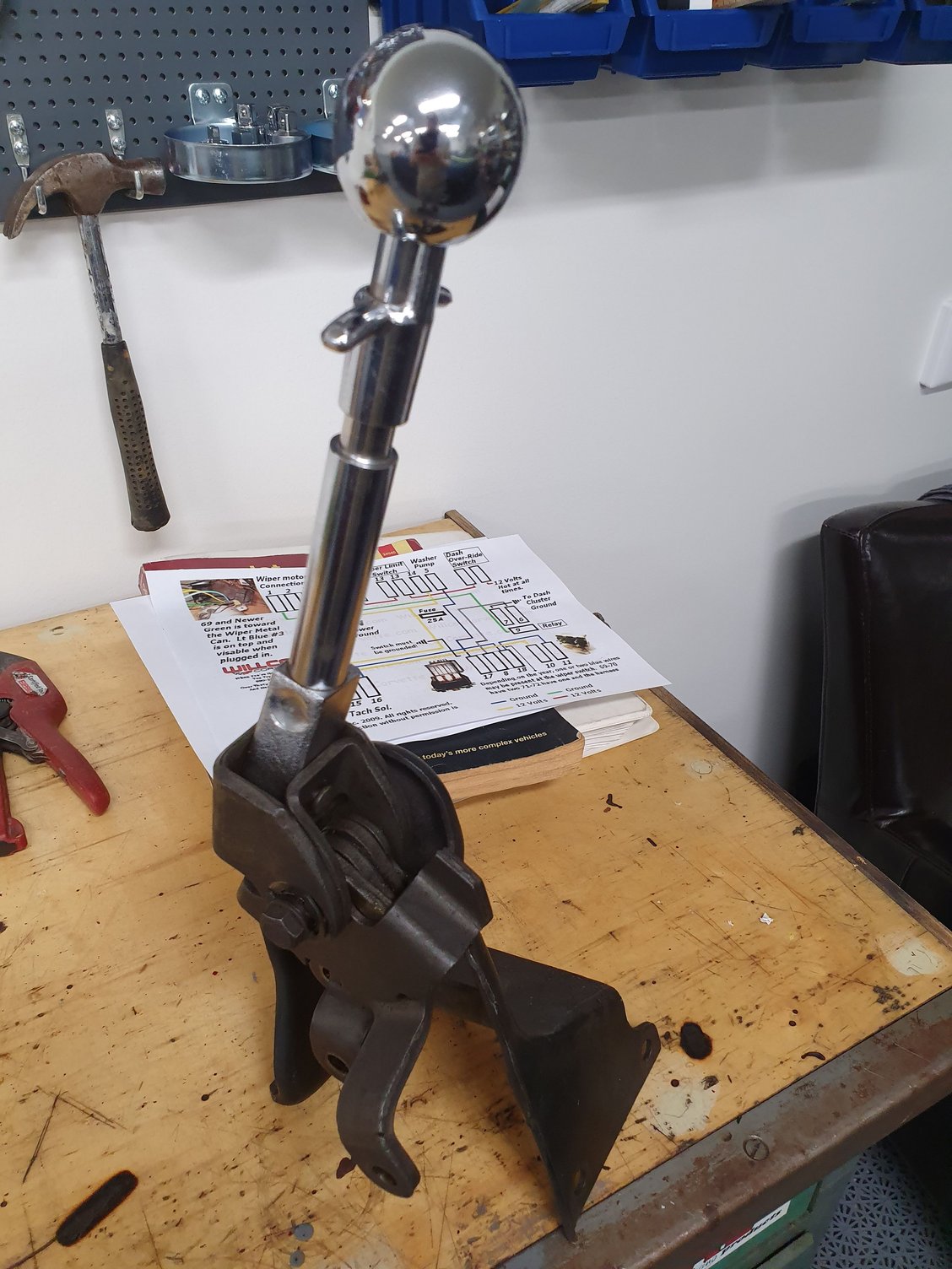

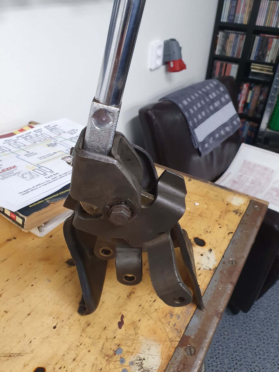

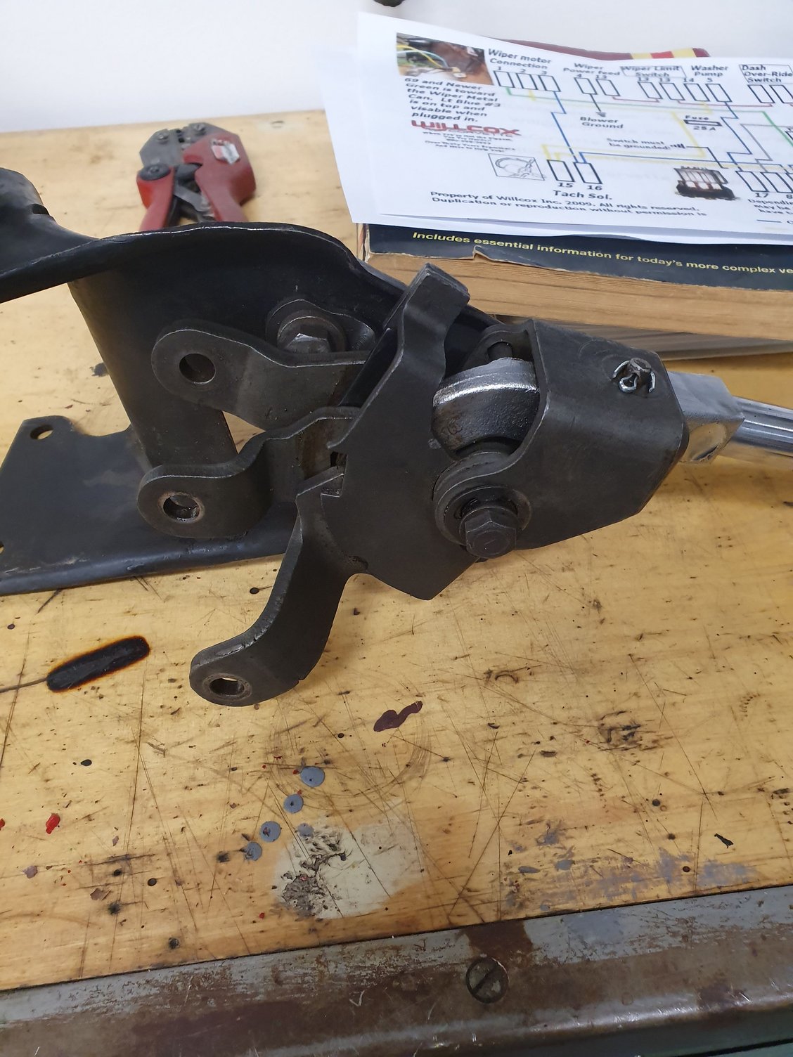

I bought this for my 72 4-speed muncie. I hope it is the correct one?

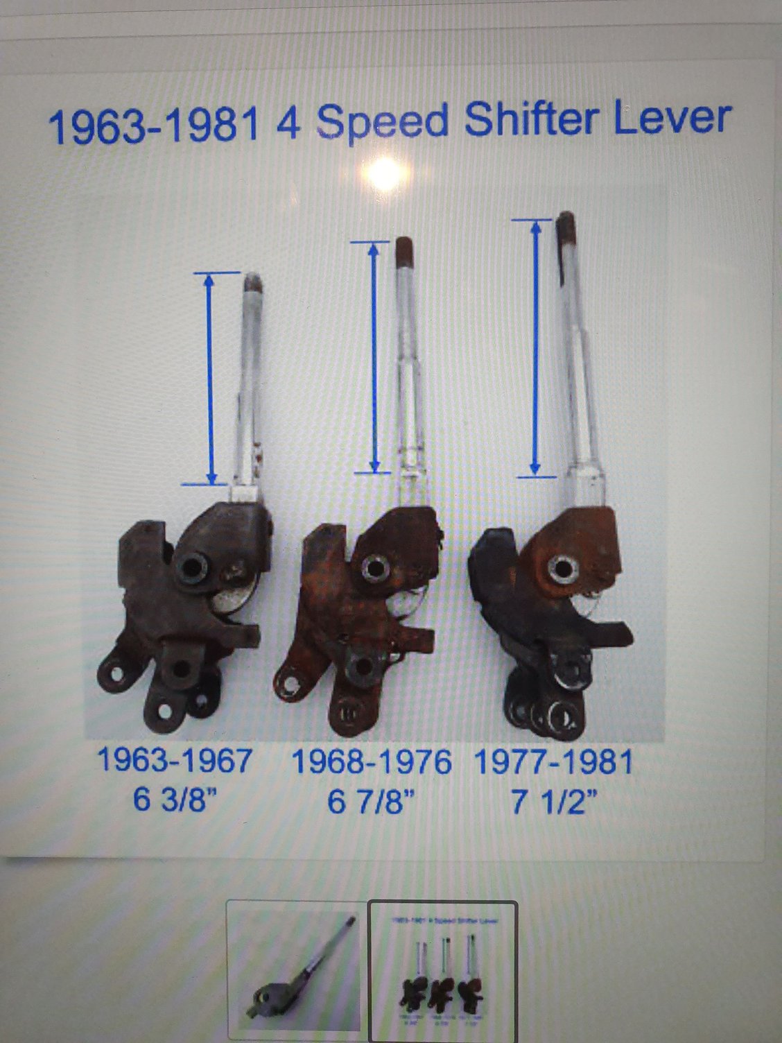

I answer my self 😜

Later model C3 Corvettes have bigger sticks.!!!

That information is flawed--the 63 shifter is nothing like the one they describe as 63-67.

The correct shifter ball is the black chrome one.
