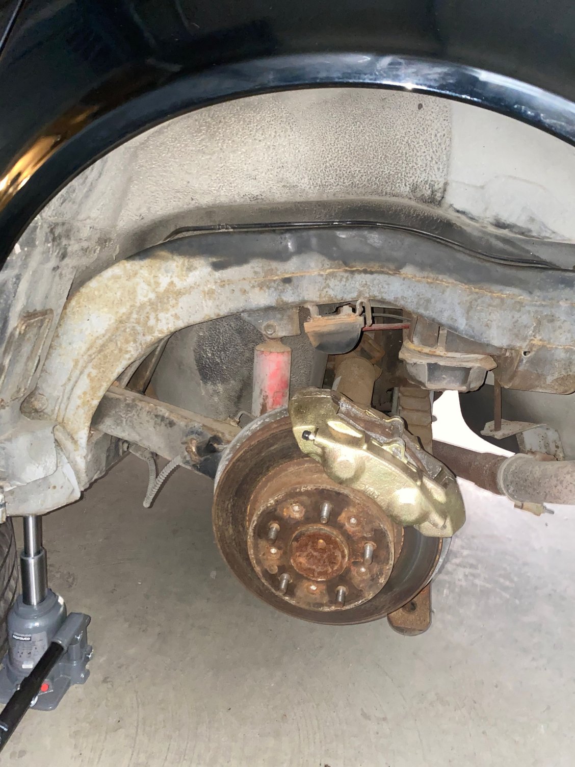

Thanks Duke94 for your help, unfortunately i searched for the VIN number where the post mention it, but i couldnt found it there, in the foto you send me before there is positioned just in front of the tyre ( the external side of the rail) drivers side (american drivers side) the photo is from a 79 model?, but in the post you re send to me the position should be on the top of the rail, In any case i search front and upper side i couldnt found it. im sending a foto of my chassis maybe you can help me by signaling where to search, or do
you know if there is another place where the VIN ca be?

Well Salar, I pulled the left rear wheel on my 79' and just like you found, no VIN number there. Will look some more.

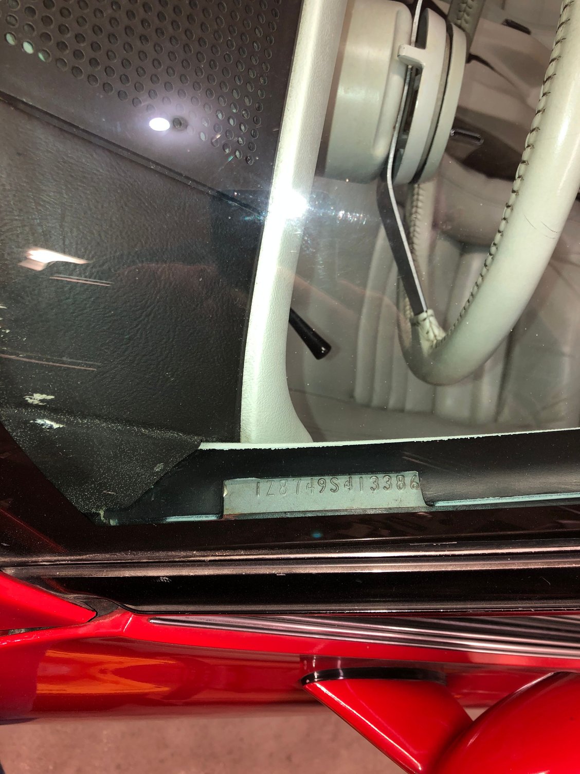

The vin is also on the LHS pillar.
yup... i tried to take a pic behind tire.. no clue if its there and not removing to see until need to
