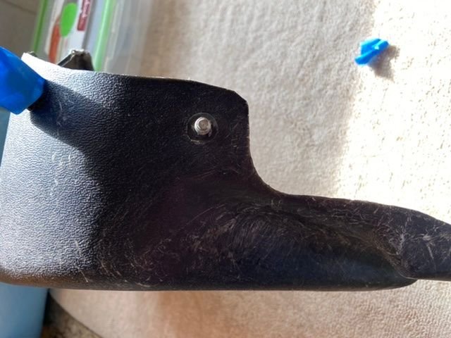

I’m detailing my engine compartment and painting the distributor cover there’s a bolt attached on the cover anyone know what’s supposed to be attached to it right now the cover is just sitting on the distributor
thanks in advance
Here’s a better picture

78 ground strap with wingnut

Is that ground for the radio interference?

Basically, yes... that was the purpose.

? Is it assumed the black plastic ignition shroud is molded with some integral conductive metal/mesh/particles ?

I was told there's a foil lining of some type on the plastic covers.

Its a "tin foil hat" on the inside.

Yes it has a thin aluminum sheet on the inside
now I know were that ground wire that was just laying there goes although the radio has been replaced
