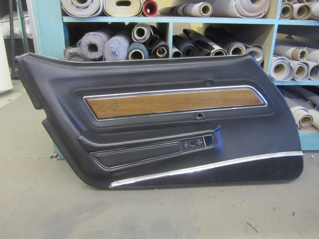

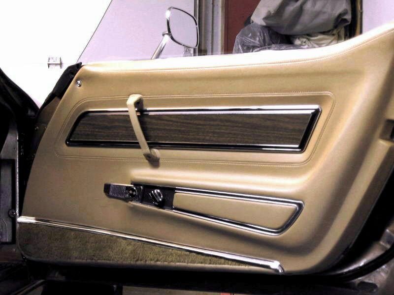

Are you talking about this? My 75.
I replaced my originals, really ratty. and they were done with staples. No staples on walnut trim.
The repo replacement used an adhesive at most spots. The walnut trim and the carpet trim holds down the edges, as does the other trim on the door.
The walnut trim does have studs, IIRC, but this was 20 years ago.
I suppose you could staple in some places, but not sure.

I don't think I would staple into the plastic because it might crack. I would use something like a 3M Adhesive to hold the bottom edge in place for a long time, and make the fold long enough to get a good grip. But if you notice in my first picture there is is a piece of vinyl edging over a bit of the carpet at the bottom edge.
And now that I think about it, the carpet did NOT fold around the bottom of the door, it sits in that indentation between the chrome and the bottom. And it IS glued on I think,,,,
Do you have the chrome strip?
Note that they have a stud which would hold the top in place.
Sorry I don't have a picture of the back of the panel. But the ones I got were more like a hard composite rather than plastic. But that was 20 years ago.

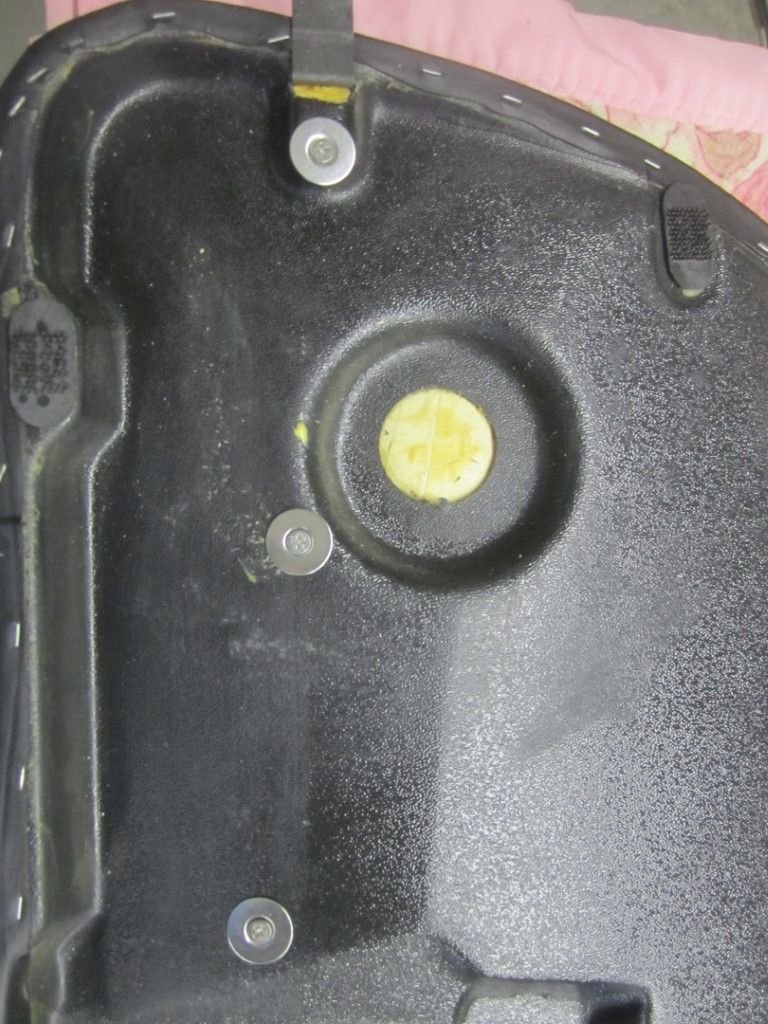

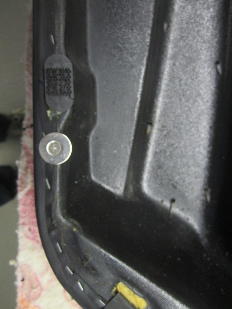

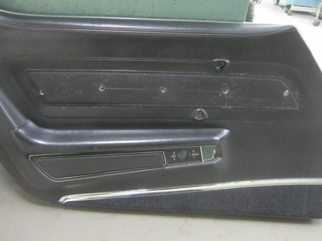

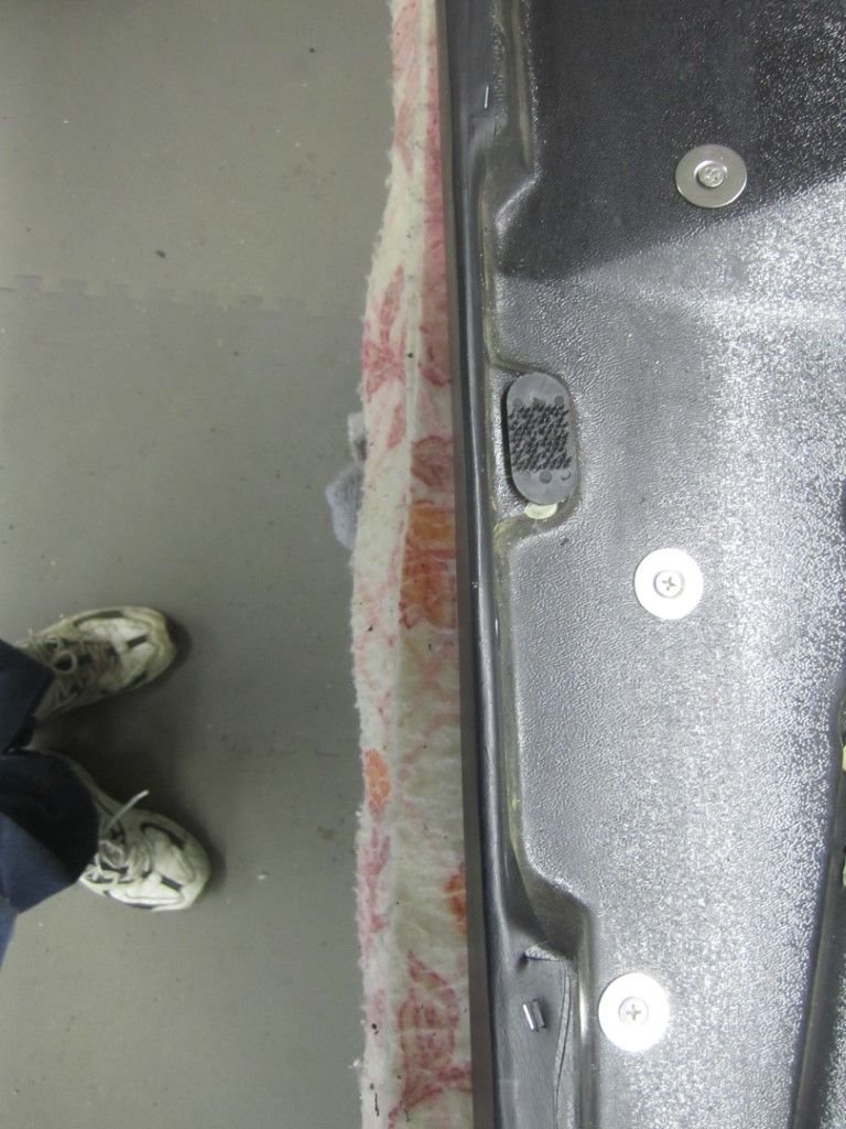

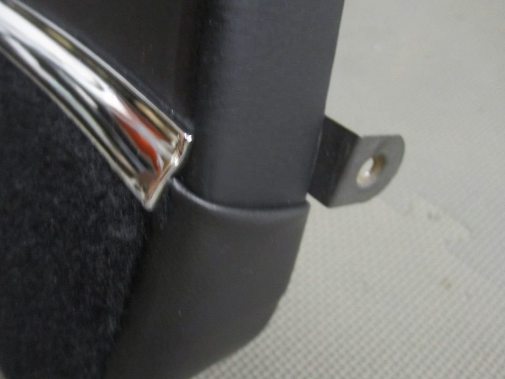

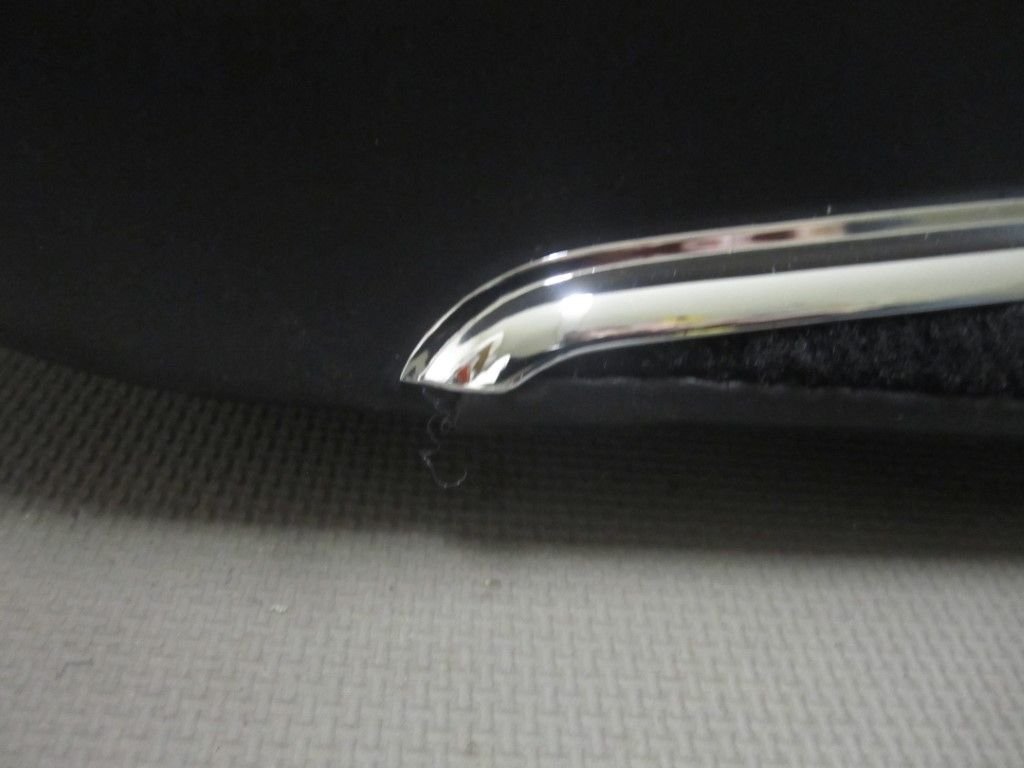

Stapling into the plastic isn't a problem as long as you're using fine staples. Bike and snowmobile seats are all plastic and most are staples from the factory. My one brother is an upholsterer and does them for years without issues.
Here's some pics of how my re-pro skins have the carpet / vinyl installed, not sure if it's factory perfect but it looks tidy
Careful because the new carpet was no where near the same size as the original ones so we fit the chrome bar to suit the door panel and then trimmed the carpet to fit where the bar was going to be
M
We also added a little bit of 3m adhesive where the panel is concave otherwise it would be baggy in that area

Thanks, that’s what I was needing to see. I do have the chrome strips. What was on the old panel wasn’t factory so really don’t have anything to compare to so I plan on test fitting everything before any permanent finish.
