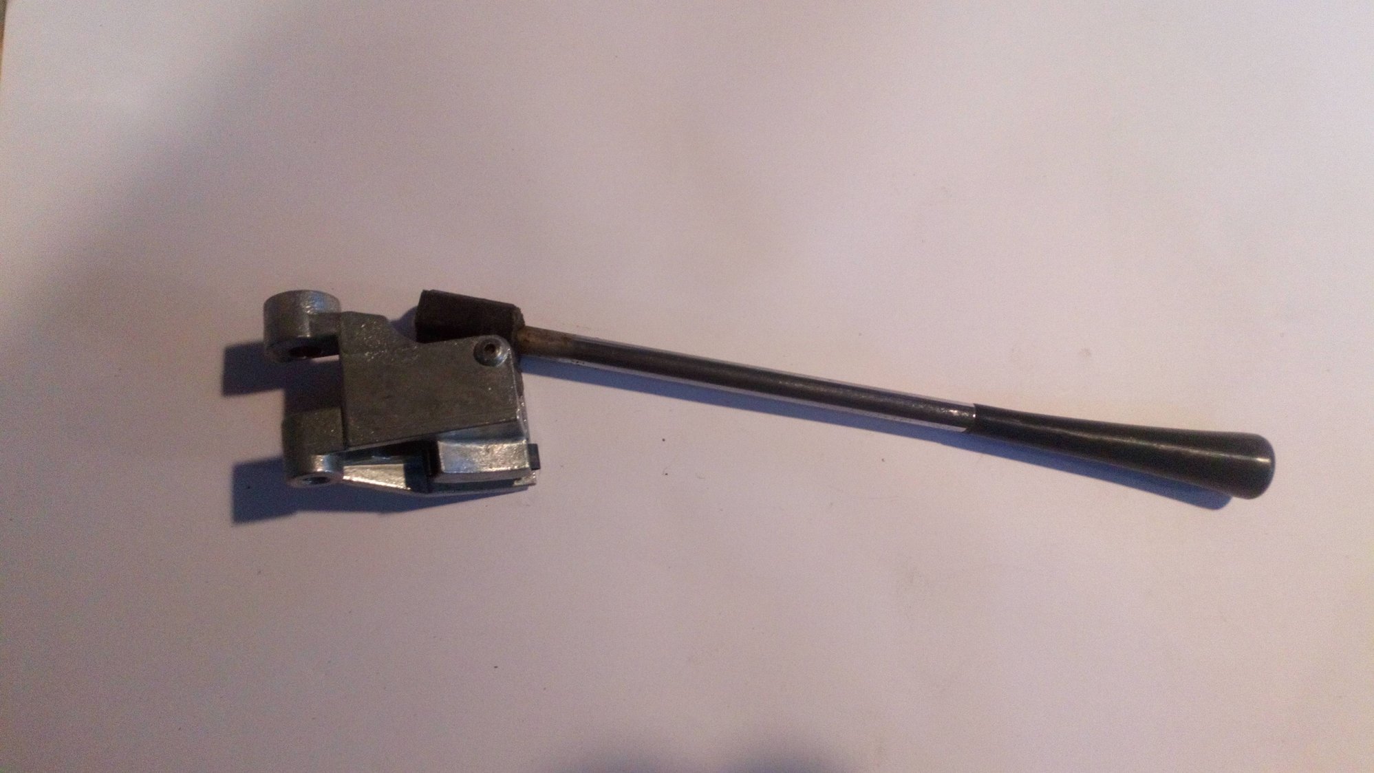

Finally got the shroud off my 79 tilt and teli steering column.
The dip/main beam pivot has broken and it either needs replacing or welding. I have an idea that it will probably not weld up as it is a cast aluminium piece and has broken where it is particularly thin.
I know that this is no longer a part that GM supply but someone once gave me a contact that has reproduced them, can anyone shed some light on who or what company might be able to sell me one, unless someone has a spare they wish to sell.

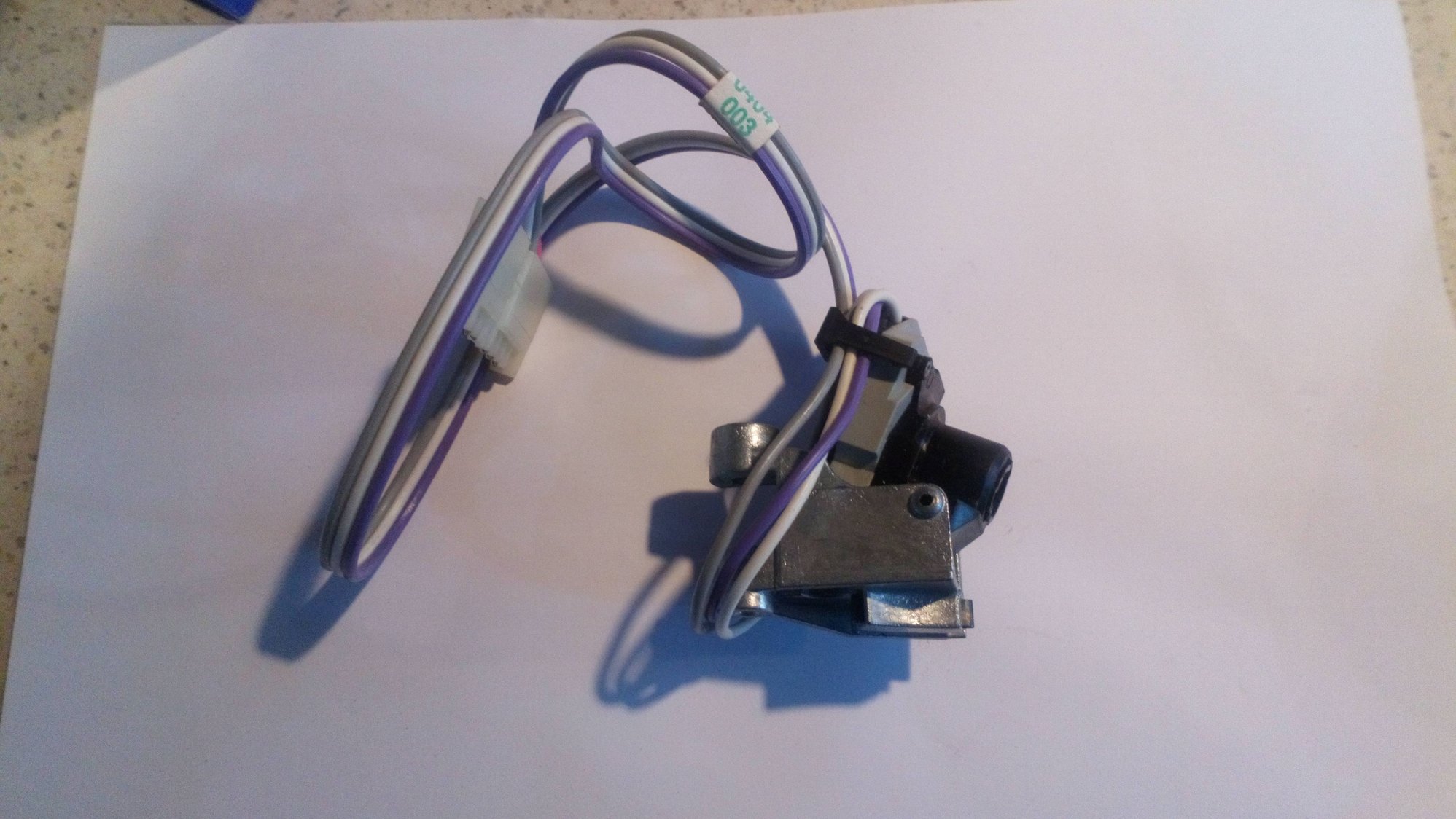

Is this the part you're talking about? Also, is it pinned or bolted to the steering column lock housing. The photo is of the 2nd design pinned. I don't have this part, but if it's just the bracket part that is broken I may a few GM part numbers of switches the bracket could be removed from and used on your 79.

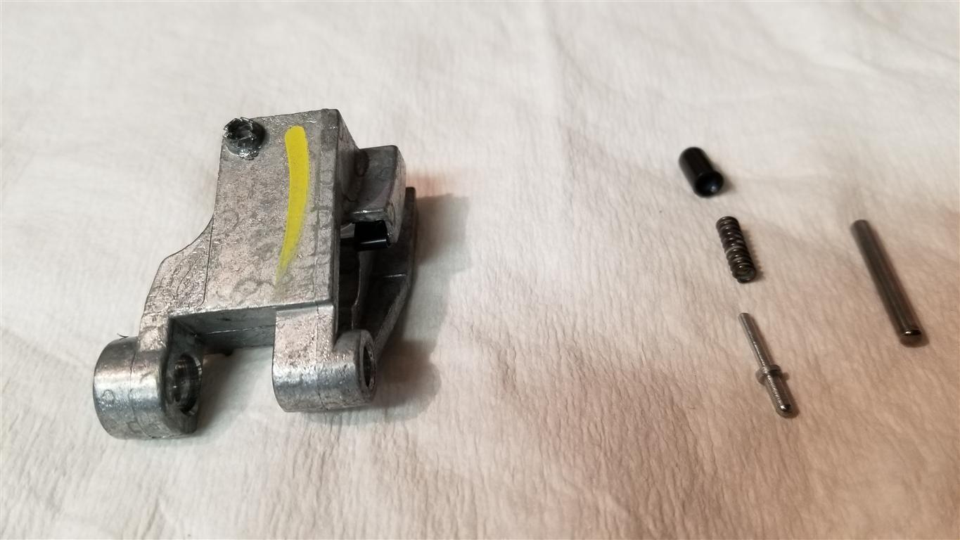

Inside your plastic dimmer actuator there will be a small double sided pin, spring and a plastic end cap. Make certain "IF" you remove these they remain just as they came out. You need to use them again as they are the correct components needed to hold your turn signal lever in the socket.
The end of the bracket that the pin pushed through will mushroom out a little, when you reassemble the new bracket simply peen that mushroomed part over the solid steel pin.
This bracket is a little stronger then what your 79 came with. GM used these brackets on a lot of Tilt columns over the years. Your only reusing the metal bracket part, toss the wiper electrical.
I have no interest in the sale of any of these items LINK: https://www.ebay.com/sch/i.html?_fro...31417&_sacat=0
Plastic actuator and or switch removed your bracket and inner actuator pin, spring & cap will look like this.

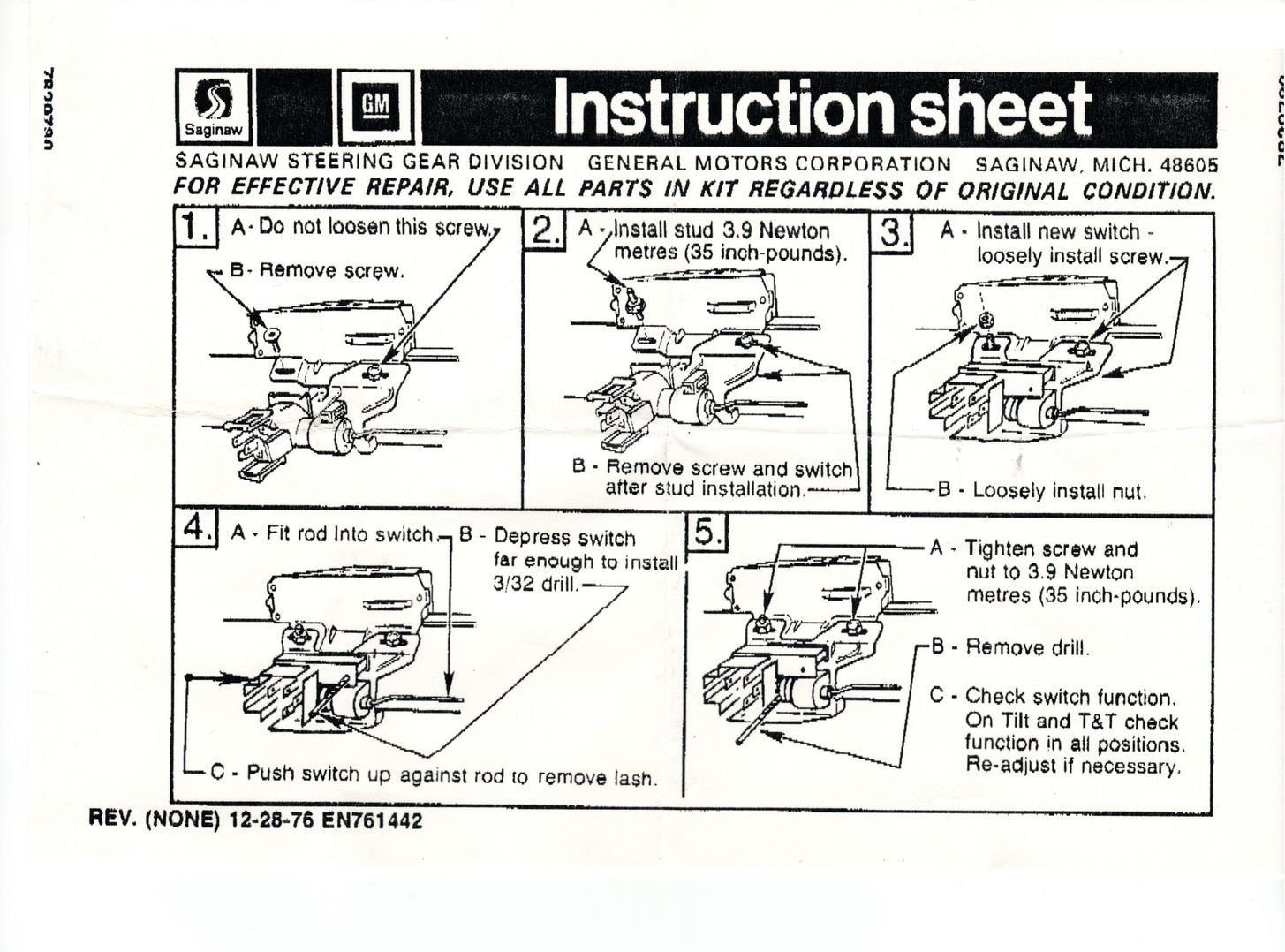

I will also add this, Once you replace the broken pivot bracket you need to check the position of your dimmer switch for the correct setup.

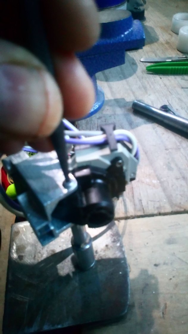

Use a 1/16" punch so it just strikes the pin not the casting leaving the original form of the bracket as a stop when you reinstall the pin, take your time, support that area over a deep socket or something (a extra hand always helps). It will take a sharp blow to bust the pin through the casting but not excessively hard. Once through a little the pin should move easily.

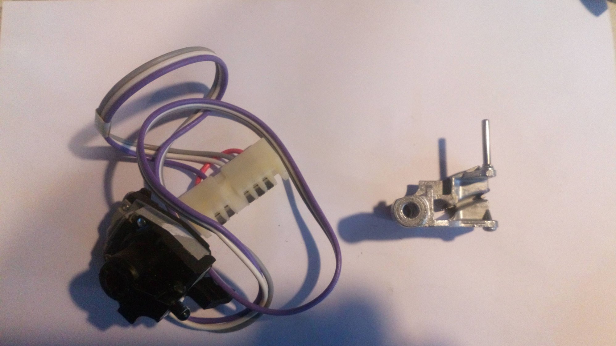

I then removed the pin to release the bracketry that I was after.
I was then left with this, bracket on the right and everything to the left in the bin.
