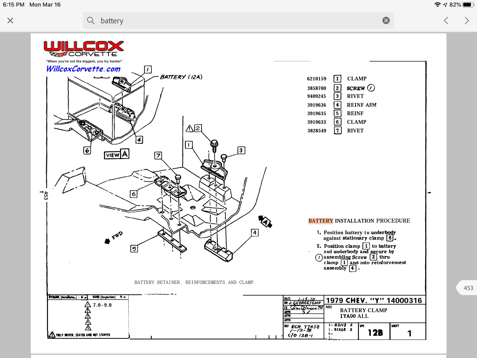

Can you post a picture? This is the correct part, not the larger plastic piece you might see at AutoZone. It has an up side and a down side, and applies clamping pressure to the back of the battery.

i just fixed mine last night since i got it! Cleaned it out..not sure if same as 79 but...
thought my battery didn’t fit either til i figured out i had clamp backwards..holds it now..op had it backwards.
