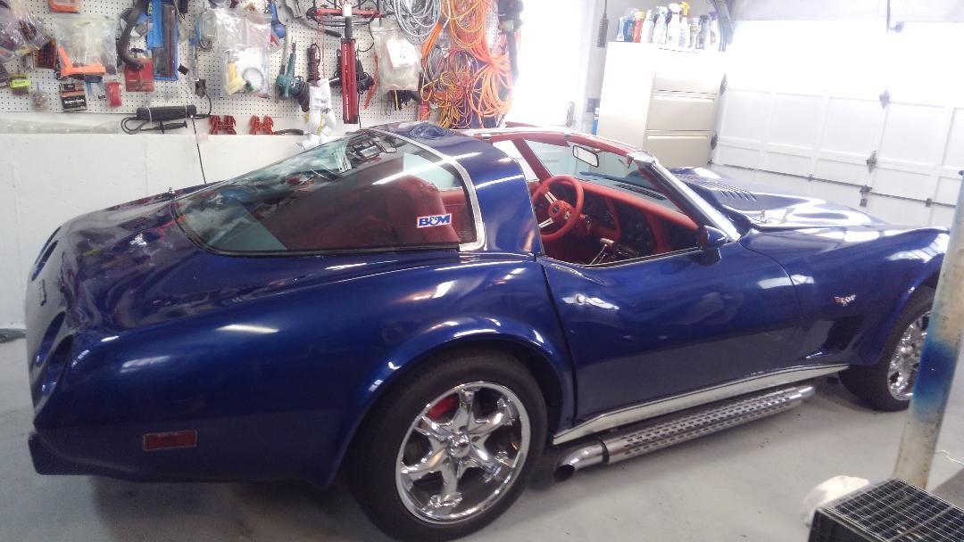

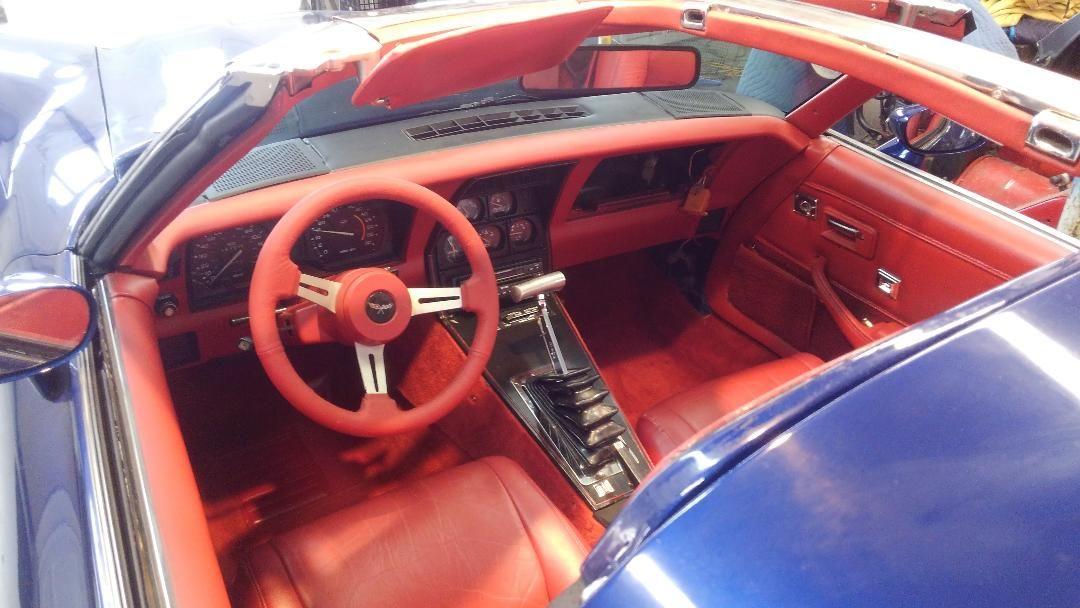

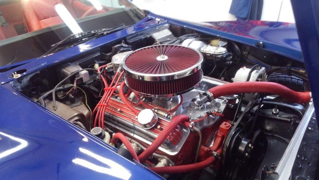

Attached the frame off Resto I did. Mostly original but also has Edelbrock Cam and Lifters, Vortec 906 Heads, Headers, B&M and Holley Demon Carbon Fiber Carb. Paint is 2017 Corvette Admiral Blue (Paint code GTR). The Glove Compartment is back in (not in pics). I needed a new distrib on the rebuild and found some guy selling this one. It looks cool at night when the engine is running you can see it throwing spark.

I'd still remove it...Those kill switch relay set-ups were designed to mount under the dash- not in the engine compartment. You can plainly see the relay socket is not made of a heat resistant plastic. And the wire is a PVC type not designed for high temp/under-hood applications. Way too nice to burn up.
