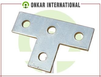

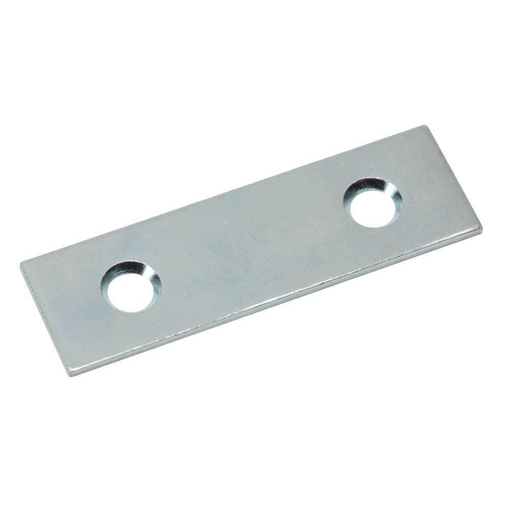

Get a small flat piece of metal- bracket from Home Depot/Lowes will work- drill a couple holes- the potmet is easy to drill. Some nuts and bolts- done. If it makes you feel better- put some JB weld on the crack/break.
***EDIT***** you are missing the piece- then a "L" ot "T" bracket and just connect the spring to it-******

And that is why I came here! I do not have the piece but love the idea of getting an angle bracket!
Thanks!
