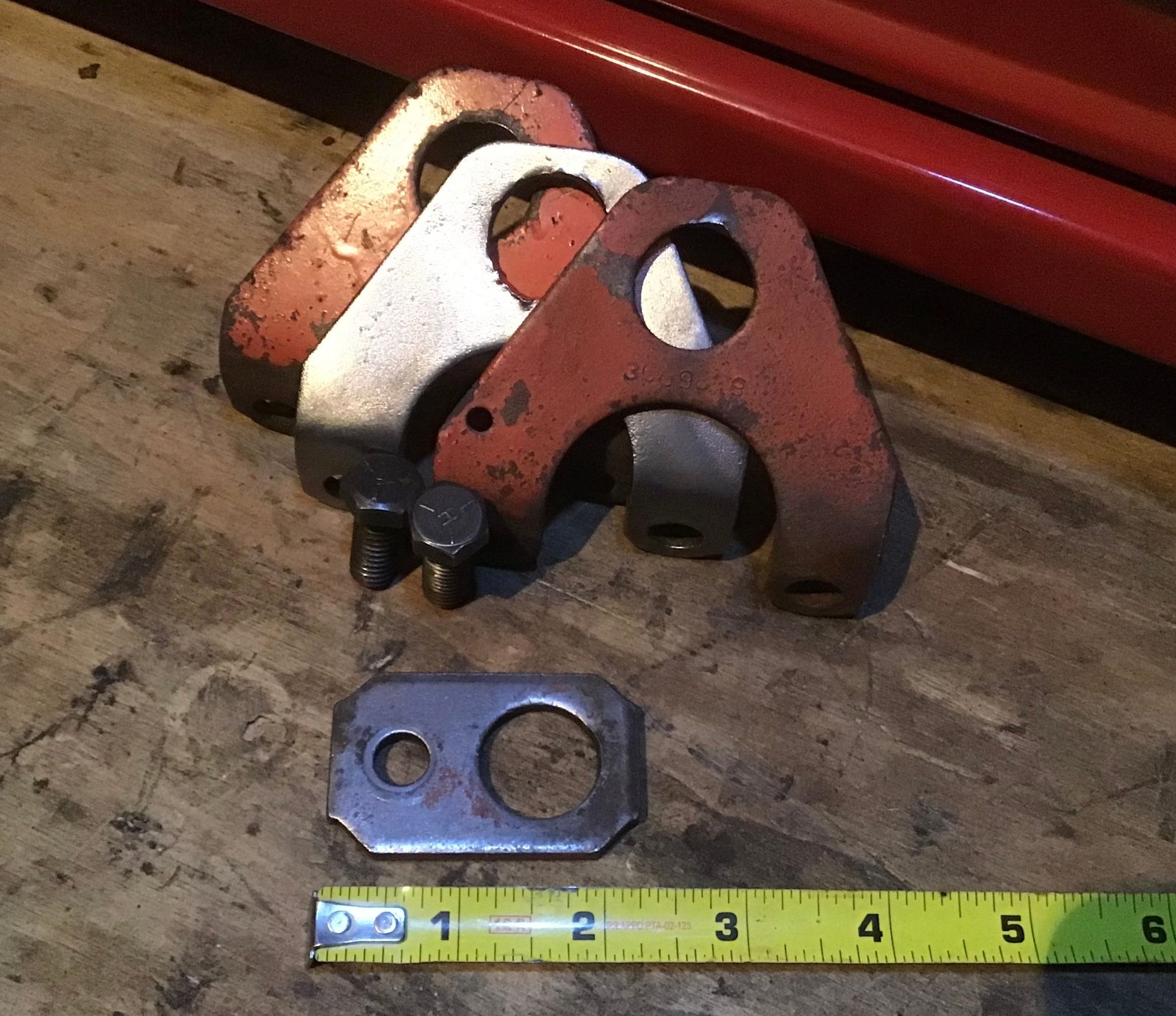

The rear lift bracket is the same on all big blocks in 1969. Here is a pic of the front triangular bracket as well as the smaller rear bracket in front. These are all original brackets as well as the bolts which are either head marked M or H and there may be other head marks. The rear bracket is 2-1/4 inches long.
I believe they make a good repop of both brackets. However, you may have to buy two sets from two different manufacturers. One maker makes a nice front bracket but incorrect rear bracket and the other company makes a good rear bracket but poor front bracket......

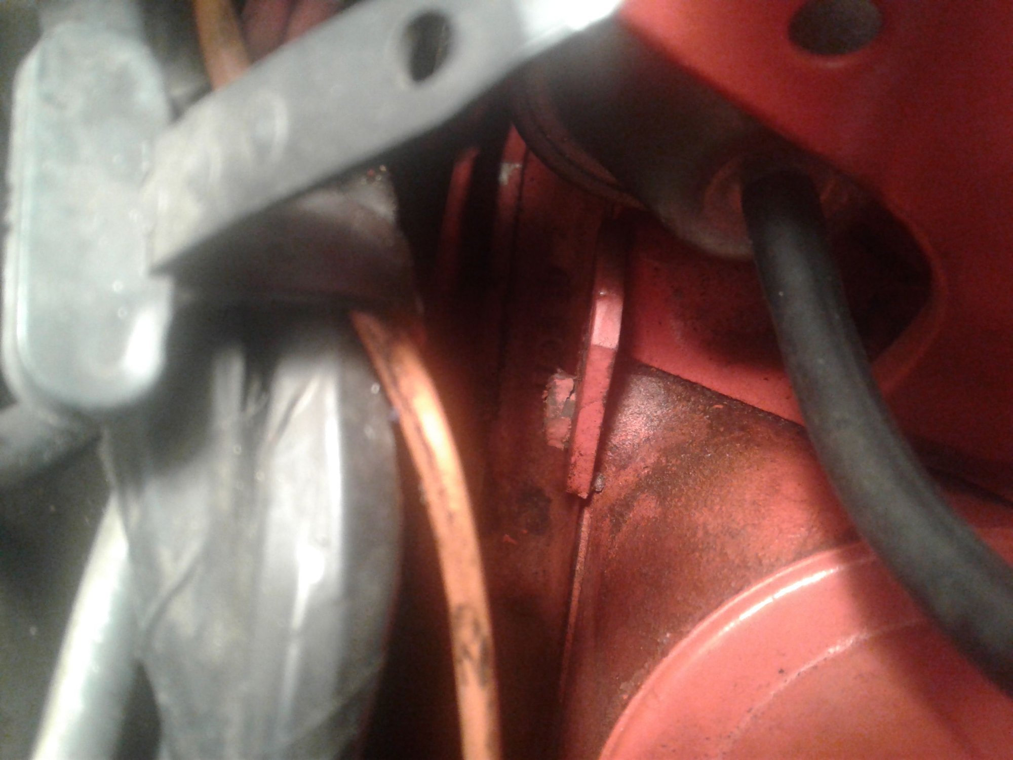

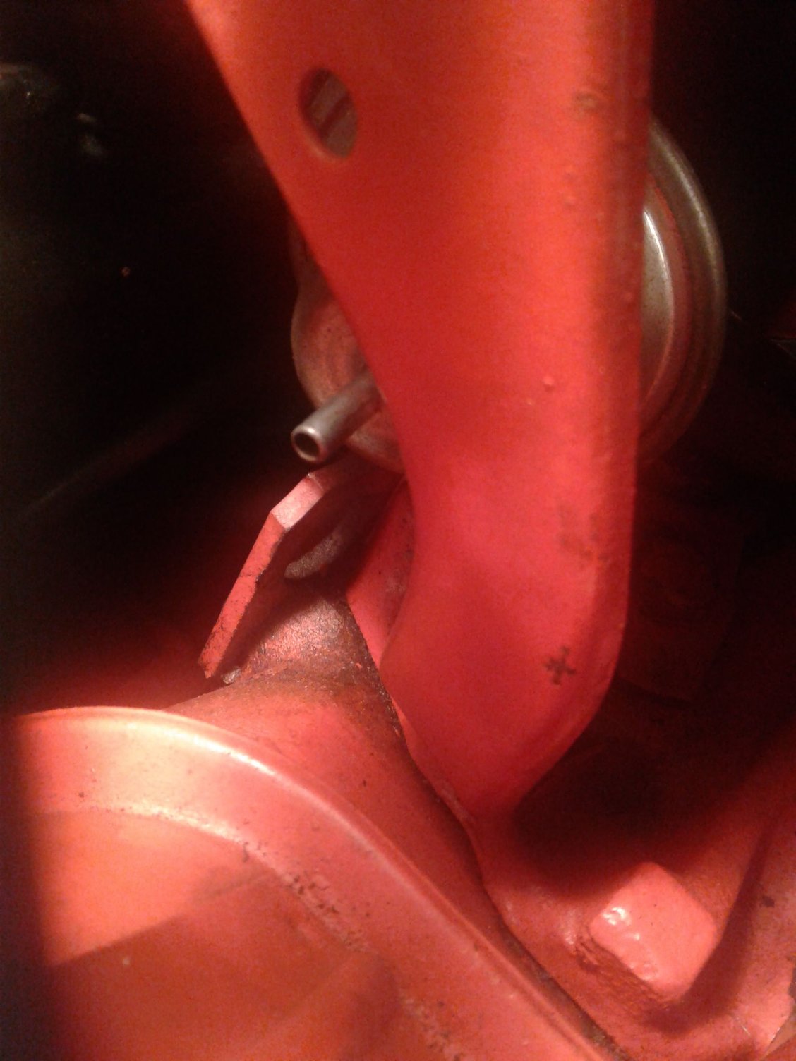

Here's a picture of the rear hoist bracket on my '71 BB.
To rear BB engine lifting eye question
