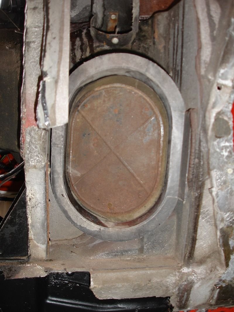

In my '69 coupe the vent doors (and I am pretty sure nobody touched them till I did) were spring down on the left/driver side and spring up on the right/passenger side.
Are you sure that the seal is still complete and in place?

Thanks for the photo GunPowder, shows me that I don't have the foam seal. looks like I have to get some foam and make a seal.

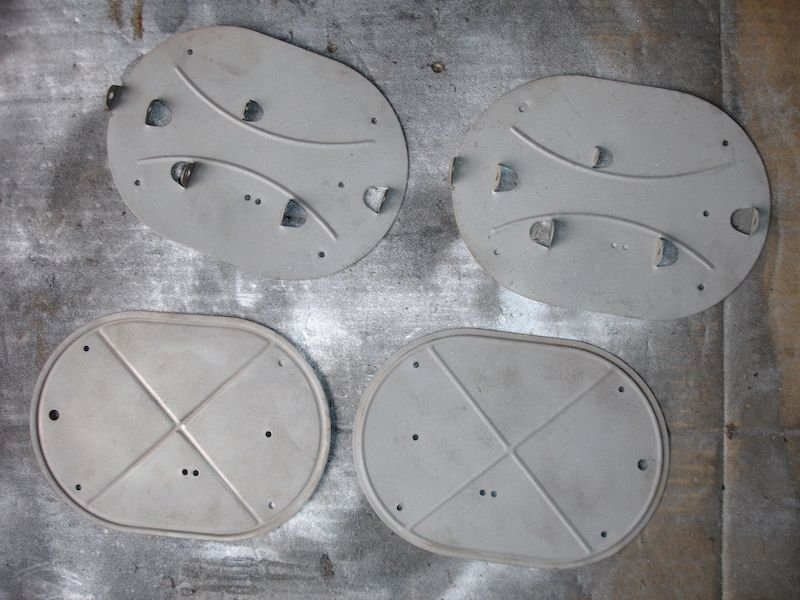

Easy job to make the foam seal, but they are also available as a spare part.
The seal is a layer between the two metal sheets, so you have to disassemble the door....

G'day GunPowder,
Is this photo of the left side(drivers side) or right side (passenger side)?

Originally Posted by M A Fry
G'day GunPowder,
This is the driver's side (left side)
same side, "before" pic
