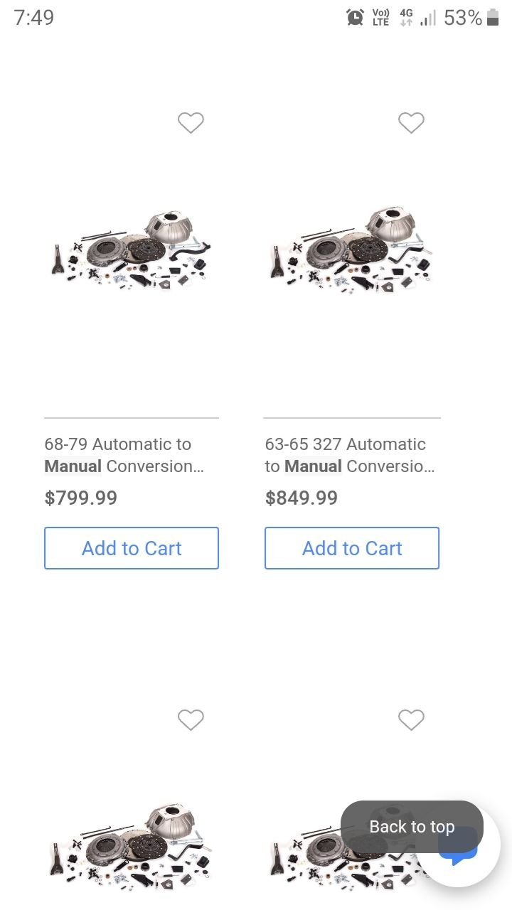

I am thinking down the road to put a m22 manual transmission but wanted to know if anybody makes the manual parts?

Here'sa screen shot off my phone of Zip Corvette's site.
Bottom line is, it's a Corvette everything is available. Good used stuff out there as well as a number of vendors selling new parts. Putting in a manual has been done many times. Also consider your rear diff gear ratio. You may find your auto rear ratio to be a bit to tall.
