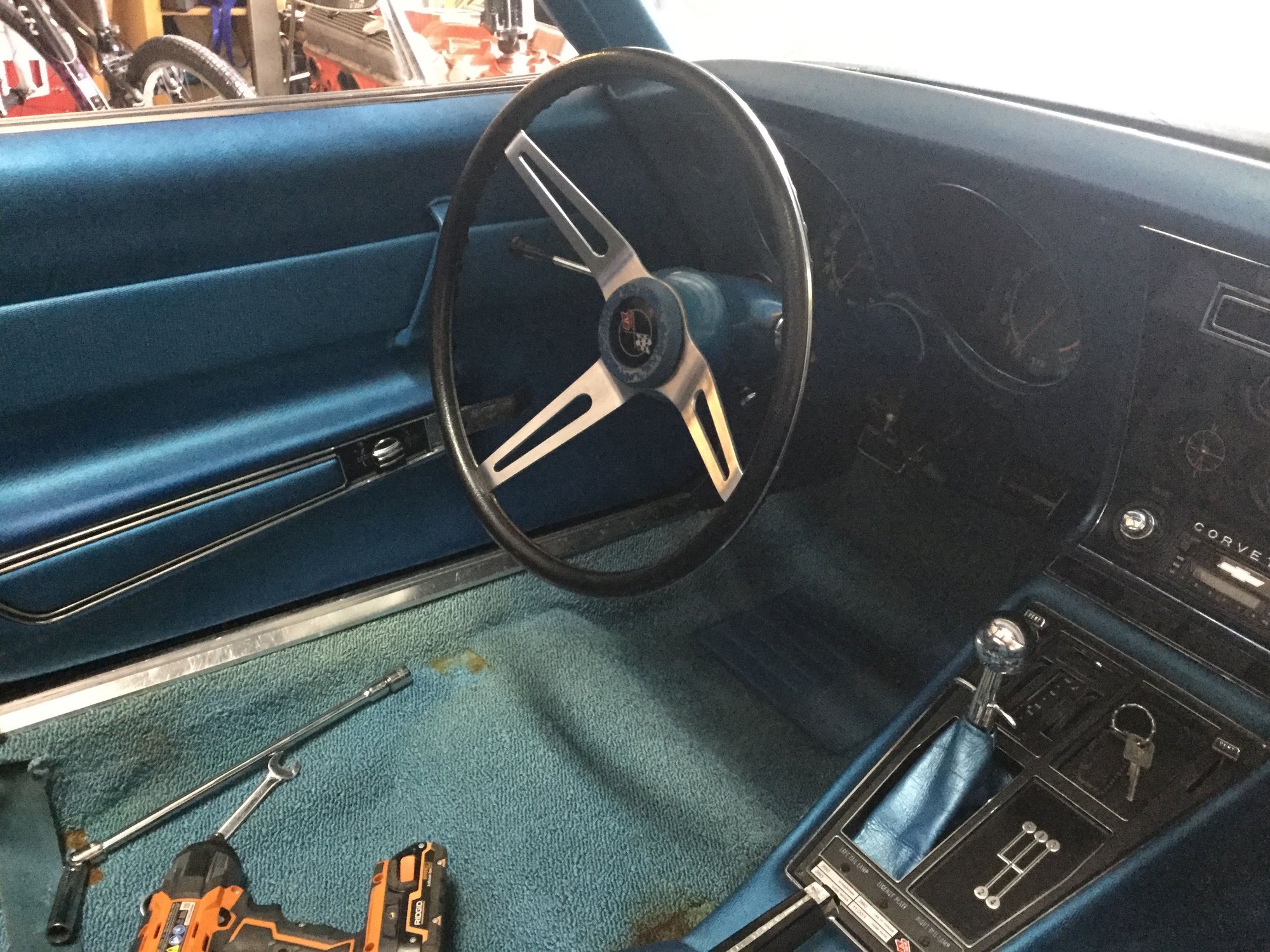

Another question related to the booster reinstallation. As I indicated, the previous owner did not install the upper left nut on the brake booster bolt. This seems to me to be the most difficult one to work with. For those of you with knowledge, when I reinstall the new booster, do I need to remove the steering column?
Old Apr 11, 2020 | 11:30 AM
Gordonm's Avatar
Gordonm
Joined: Dec 1999
Posts: 19,610
Likes: 778
From: Forked River NJ
Yes it can be done with it in there. It is easier with it out but it can be done. You need a extension and a good joint on the end and a socket. You load the nut in and stab it up there. Done it many time. Also easier if the seat is out.

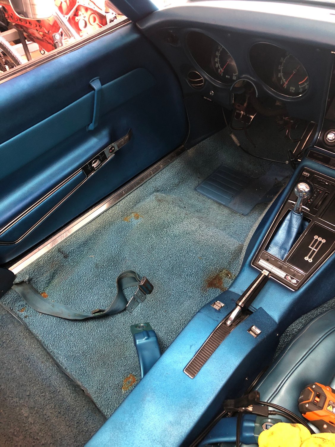

It has begun. Any advice on boosters? Are they all the same?
