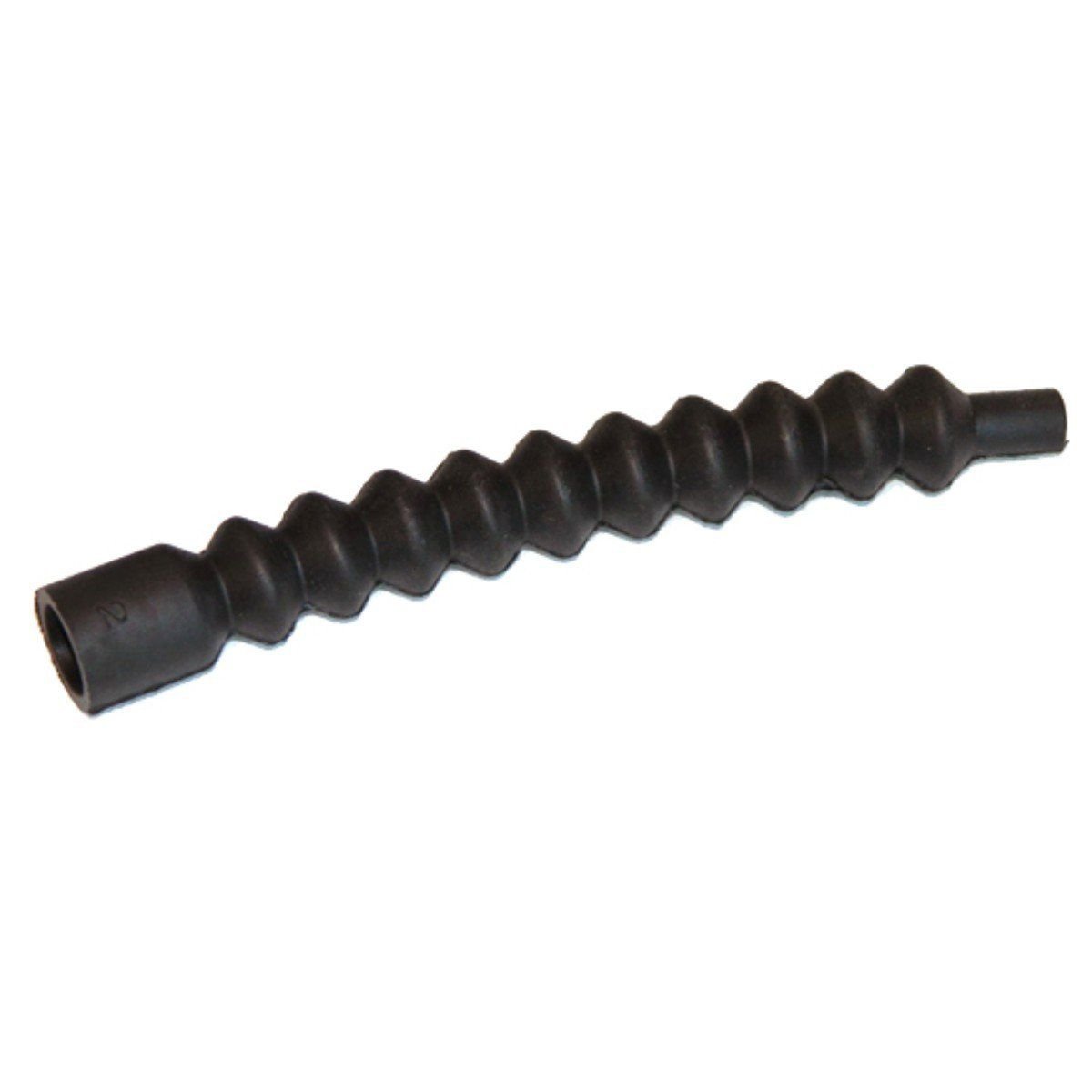

You're right in that this part looks very similar to what's left of my bellows/boot:
https://www.westmarine.com/buy/sierr...03?recordNum=4
I guess I need to get one to compare but my local West Marine is out of stock on them... I'd much rather spend $15 than $60 for a piece of rubber.

https://www.inlinetube.com/products/ec0028
I have no idea of what exactly the size of this is but a person could maybe find out with an email or phonecall and go from there

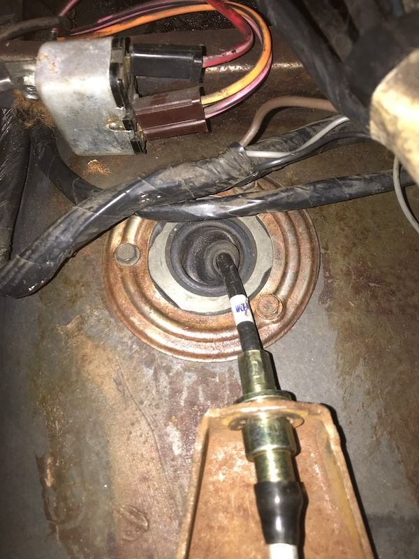

I just went through this on my '73. I couldn't find the new rubber piece. I sourced a new shift cable from RockAuto. One thing to be aware of on the RockAuto cable (I bought the Pioneer branded cable): The e-clip that holds the cable onto the bracket under the center console was a 3/8" clip on my original cable. The Pioneer cable needed a 1/2" e-clip which did not come with the cable. I broke the 3/8" clip trying to get it in place before I realized the size was wrong.

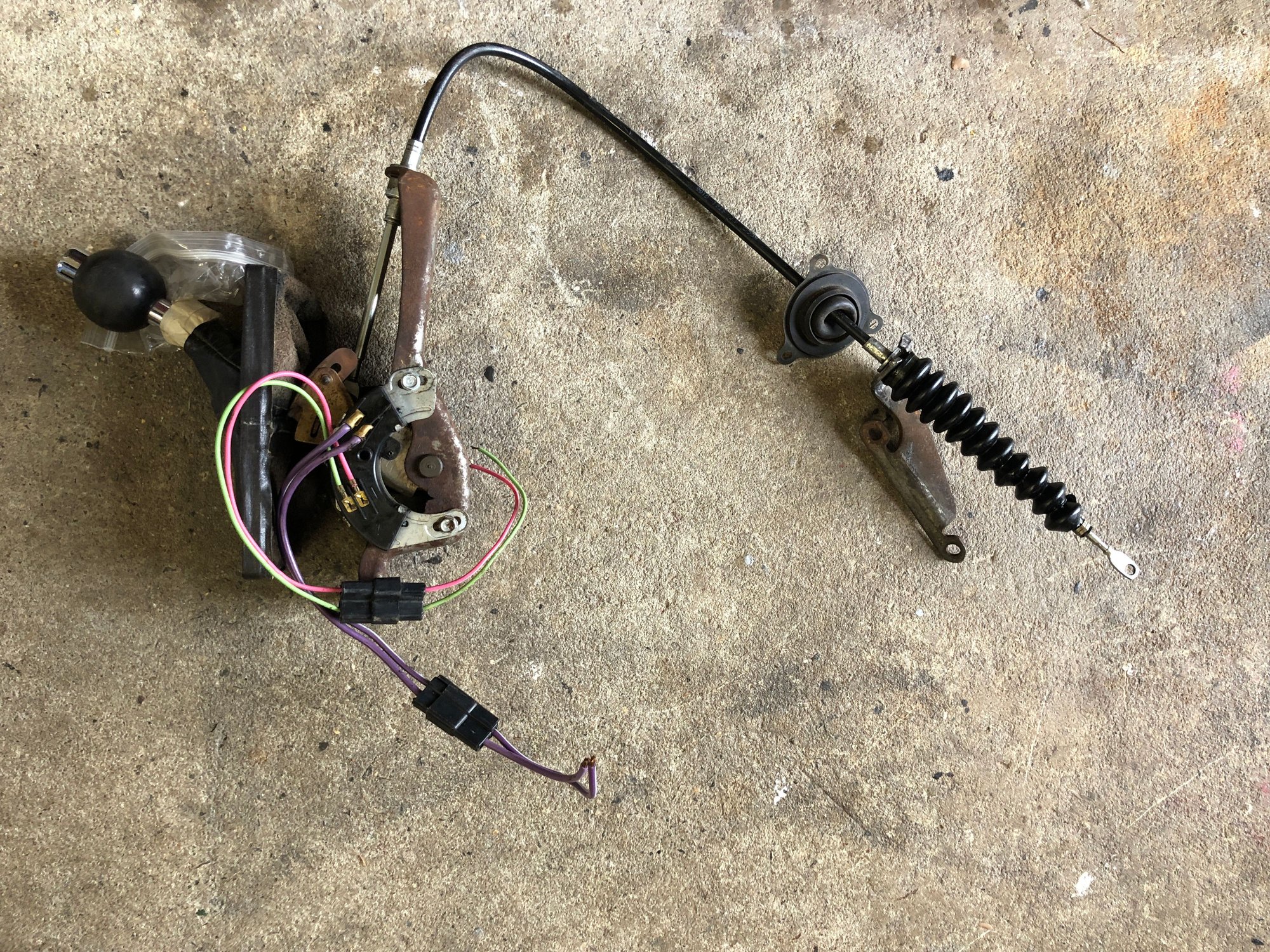

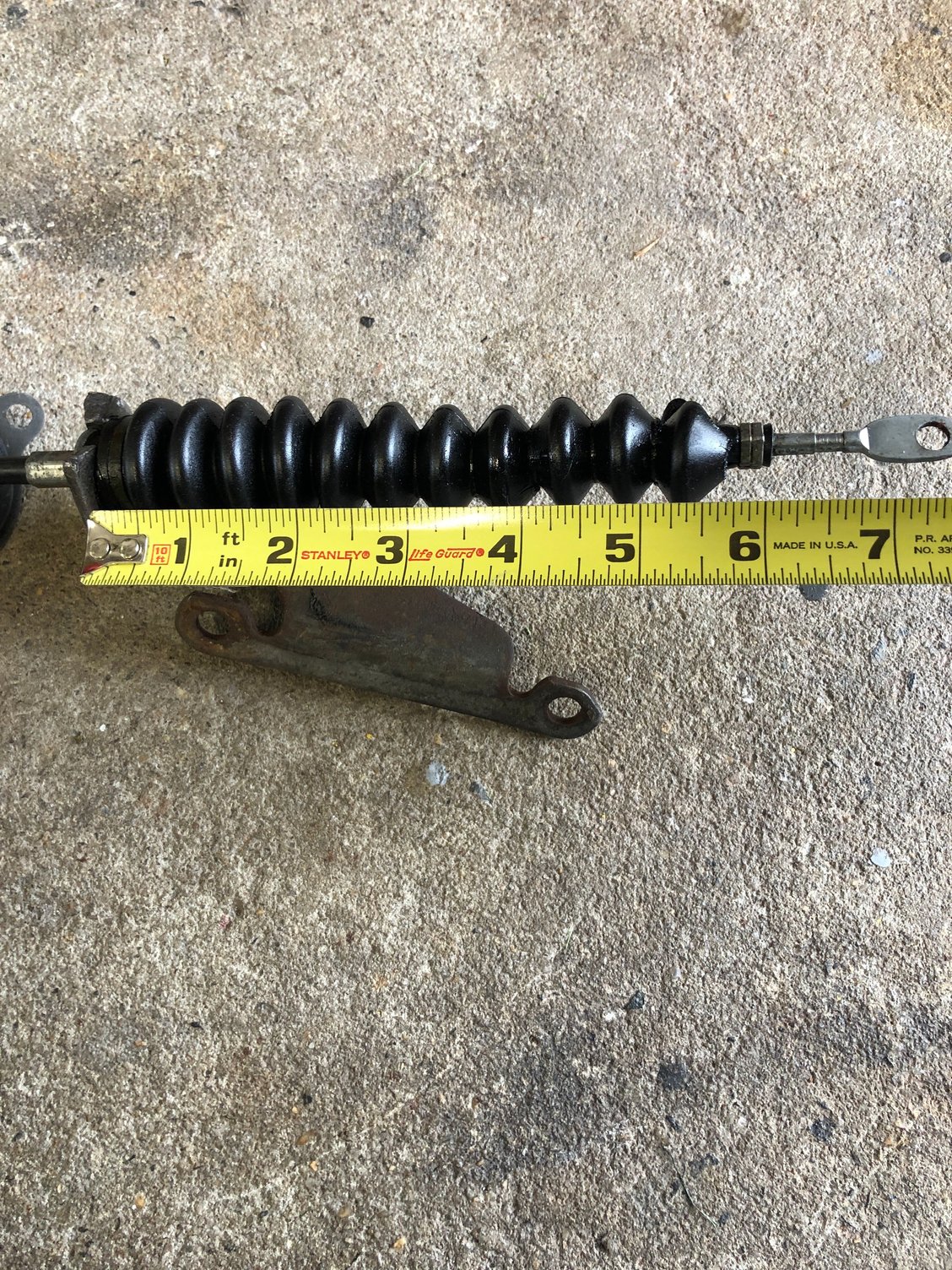

Hope this helps:
Old Apr 14, 2020 | 11:41 AM

PS - I ordered 2 of the inlinetube boots off ebay for $13 shipped. I'll post here the results when I attempt to use one on the cable. Theirs were used on 80-81 corvette rear parking brake cables so I'm gambling they are the correct size to fit on this cable.

Originally Posted by John 65
Pic
Thank you for the photos with measurement. My boot has pretty much disintegrated so wasn't able to measure it.

  1. The Inline Tube bellows that arrived are waaay too small to substitute for the shift cable boot. These are intended for the rear parking brake cable at the trailing arm and are only about 3" x 1/2" diameter.
  2. I ended up with two replacement shift cables: one through Rock Auto made by Pioneer and a second through Ecklers (looks like the ATP from Rock Auto). I stand by my earlier thoughts that the Pioneer is a better quality just by the method to secure the boot to the trans end and the extra "boot" at the shifter end- otherwise they're pretty identical. Both will work but on my car the triangular mounting plate wouldn't allow either to be fastened to the tunnel hole without putting the cable in a bind with the shift linkage, opening air gaps around the triangular mount plate, and needing to drill new mounting holes.
    I ended up cutting the center portion out of the original cable's rubber mounting gasket and using that plus the original ring to secure the replacement cable to the old holes in the trans tunnel. Not ideal but it does work by giving the replacement cable more alignment flexibility to mate with the shift connection.
