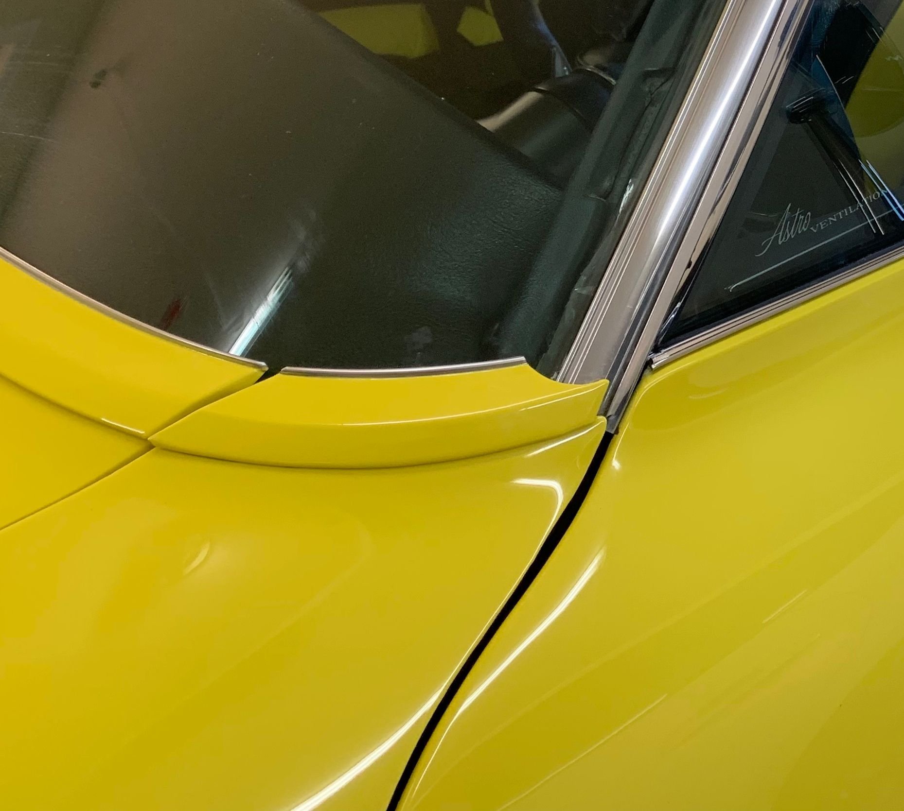

Can someone post a picture of the fit of the wiper door molding fit to the door on the leading edge. Just received my car back from the paint shop and the leading edge of the molding is 2 -3 mm high to the door. I do not recall the gap before painting. I suspect they may have bent it when the removed it.

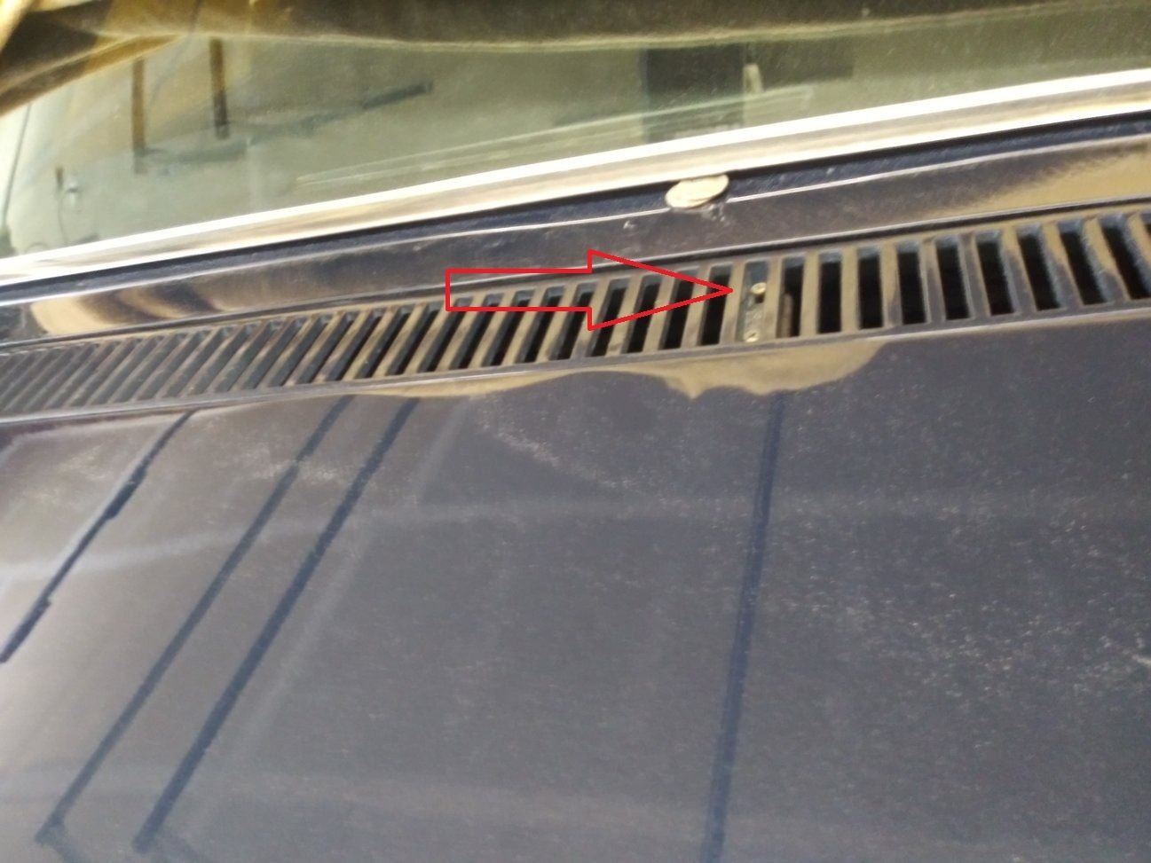

Can you post a picture of yours?
Are you referring to this area? Excuse the 49 year old paint.

Hopefully the clips will fix the gap. On another note, it looks like the wiper grill doesn't have the correct spacing between the bottom and the bracket where it mounts.

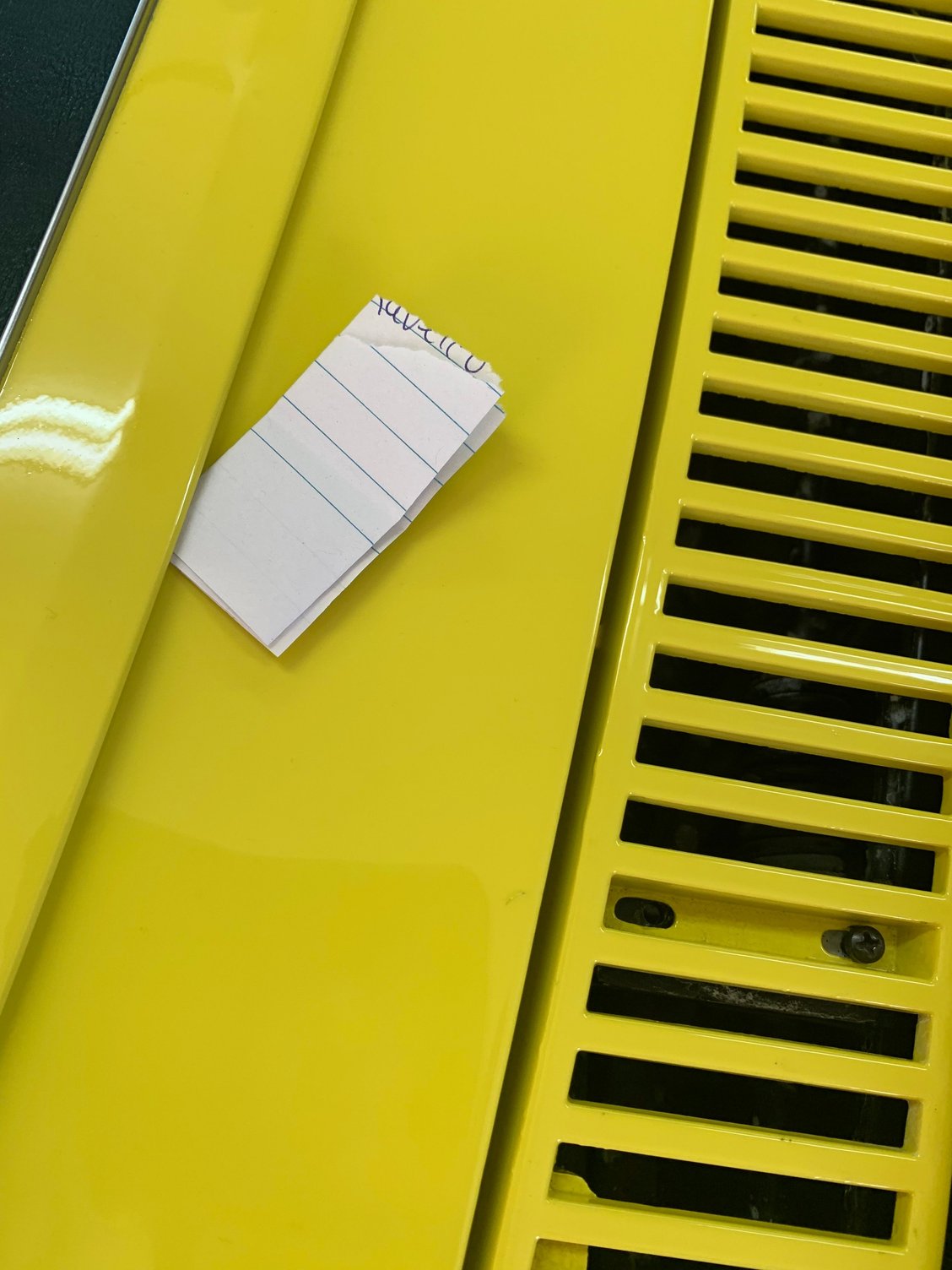

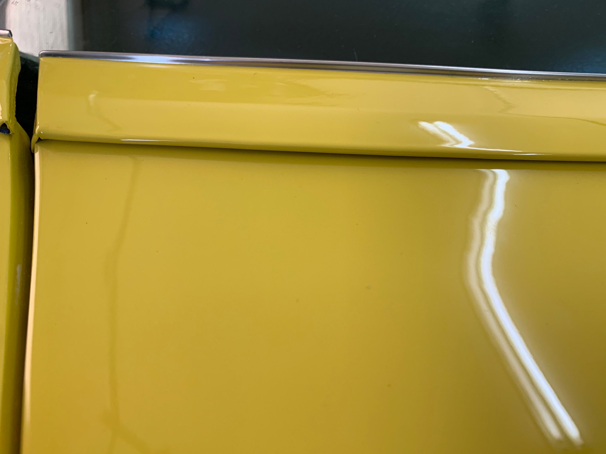

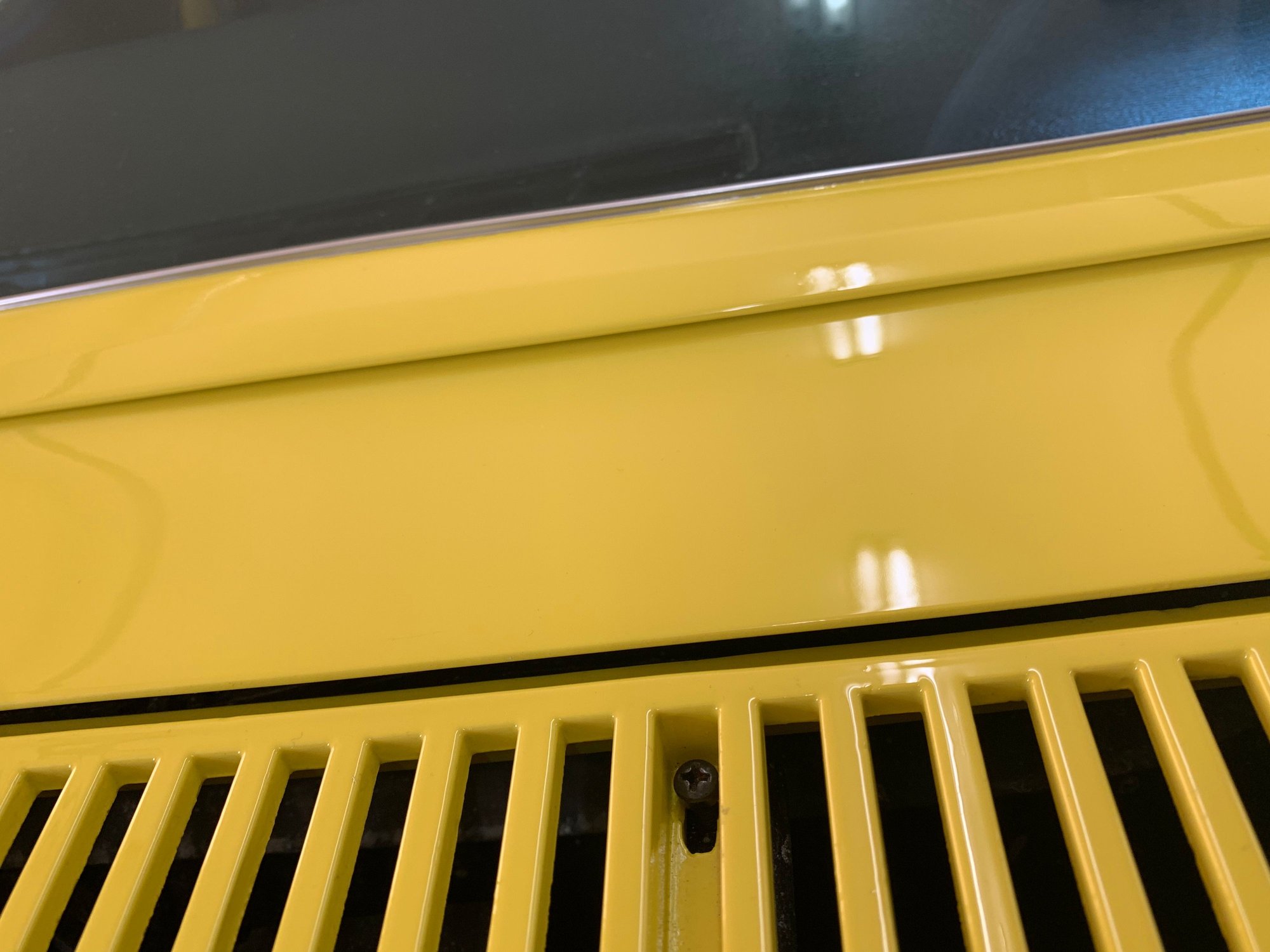

Tight, no gap visible from over head but a even very thin gap across entire length.
5 clips.

For me to see the gap I have to lay my head low to the hood.
Sheet of paper folded 3X and it is very tight it barely goes in, paper folded once goes in freely
4x will not fit

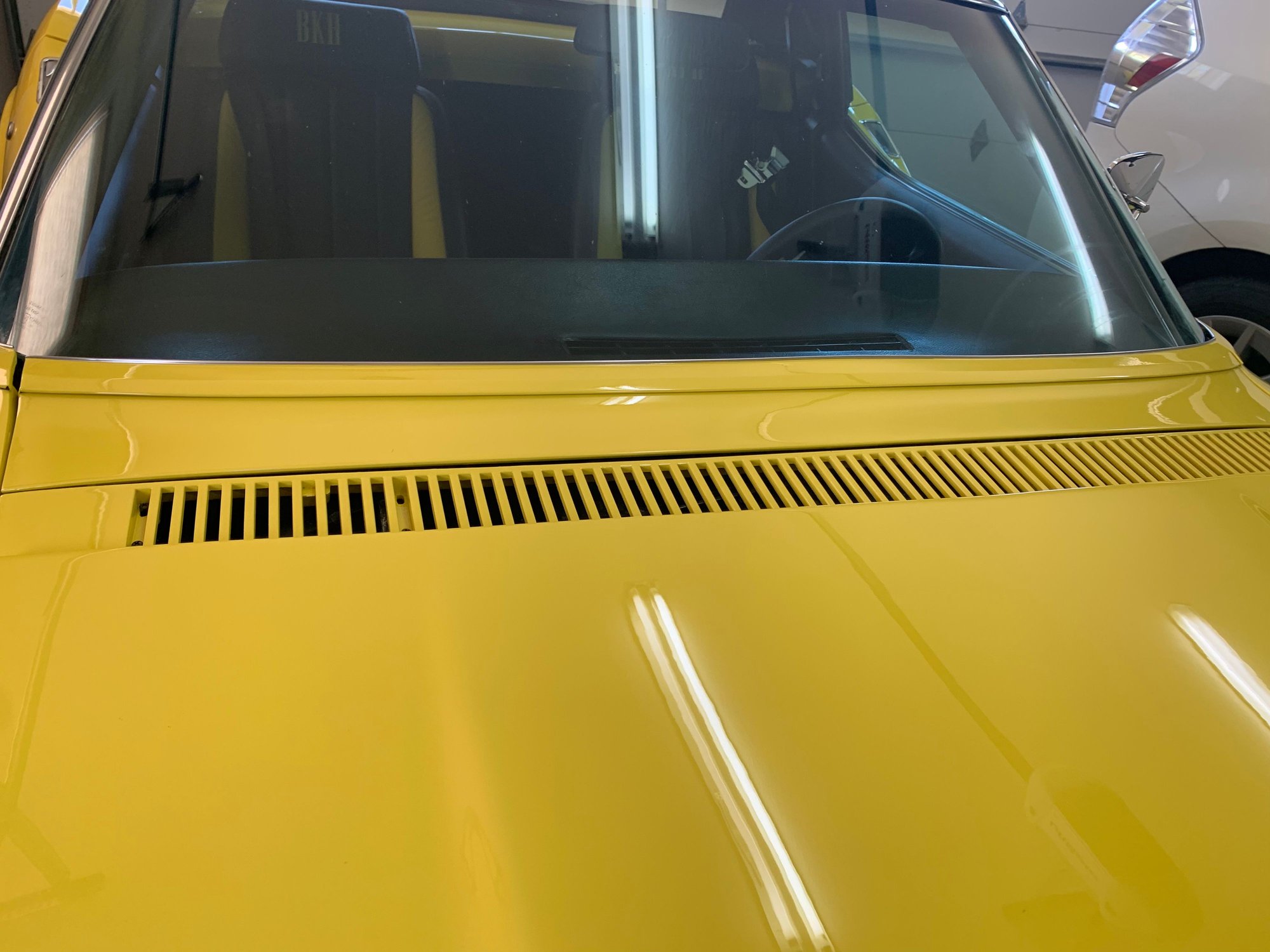

Thanks for all the reply and photos. I took it apart today and it did have the 5 clips. Problem was the molding was not fully installed into the clips. Re-installed correctly fit issue solved.
