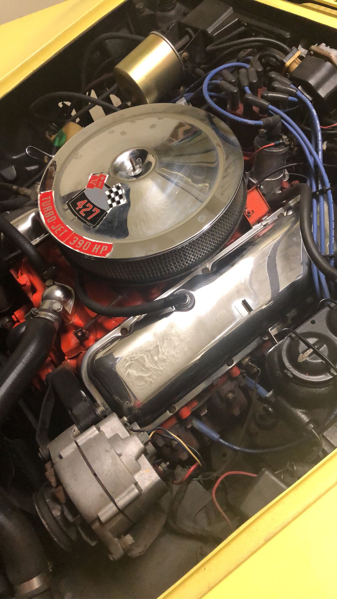

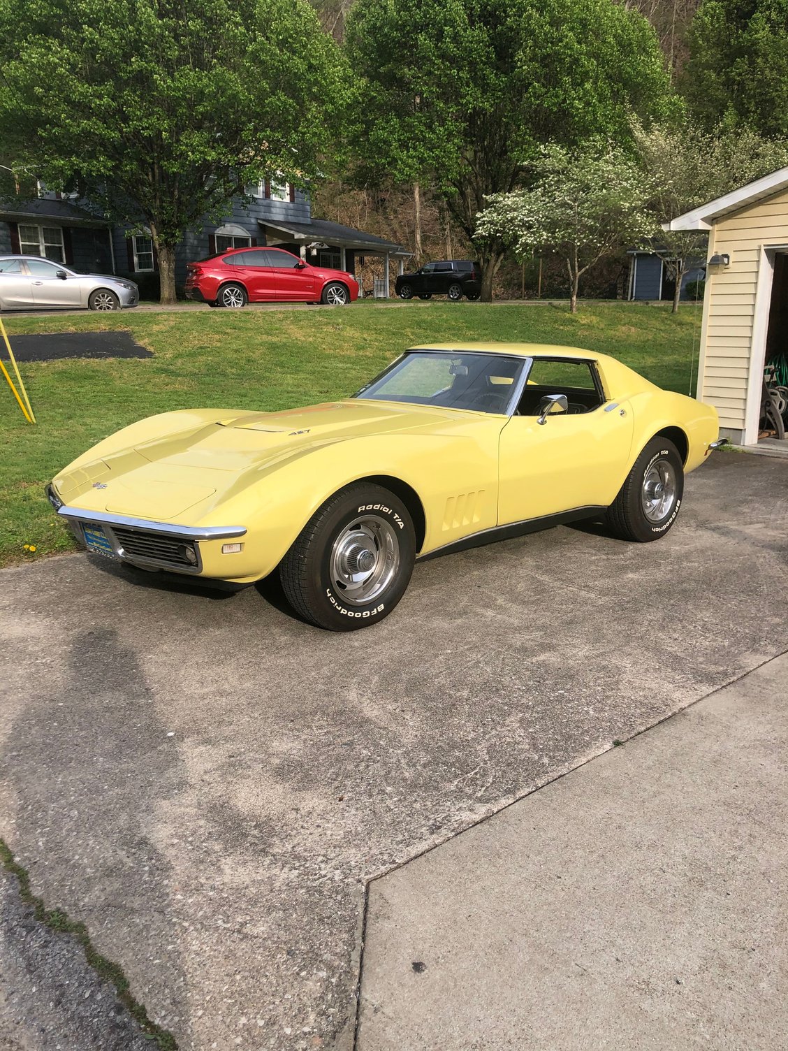

Sorry to cause you the trouble with yours. This is my first.
68 coupe L36 4spd safari yellow

Nice looking car
