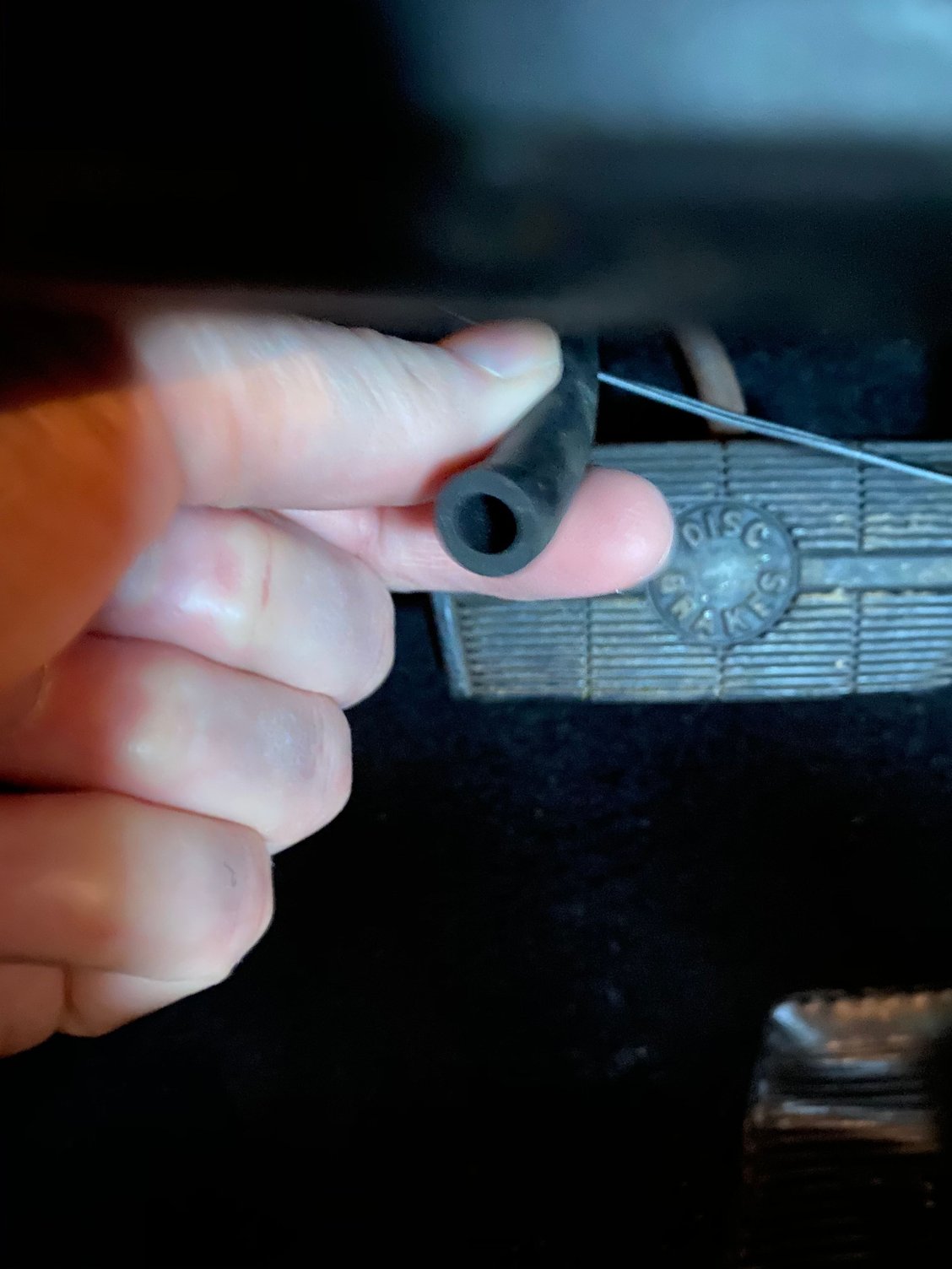

Vehicle is a 1982 CE
I recently discovered this vacuum hose. It ends just above the hood release. I followed with my hand to the firewall, the OD is 7/16 and the ID is 1/4.
Could some one please tell me where it connects.

It runs the vacuum controls and selector for the HVAC system. Or it's from the headlight override.

That should be easy to eliminate the headlights. If the headlight doors work without it connected, it's gotta be for the A/C. I believe any open vacuum line in the headlight system will not allow full open/close function.

Red Sox....you'd hear the vacuum leak...pretty distinctive.
Yup! I know it's a pain to get under the dash....I'd highly recommend pulling the driver's seat.....four bolts that you should lube liberally and one connector for the power seat. I guarantee you all sorts of 'treasures' under the seat!
A vacuum gauge will also give you some info. Getting the vacuum diagram will make things really clear.
You can disconnect the HVAC controls and plug them from the engine compt side of the fire wall. During these trying times...a good use for those un-used golf tees! lol.

Per this diagram I believe that the hose in question goes from G to K. Also, is the vacuum valve with the 5 connections located on the passenger kick panel by the fresh air vent?

Given the size and location that's almost certainly for the cruise control. It leads to a vacuum switch on the brake pedal bracket above the brake light switch.
If your cruise control has been removed or disabled don't worry about it.

Easy enough to tell. (Sorry, I forgot about that!) Having just rebuilt the entire cruise control system in the CE....double DOH!
Taking the seat out is not that bad if the bolts are not rusted in.
Oro Valley....this week 100-103°F......you make your choices and you take your chances! LOL
unkahal
So with the Cruise hose...look for a solenoid in the brake pedal area.
