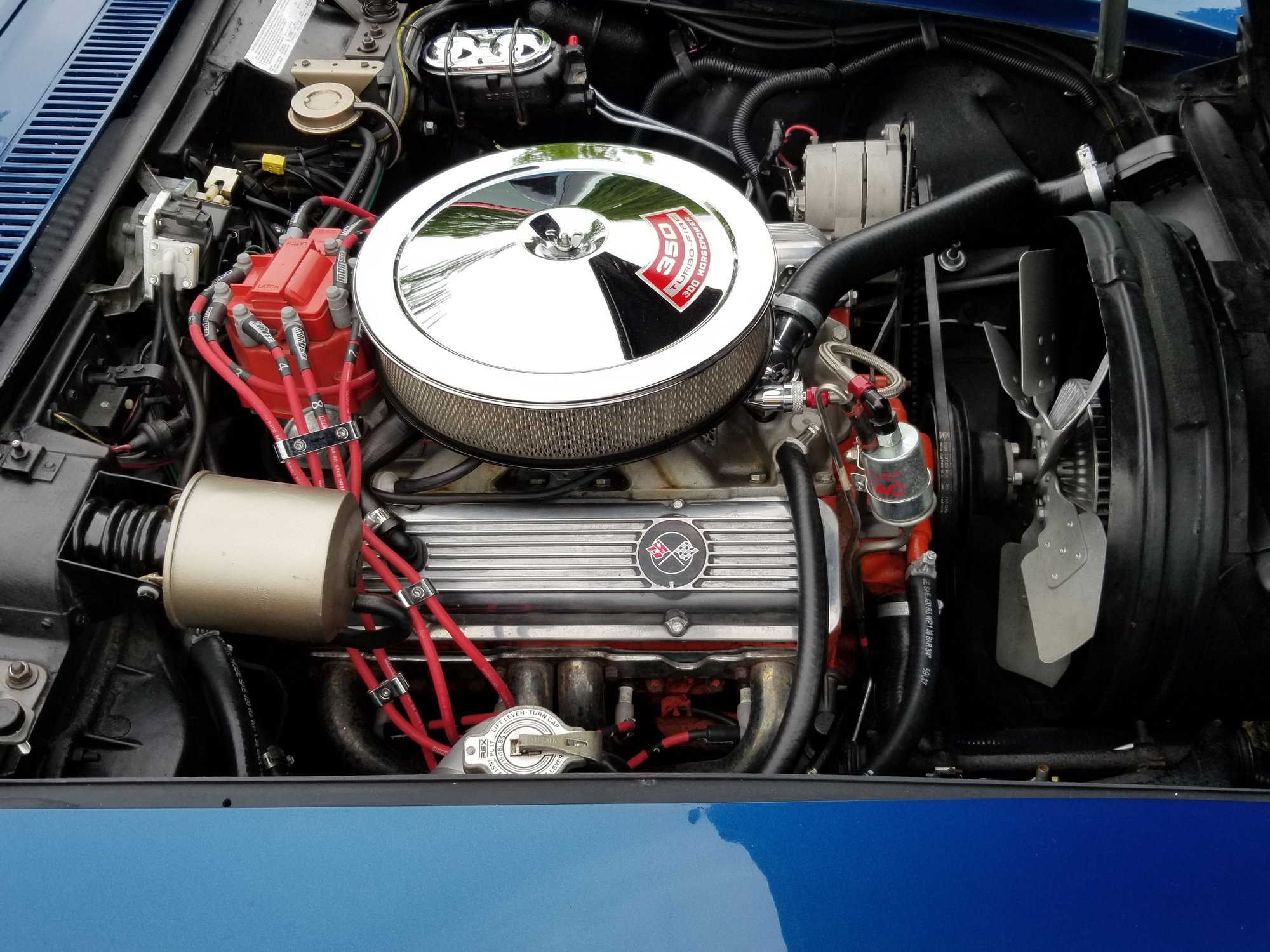

Hi Folks,
Looking into Powder Coating the headers on my '69 small block.
I have a couple of local shops that specialize in blasting and powder coating of auto parts.
I'm mainly pondering the color options.
The engine block is Chevy Orange.
The valve covers are the finned aluminum type.
Not sure what input you folks can provide with your own experiences (photos are encouraged).
Right now, I'm thinking either black or argent-ish gray.
But I'm open to other options.
