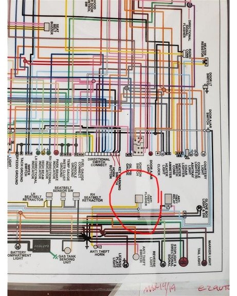

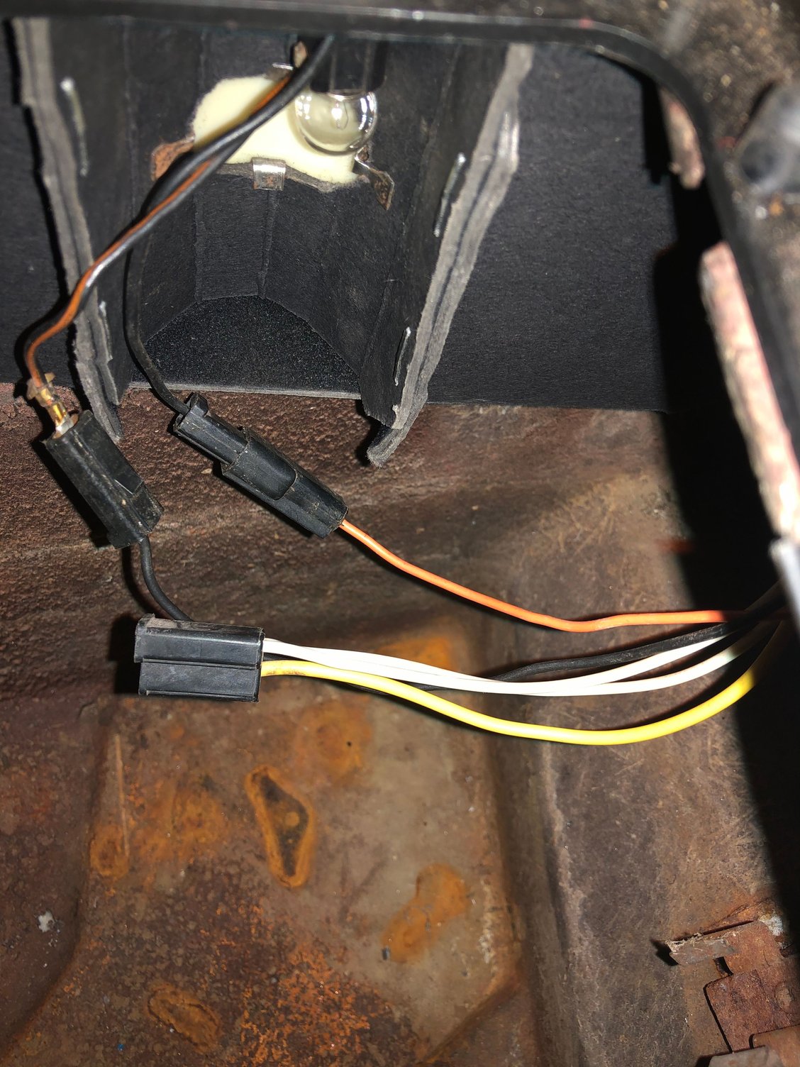

I am restoring a 73 coupe, currently working on the interior and wiring. There is a terminal with a yellow and two white wires hanging in the Jack compartment. Cannot tell from the wiring diagram what this hooks up to. It is not the glove box light, have correct wires for that.
This is in the jack compartment.
Anyone have an idea?

rgadds,
Welcome to the forum. That connector is part of the factory alarm system.

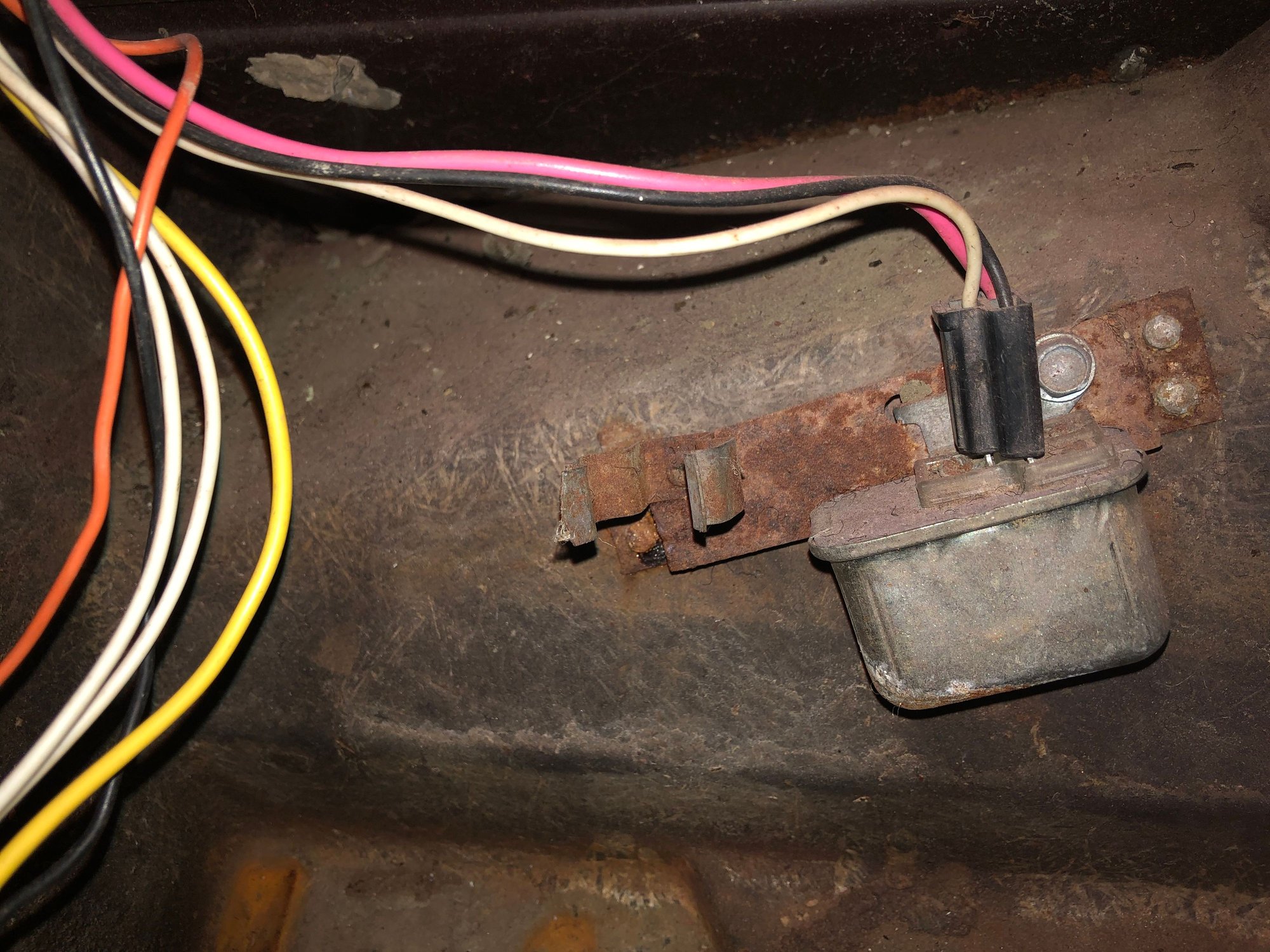

Is this a relay related to the alarm or something else? Also in the Jack compartment. Obviously this is my first Vette!

That should be the alarm horn relay (black pink white)
The yellow white wires beside there would be for the flasher that made the horn cycle on-off-on-off......
