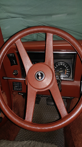

This is what a non T/T looks like in 78/79.
Starting in 1980 T/T was standard equipment.
