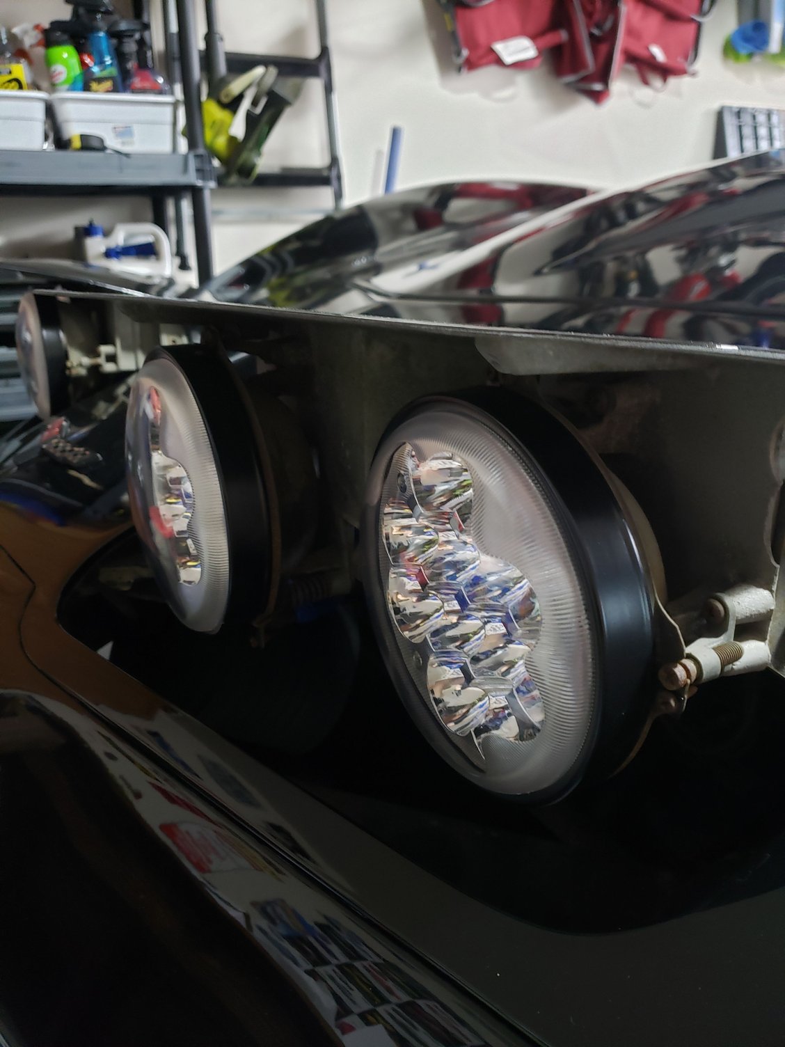

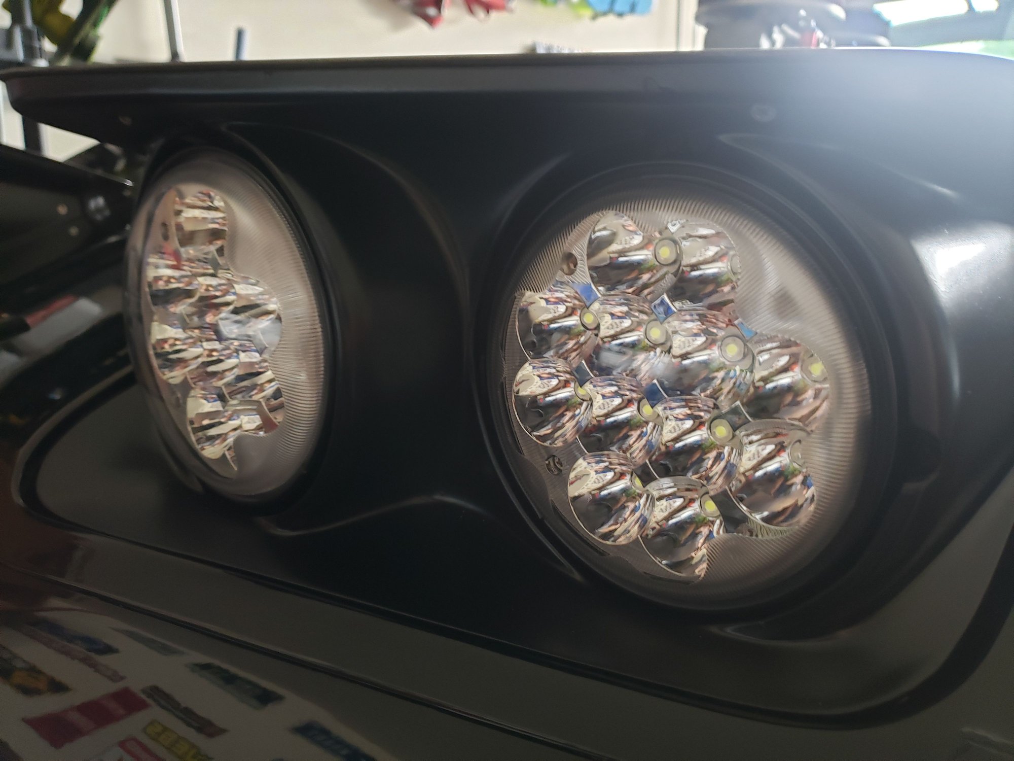

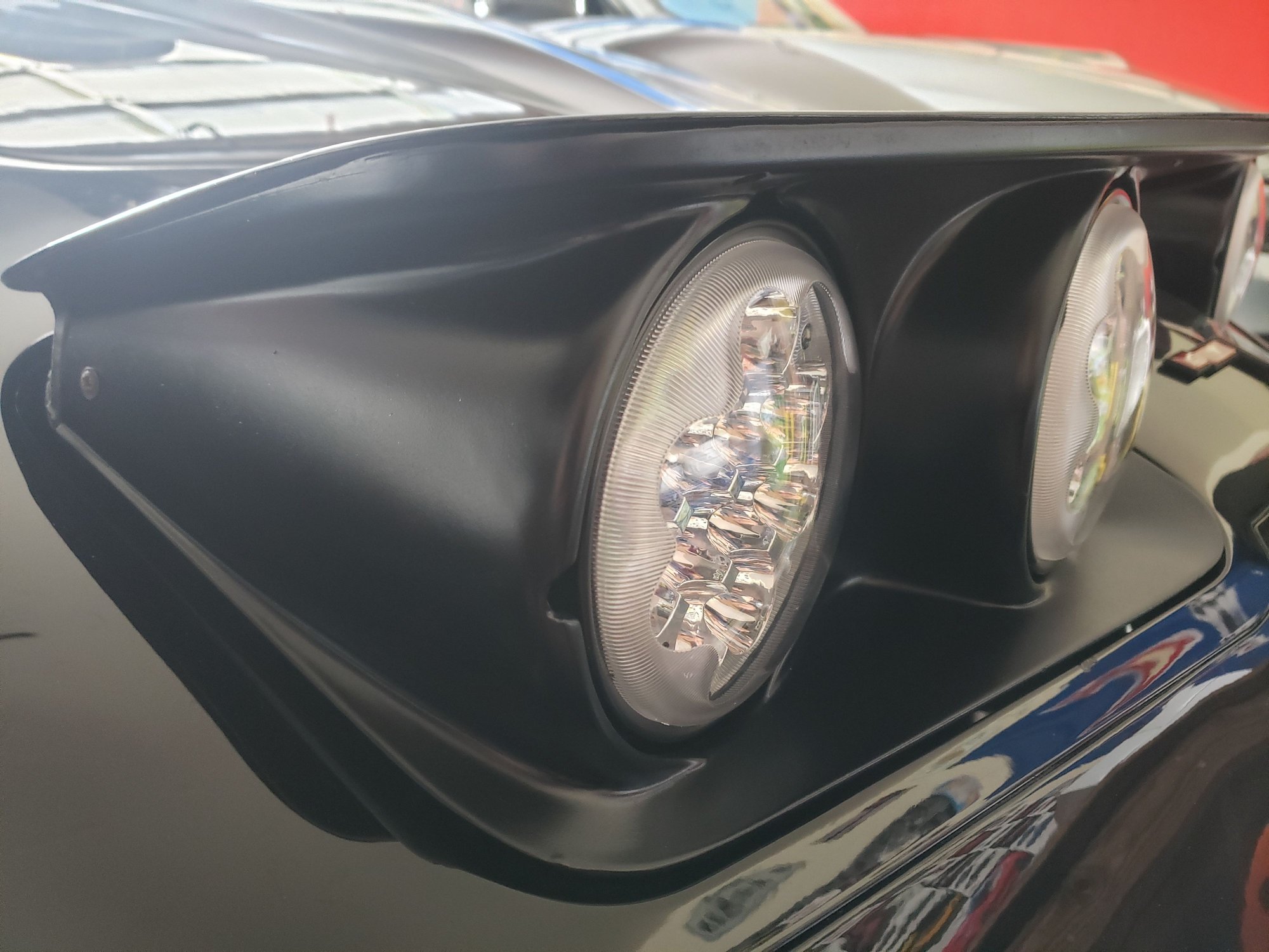

Freshly installed
Original placement and screws. Lights don't protrude out.

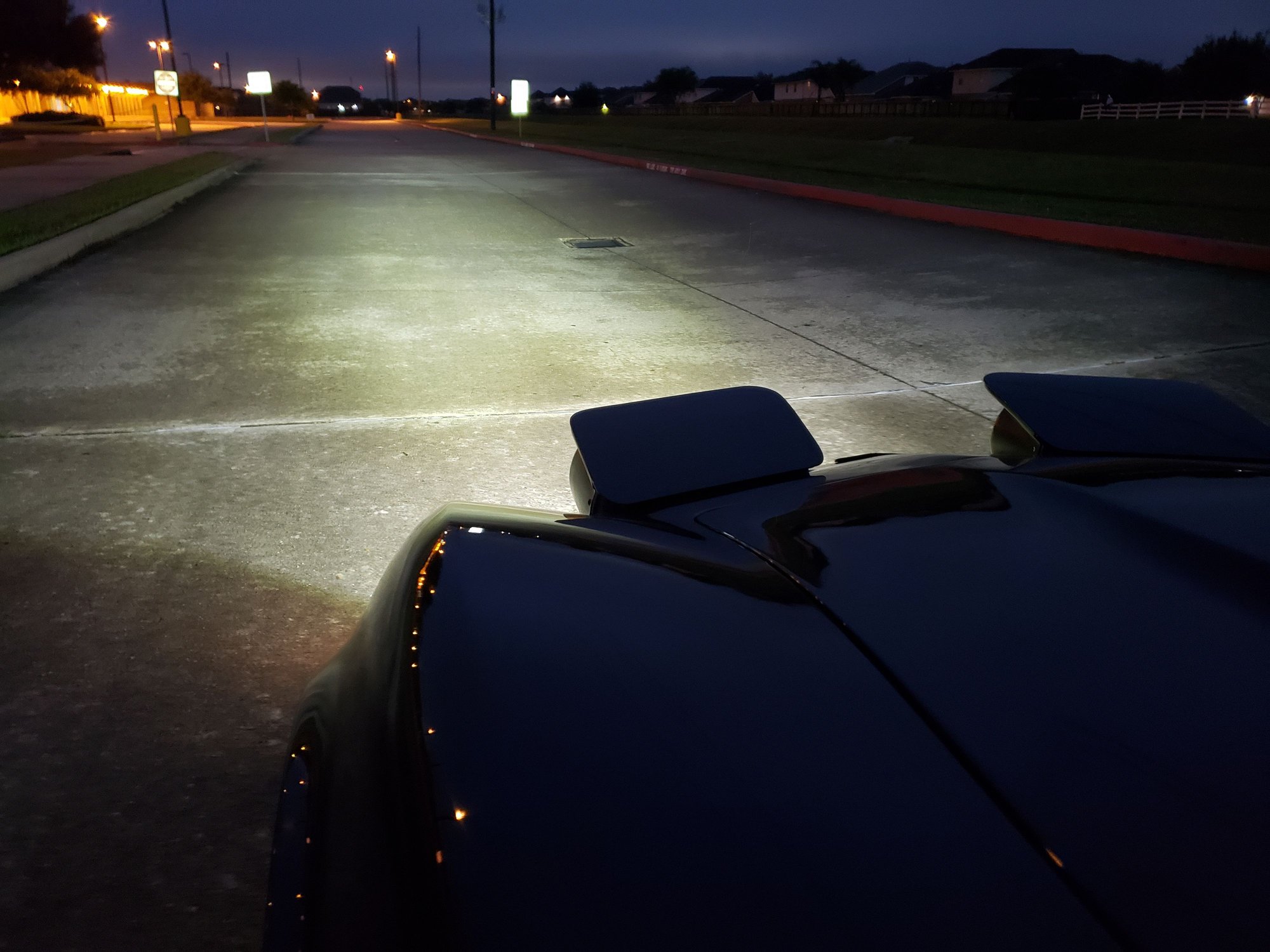

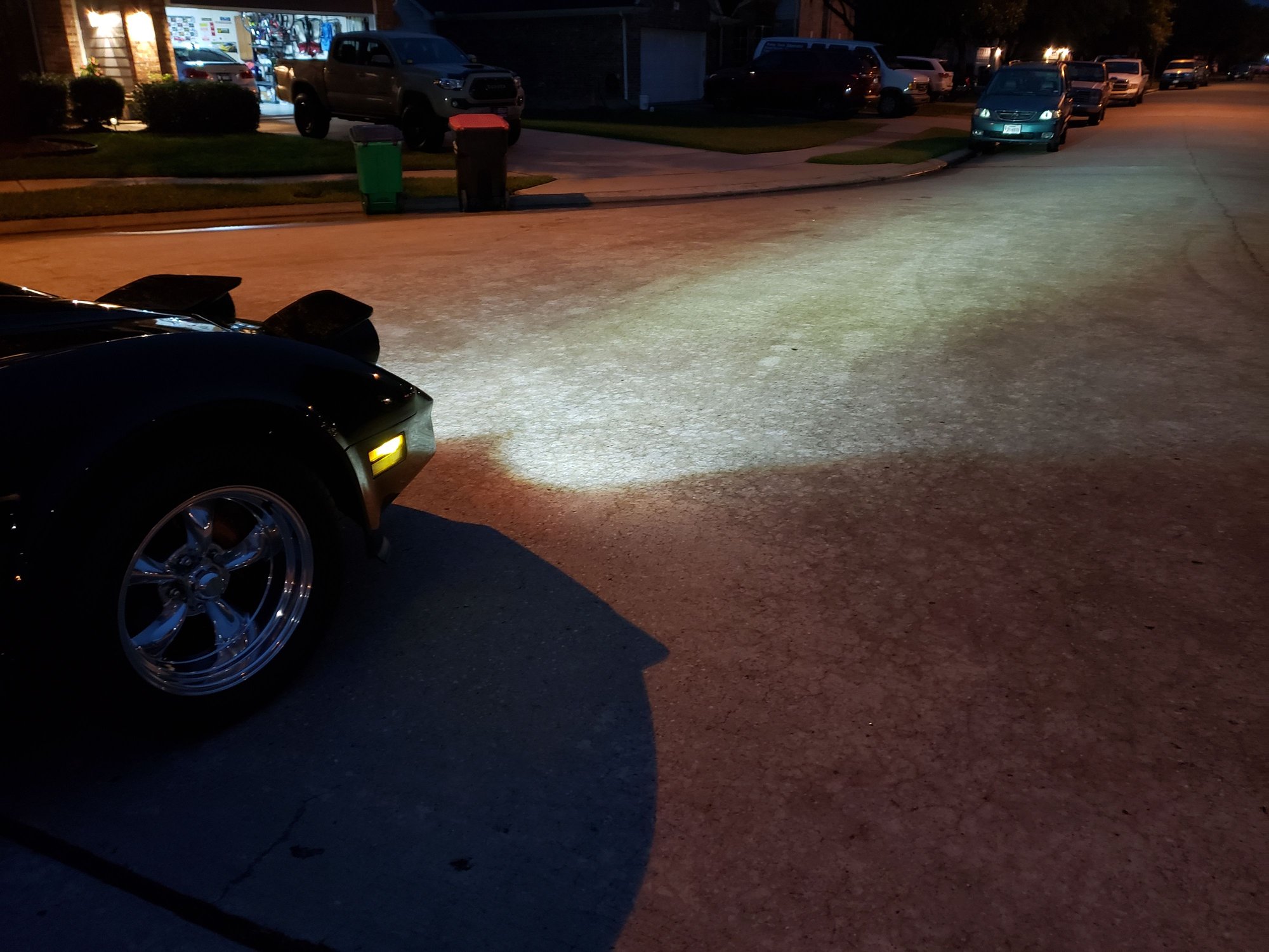

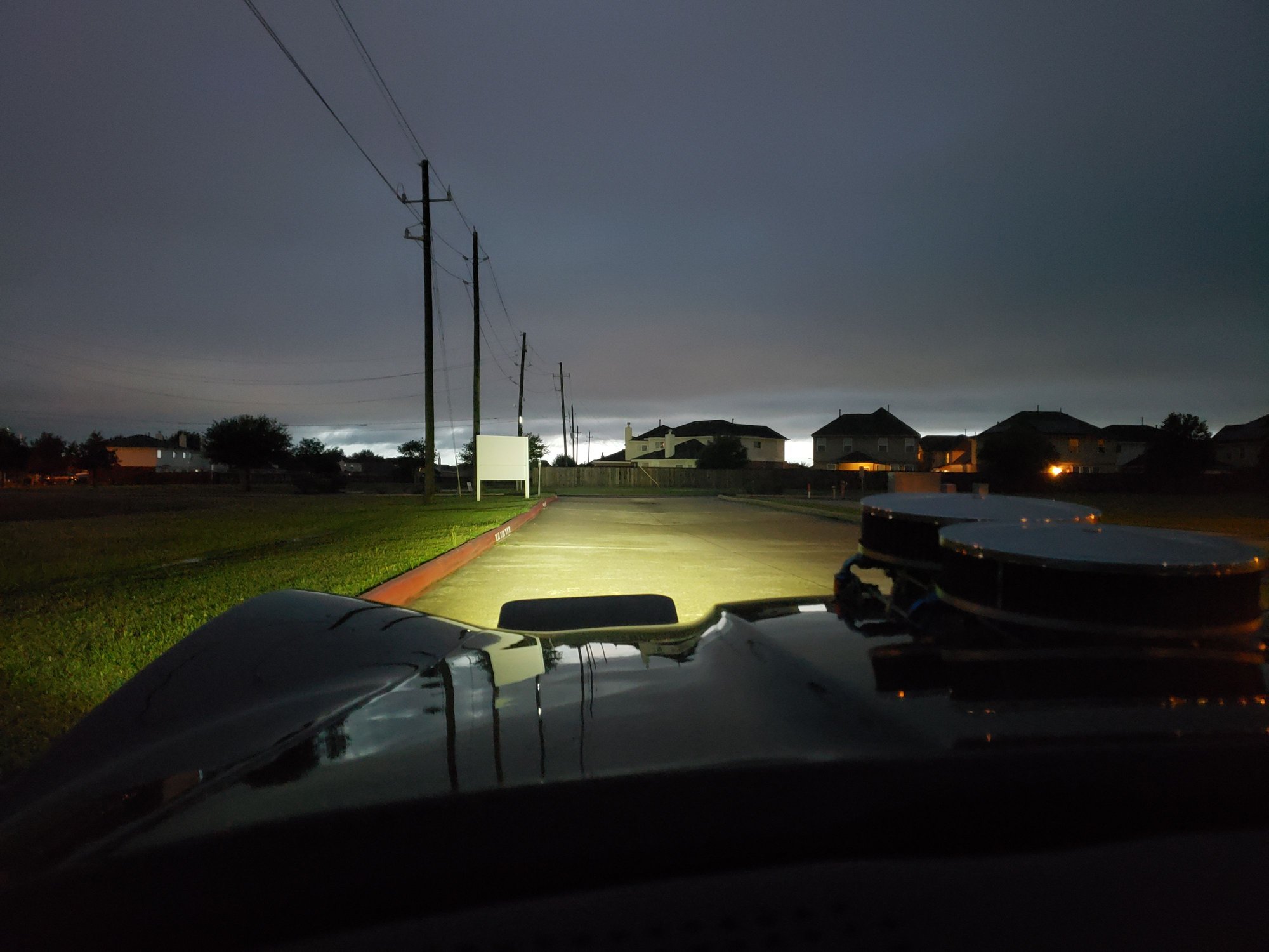

Here are some quick pictures from last night. Rain was coming in and out so didn't have much driving time. Took her around the neighborhood and the lights are definitely bright. The beams are even from what I can see and I didn't do any adjustment other then to have the bulbs lined up horizontally during installation. Might be blinding people but I can see the road. At first I thought I had the high beam on but realized how much brighter when I turned it on.

Wow that looks great but there is something on the hood blocking your line of sight!
THANKS......I NEEDED A GOOD BELLY LAFF !
