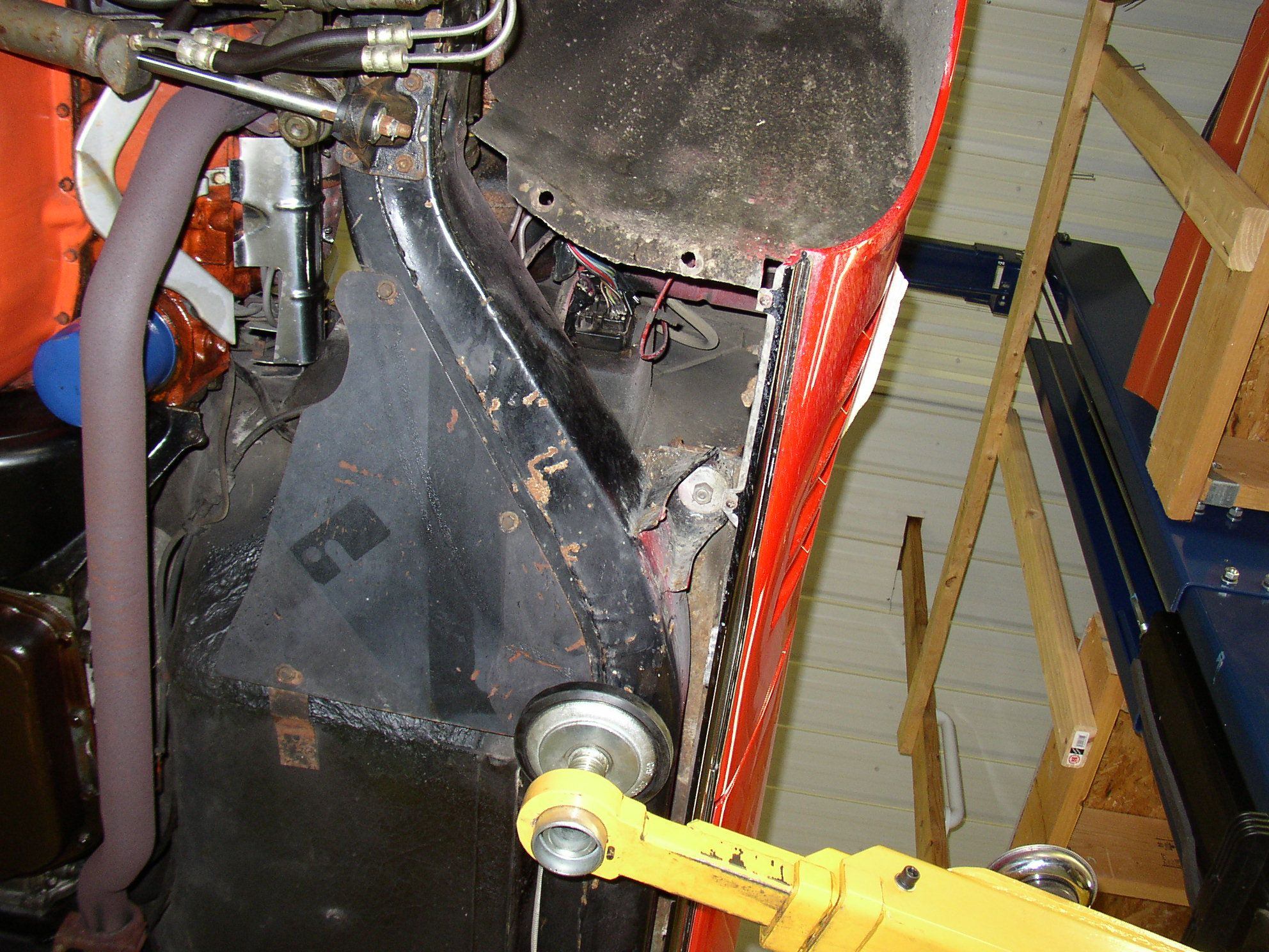

I restored mine, as Bubba left them alone. I believe the rubber water seal is an extra item. Looked on the CF for info, and used 16 or 18 Ga. galvanized solid wire from HD in lieu of the staples used by Chevrolet to secure rubber seal.
