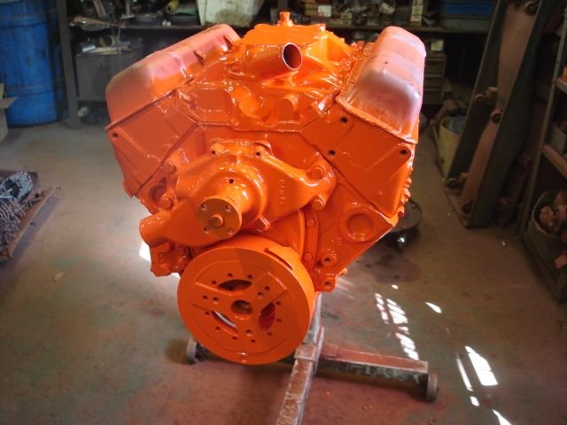

Engine ready for install, figured i'd keep everyone updated! (Thanks Tom Luedeke)

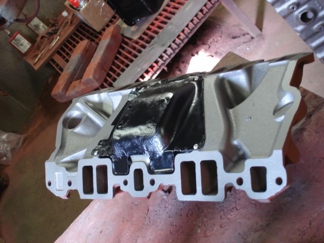

Great job. While the carb is off the car, consider plugging the crossover ports on the intake manifold. Also use the three piece gasket set recommended by Lars. Doing both will keep your carb base cooler and help prevent vapor lock. I bought my plugs at NAPA for about $1. Jerry
Exactly. That is the carb cooker manifold.
Need to block the drivers side passage and wire the EFE flapper valve open at a minimum. More than one way to skin that cat.
