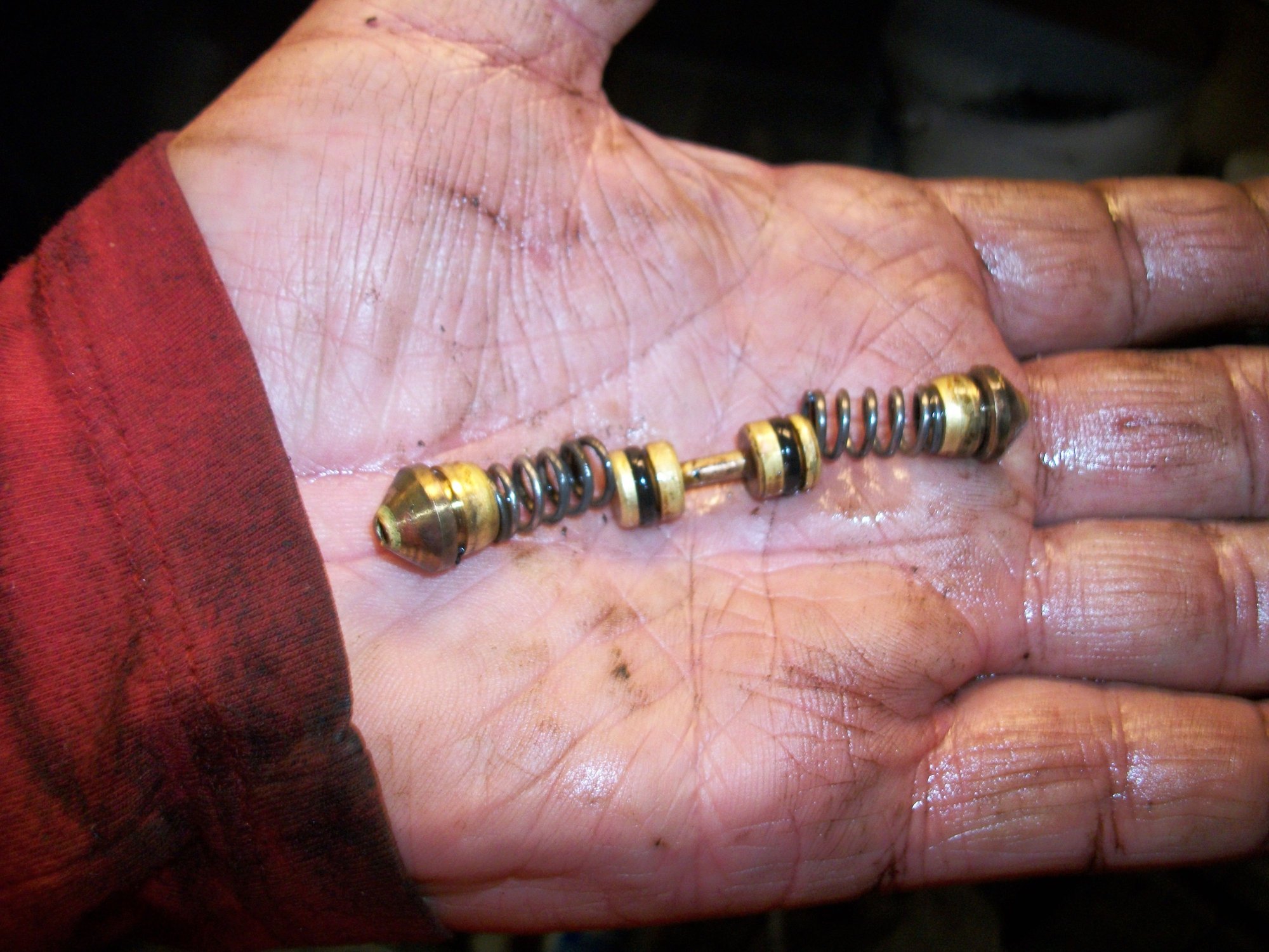

I replace all hoses/rebuilt calipers and master cylinder. but did NOT bench bleed the master.....bad mistake!. The brakes never seemed to stop the car properly. After a couple days of fighting the weak brakes, a member convinced me to benchbleed the master cylinder and clean the distribution block-piston assembly...then re-bleed the entire system. That solved my problem.
Do NOT use compressed air The piston could be "gummed up" so that it cannot return to the center-it may need cleaning or new O-rings.
I do not think you damaged anything. The distribution piston COULD be off-center inside the housing without the brake warning light coming on. If you remove the sending unit from the bottom of the block, using a small mirror you might be ble to recenter the pistion with a thin screwdriver.
Orifices need to be pushed/tapped out of the block with a thin metal rod from the opposite end...…..
Piston assembly with springs and orifices on each end of block...…..
Thanks Doorgunner! yes, I'll try to remove and disassemble the block and see if I can centre the piston.
