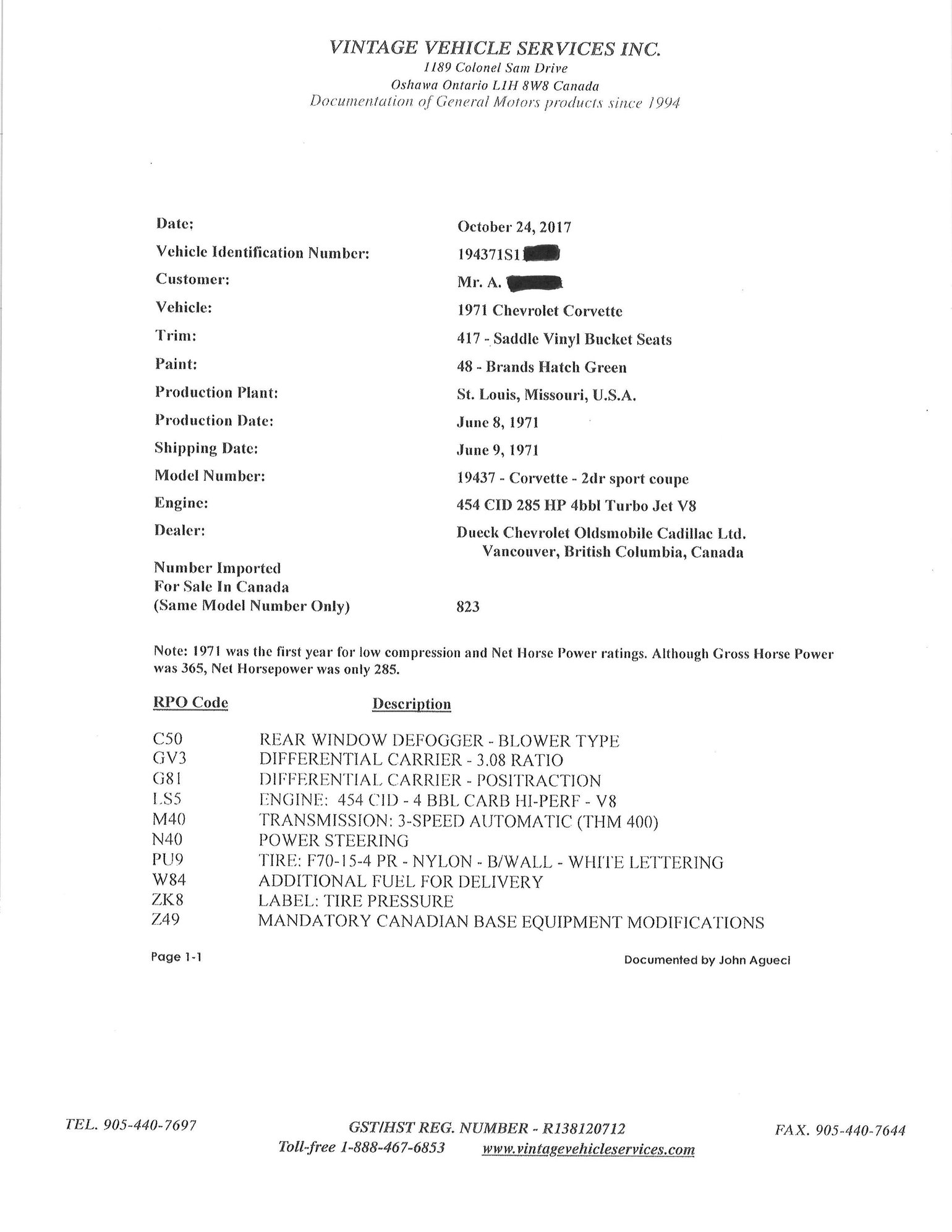

If you’re lucky enough to be looking at a car originally sold in Canada you can get the details from the GM Historical group. Here’s the paperwork on my ‘71 LS5.
To Big block
