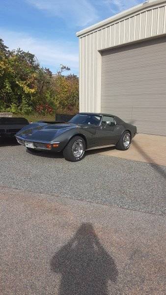

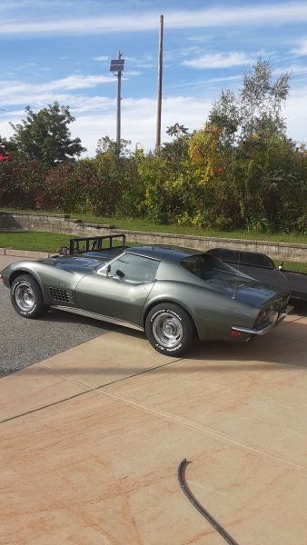

I just installed Cooper Cobra 255/60/15 tires on my 72 Corvette.
