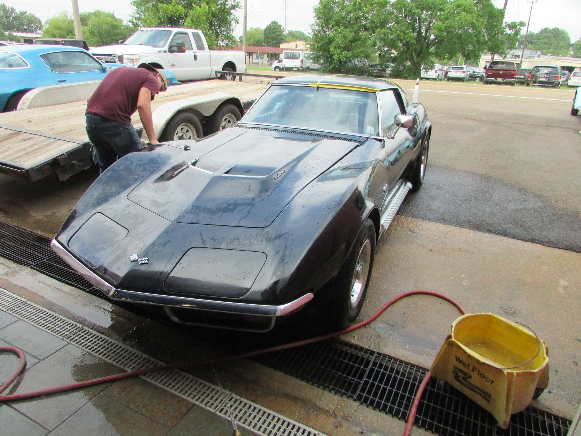

Here is the '72 shined up a bit. The paint is ok from 5 feet but rough as you get
closer (scratches, imperfections, etc.) It will need paint. I'll get some photos of the birdcage later today hopefully

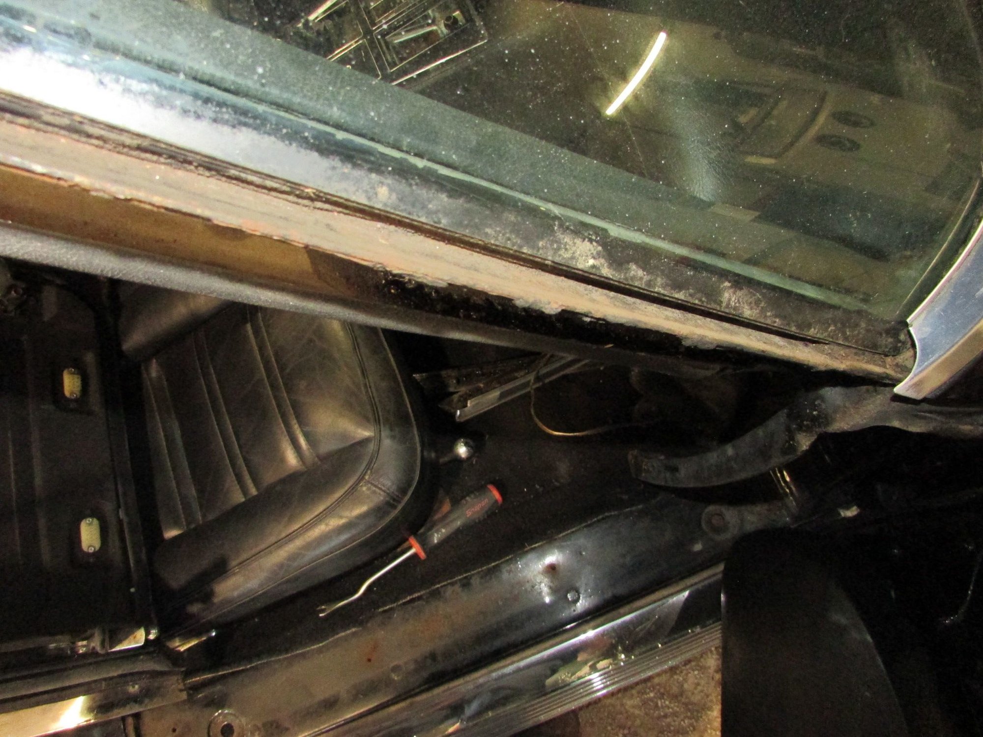

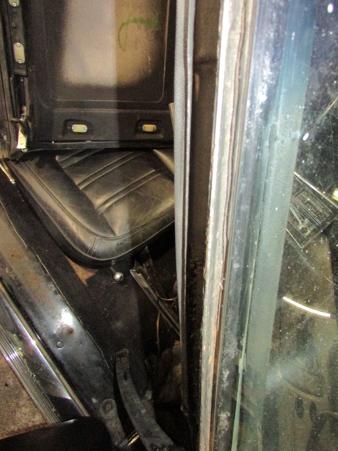

Here are some photos of the metal frame on the A pillar and down in the bottom corner of the cabin. We see no rust there, Are those the photos that are needed?

Here are a few more photos The rust seen is surface rust

Don’t change the rear valance, if someone doesn’t want side pipes they will need that valance. It would be nice if a C3 like this one could get $25K, we need to see C3’s go up in value.
I don’t think this car is an original deluxe interior. Door panels are newer with just the insert in wood grain style, no carpet on the door. Center console doesn’t have wood grain stick-on, and not sure if loop or cut pile carpet. Missing seatbelts, interior roof panel covers missing, non original radio missing ***** and buttons and control **** missing next to the water gauge. Looks like dash was apart, refitting upper dash and center gauge cluster not right. Shifter ball missing and looks like water got inside, rusted screws and some rust on hardware. In my opinion, it appears to be a $15 to $18K car assuming the chassis will show the same level of wear and tear.

72 big blocks are not the sought-after pieces that 69 big blocks are. those #2 body mounts are not rusted away, but not very good either. at 25k, the body does not need to come off the frame. this one does.

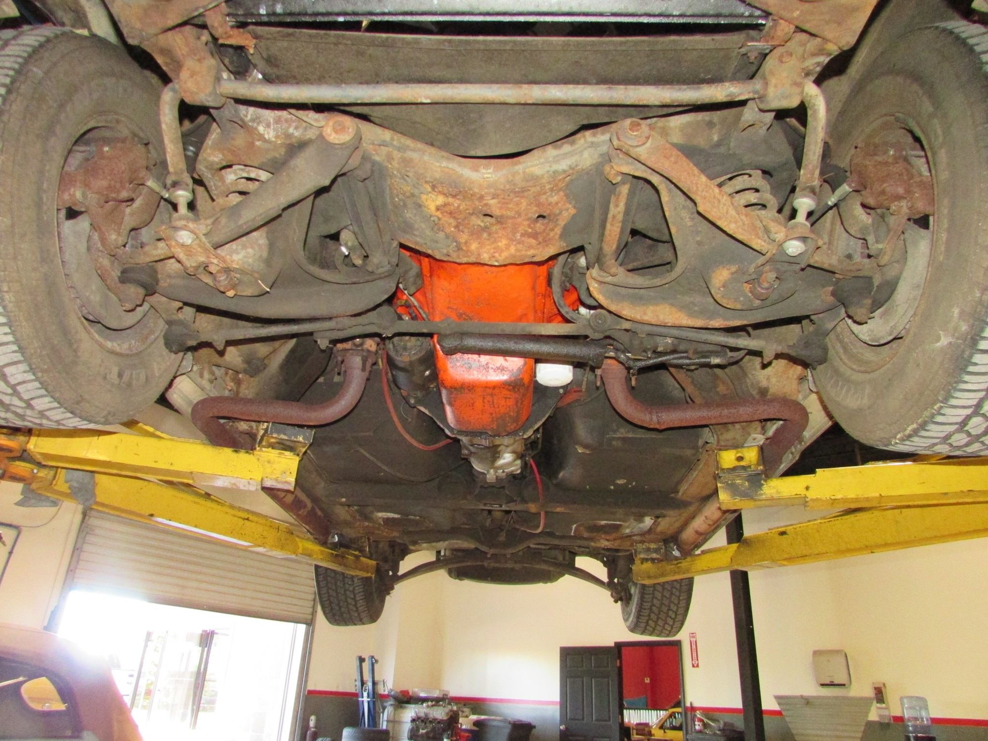

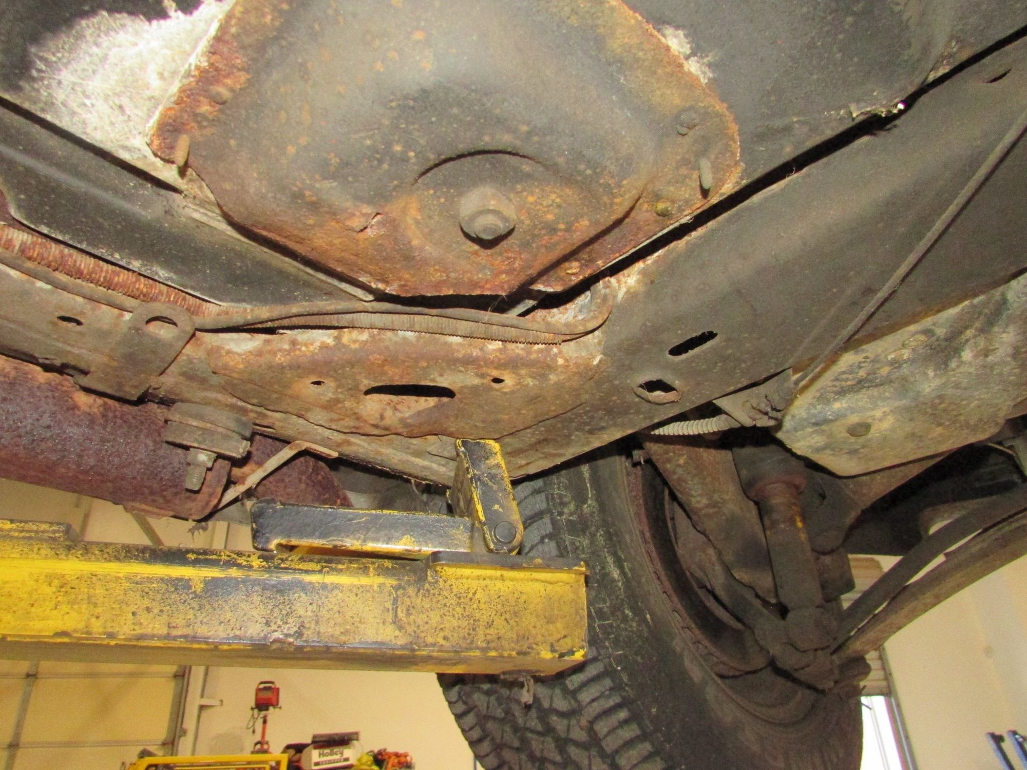

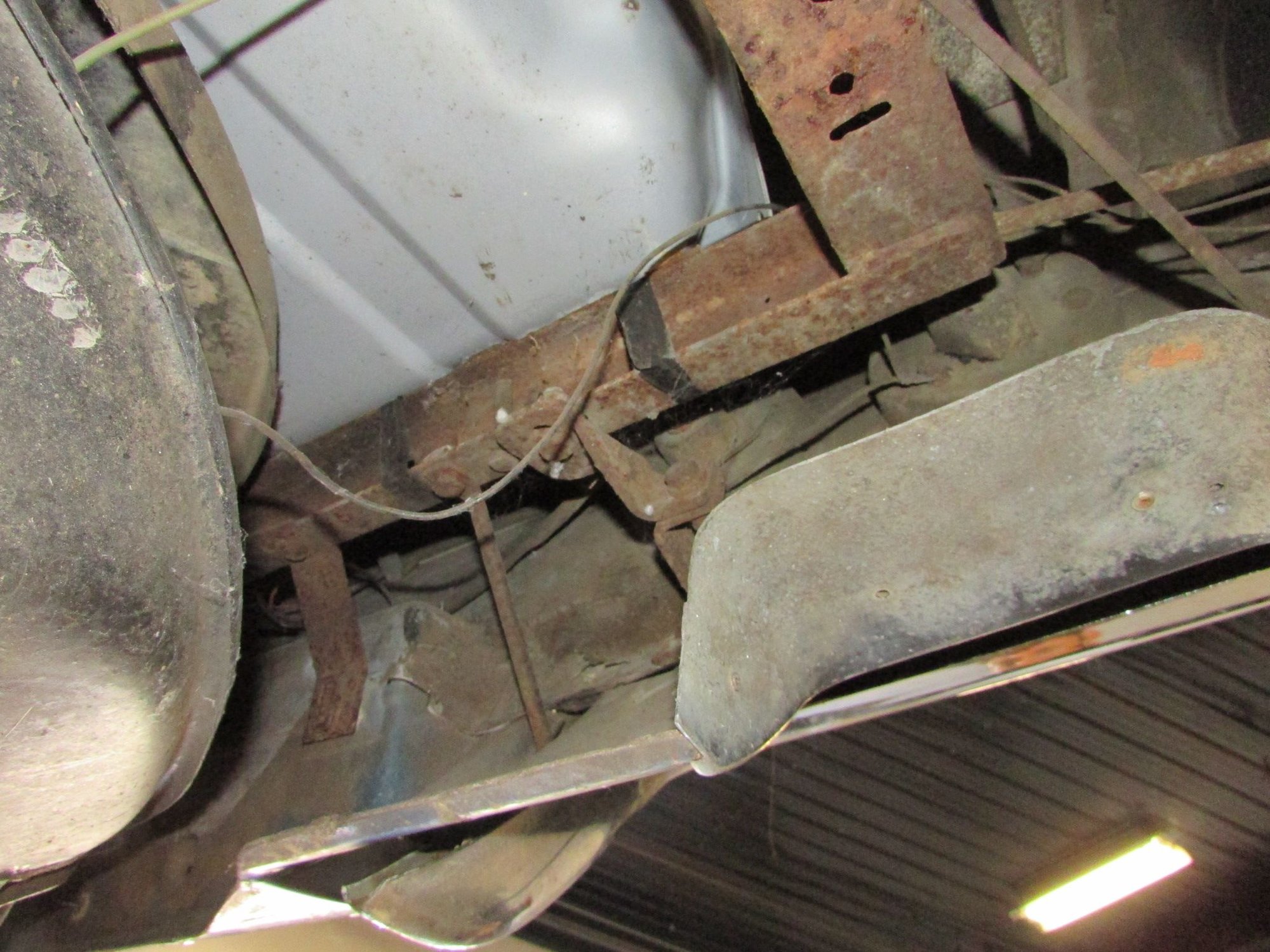

Here are some photos up underneath. There is no rust through except in one spot on the driver's side where the frame turns up to go over the axle (photo #6). The rest is surface rust (or appears to us to be.)

Body needs to come off. 15. Not 25.
