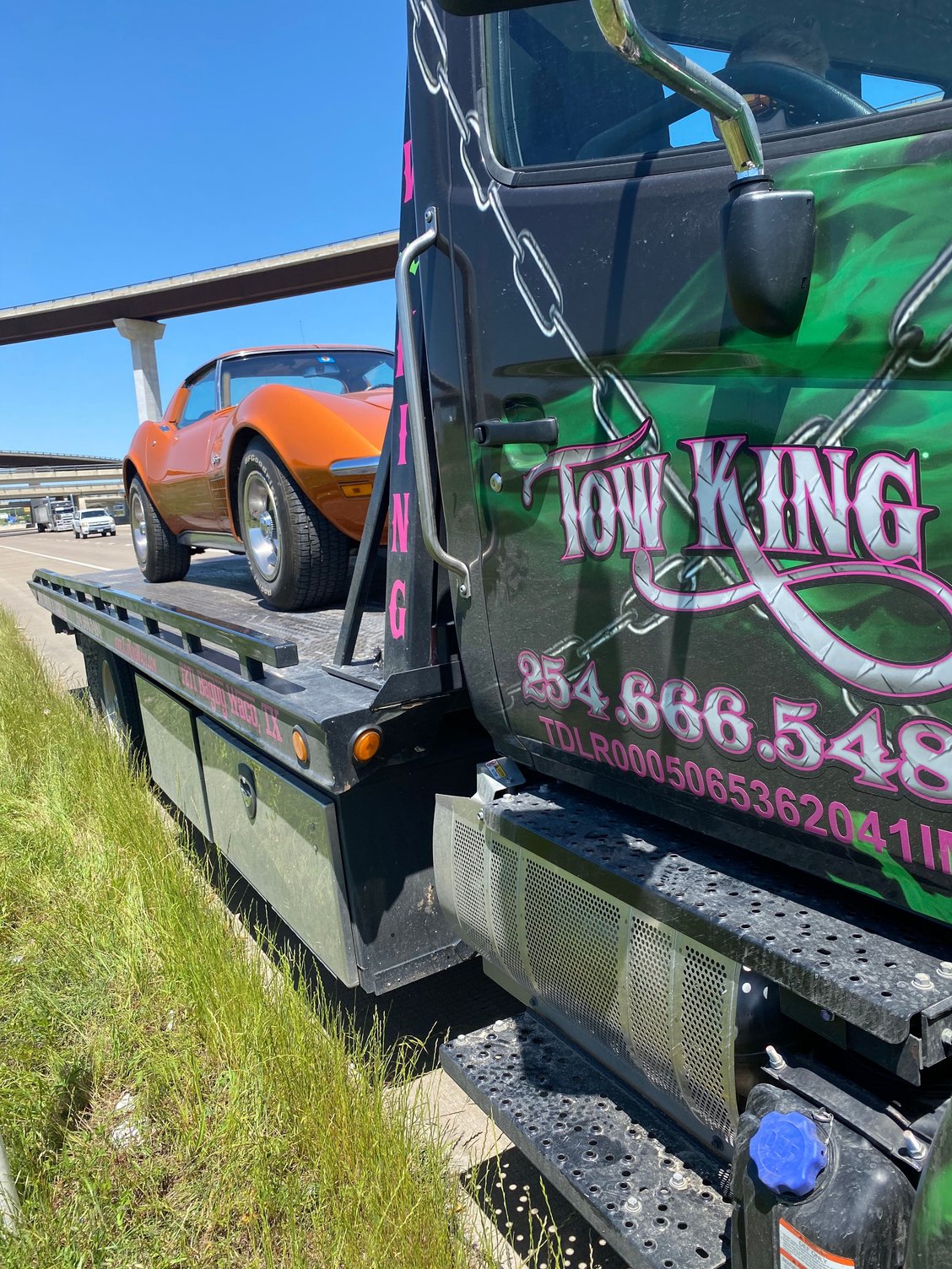

So ... back to the Vette ... zipping down IH 35 in Waco ... making a moderate pass of a big truck ... when ... the 350 quit like the key was shutoff. Fortunately, had enough "opening Vc" on the truck to continue the pass then start moving right to the shoulder.
ugh ... we're 15 miles away! No tools.
I call a tow service ... want to get Victoria off the interstate shoulder ASAP!
As I sit there and wait for the tow truck, nephew riding shotgun ... I recall this story. But I don't have anything to remove the 3/8 nuts on the coil ... so the tow truck arrives. he invites me to sit in the cab. I decline and offer to help ... it's my princess after all. But the driver is aware and careful. He takes me to my nephews' place. Settle up with the driver with much gratitude.
... then run over the the rollaway ... grab a 3/8 ... brake/clutch cleaner ... And Victoria is ALIVE AGAIN!
I about broke down in tears (almost 4 years now since Dad passed). The the decades removed village idiot Claude's suggestion won AGAIN!
So ... y'all ... now on my oil change ... is clean the coil terminals!!!
Carry on!
The Blue Angels over Arlington Texas on 6 May.
Victoria laid down on IH35 in Waco TX ... culprit was discontinuity in the coil terminal connection. a 3/8" wrench would have saved me a 3 figure tow bill.
