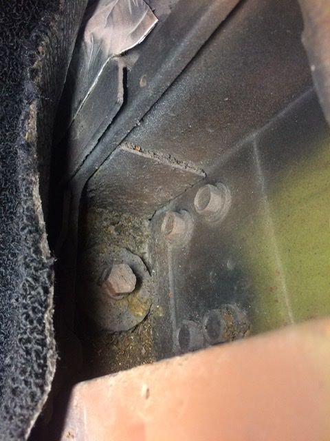

I was told to check behind the driver and passenger kick panels for rust. Here’s a picture of ours behind the passenger kick panel. It checked out pretty clean and solid. Good luck.

If they won't allow you to pull the kick panels you can go up and over them with an inspection camera. Might be able to check under the dash as well....? Take lots of photos and then post them back in this thread, you will get plenty of free advice.
