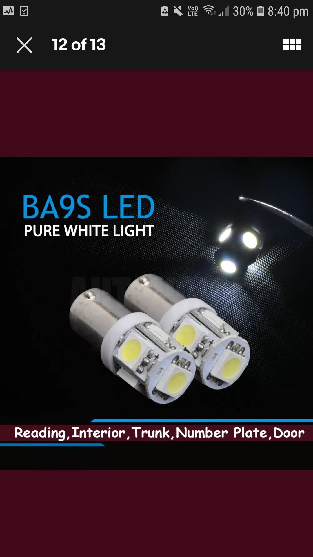

I recently changed my dash lights to LED.
At first I used single LED globes however they were way too dim so I went to a multi LED globe and much better.
Too dim almost unseeable.
Perfect.
