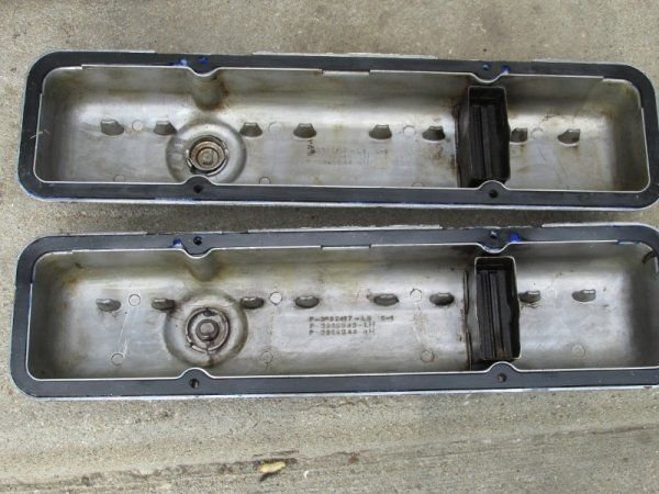

no hp advantage, but possibly a reliability advantage. The L46 covers, which I believe are effectively the same as the L82 covers, had drippers cast in that dropped oil splashed up strait into the rocker.
The insides of the finned covers on my 73 L82 look exactly the same as Dynra's.

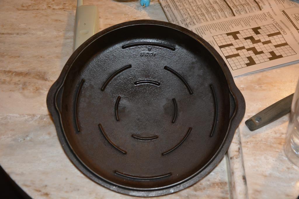

While condensation isn't involved I can't help but to compare to the very similar "high dome
self basters" used on vintage cast iron skillet lids.
