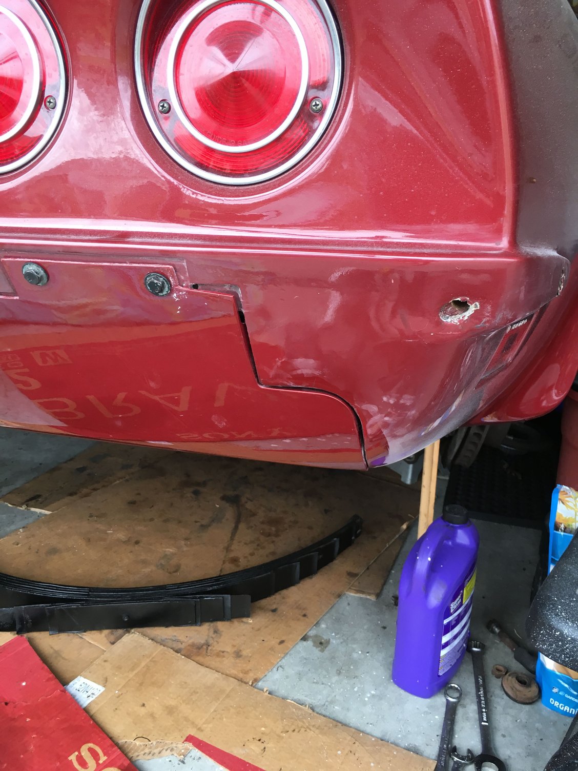

I am wanting to buy a side exhaust but as i’m about to I realized how weird it would look with my current rear bumper which has rectangle cut outs for my rear exhaust.
I tried searching and couldn’t really find anything on if people just leave it for it in with something other than their might be a different panel I can put in?
is that the best option if I want to close off the holes back there? Does it have to be blended into the bumper or does that piece just unbolt?

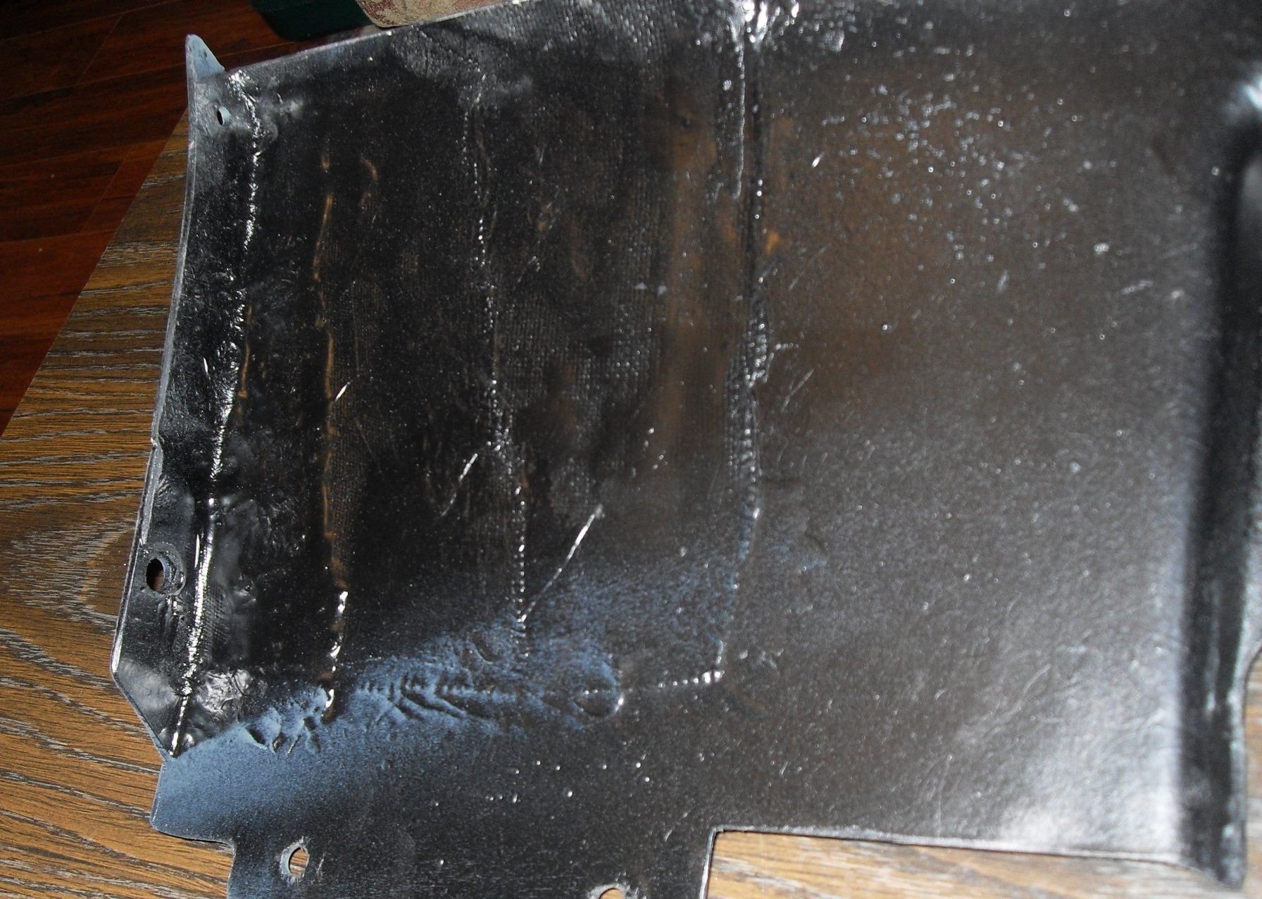

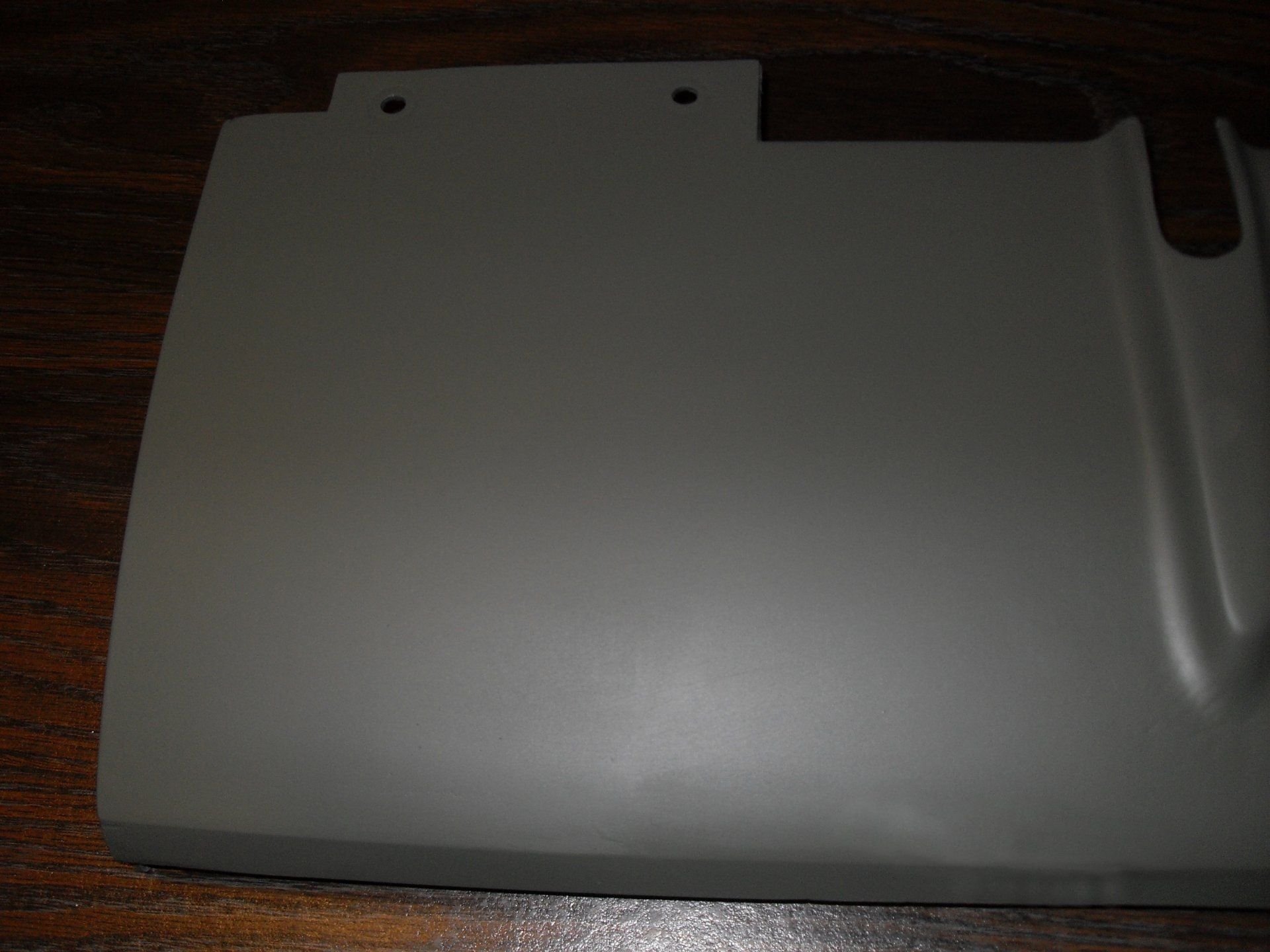

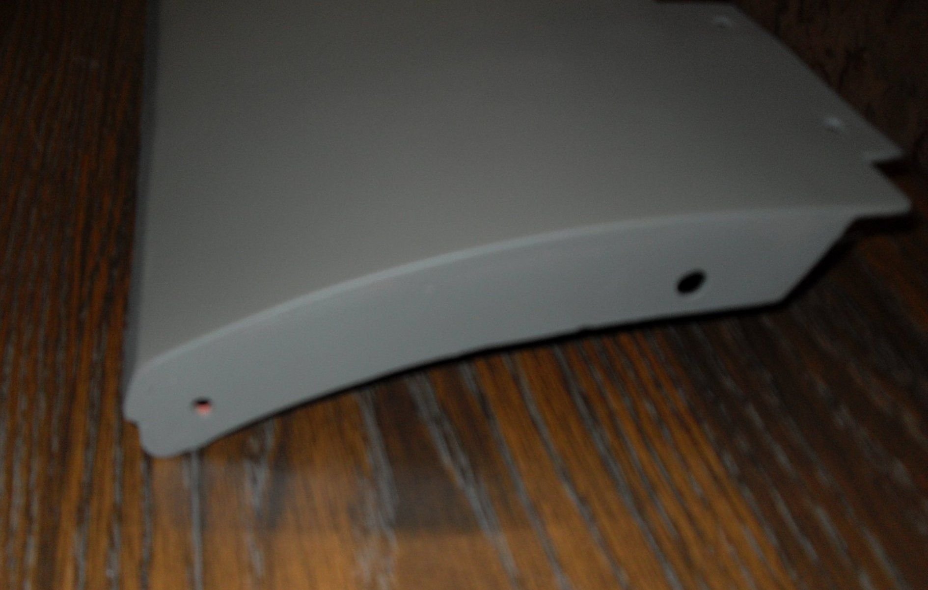

You can us a panel like this painted to your color. If you change your mind down the road it just unbolt and reinstall the original.
https://www.corvettemods.com/C3-Corv...s_p_15697.html

Don't know what year car you have, but is this what you are looking for?
https://www.paragoncorvette.com/p-34...and-layup.aspx

You just need to buy the aftermarket fiberglass panel that covers the holes. When (if) it becomes time for a paint job I'm going to fiberglass mine in permanently..

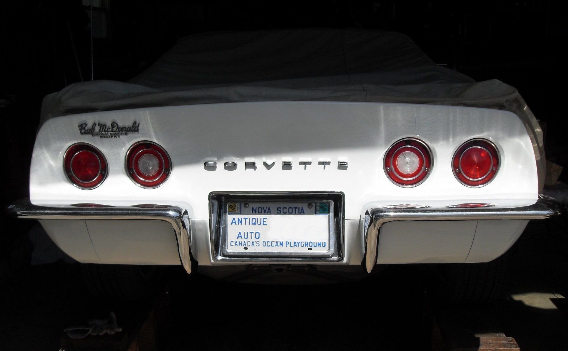

Originally Posted by Adollarwodbnice
Are these what the stock side mounted exhaust cars came with or were the bumpers completely molded closed? I’d like it to look as stock as possible and not have a bunch of odd looking lines if I did go side mount.
I "glassed" mine in to look stock like the factory, adding the attachment points as well, so I could still remove the panel in the future if required. Not a hard job or expensive, just time consuming.

Again original 1969 side pipe Corvette's has special rear quarter panels left and right molded with out the exhaust tip opening. Than a special rear valance panel without exhaust tip opening. No 1968 or 1970 to 73 ever came from the factory with side exhaust. So just installing a rear valance panel will not complete the project as it will only cover half of the opening.
