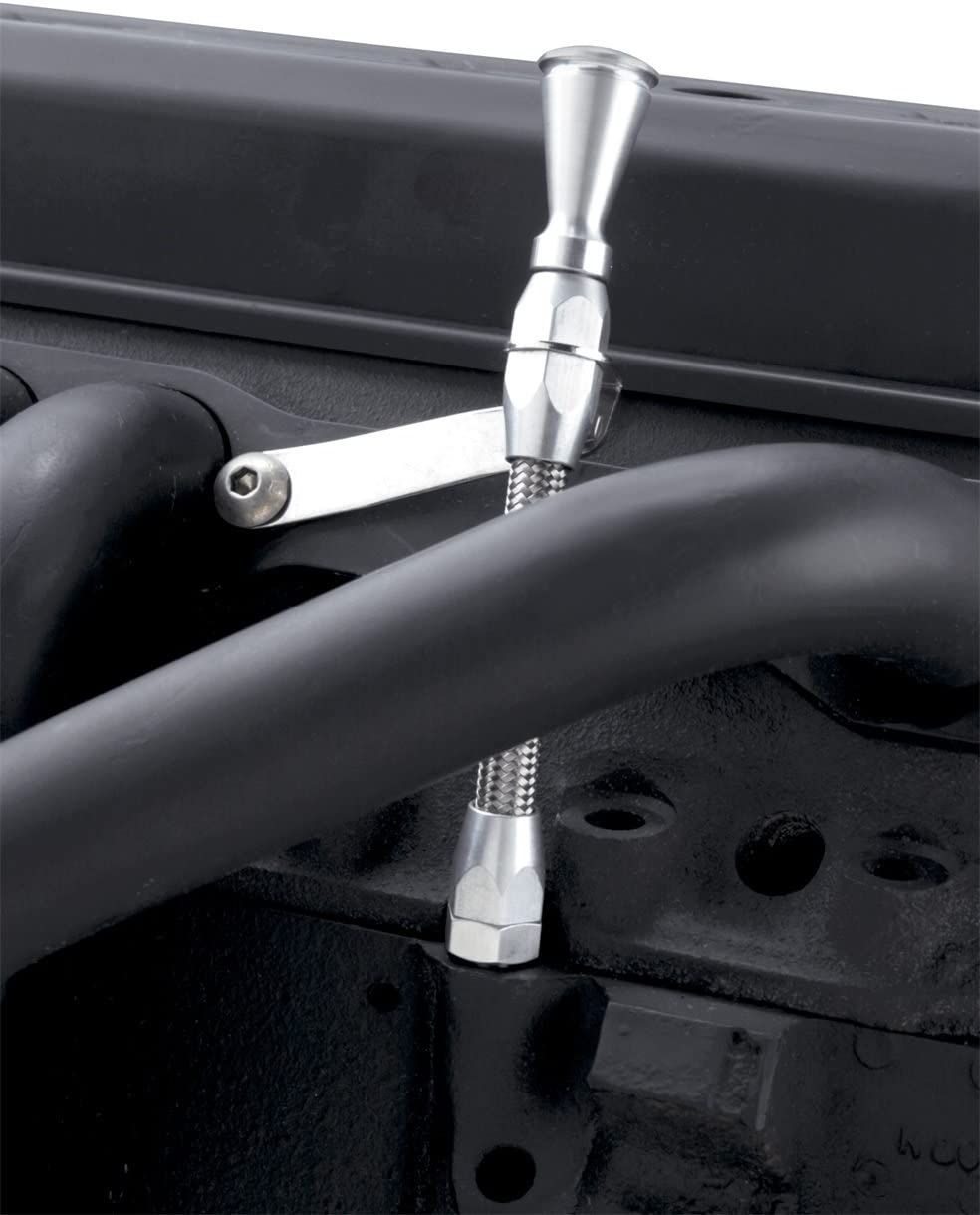

Amazon and Summit both show this photo of that dipstick installed for reference. The two o-rings at the bottom of the new dipstick are supposed to be inserted in the opening in the block.
DC
yes the dipstick fits like that but lokar say in the instructions i need a lower tube as damage can happen to engine internals . i am guessing the inner dipstick is long inside the block with no outer shield
Ok, I get it now. If you can't tell if the lower tube is in place from above, you may have to pull the pan.
