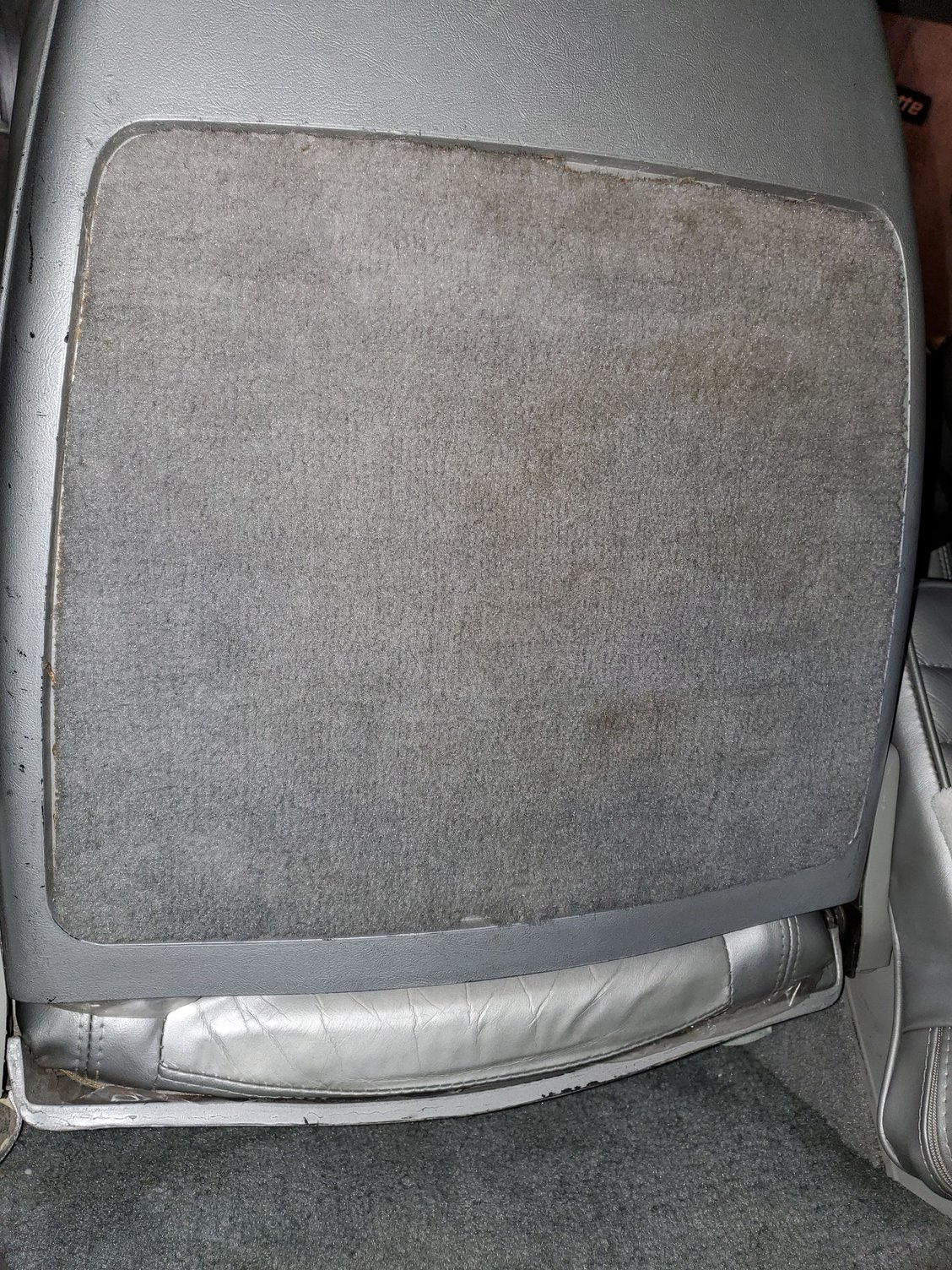

The carpet on the back of the seats looks pretty bush without trim of some kind. Has anyone put trim or some kind of border to make it a cleaner look? Pictures??

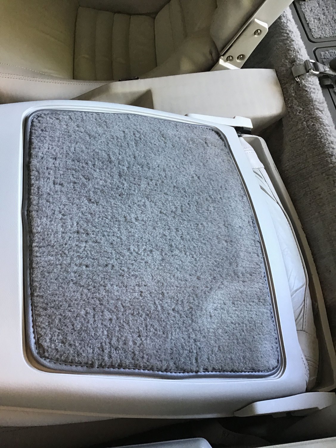

Whats bounded?
original 79 oyster that is actually 78 color
looks bound edged?

Those are the bound edges.
In my black on oyster 79 (VIN in the 40Ks), I had the later 79 oyster. Though the carpet has been refreshed once or twice, the original door panels have the darker gray-ish carpet on them. I've since replaced it all with the 78 brown-ish carpet, including door panels.
I wonder if this happened to your car in reverse. The panel on the back of the seat, (and also on the on the cargo doors) looks like the later 79 carpet, but the rest of the carpet looks like the 78. It could just be the lighting, though. That might explain the bound carpet, too.

very possible..the seats and plastic all 78 color not 79
ya the loghting makes it look different but are the same..the lighter 78
carpet? No clue..its original
